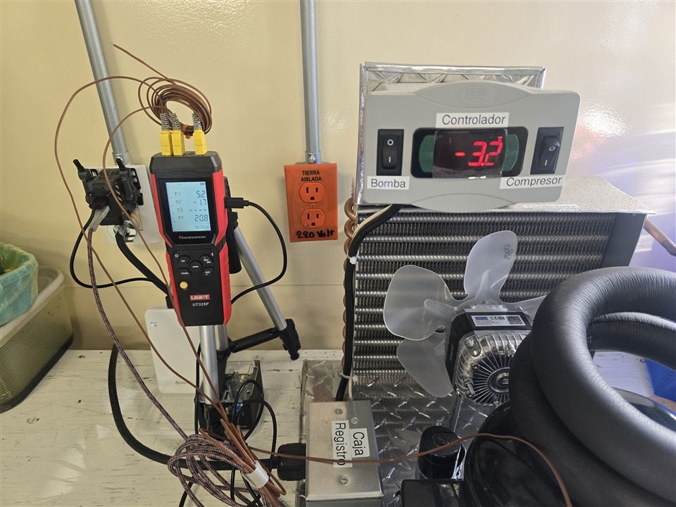

Challenges
The UT325F Protocol
The UNI-T device has a Universal Serial Bus (USB) converter to a Universal Asynchronous Receiver Transmitter (UART). This is based on the known CHXXX series converter. This was a challenge since there is no information about how the temperature data is transmitted, despite the device having a Bluetooth App for android and Microsoft Windows application for data recording. Furthermore, the data observed during transmission with default configuration to the user interface has the following composition
The image control variable has the value of 0xAA and acts as start frame flag,image are unknown meaning variables at the development moment, the image are the Temperature variables in little endian format for IEEE 754 float representation,image represents which probes are connected from bytes 1 to 4, and image is a 16-bit check sum code with big-endian encoding. Once the protocol is identified, the connection to the Python CLI is sufficient to decode the 56-byte frame using the code below,

The protocol decoding were sufficient despite the unknow variables, but a new challenge arose since the Arduino UNO Q Linux image has no the CH340 converter driver.
The CHxxx series driver
Despite the Linux image has no native driver for the USB-UART CH340 device, it is possible to compile and install the drivers for the used target. The WCHSoftGroup share the source code to compile and install the driver in a platform which the driver is unavailable. You only need to download the GitHub repository, change directory to ./driver folder and execute the commands

Data access
In order to solve the limited access of Arduino App Lab to the port, a background perspective is used. There is a background Python script that takes the data from the serial port and shares it using JavaScript Object Notation (JSON) format by a socket using a REmote DIctionary Server (Redis) service. Redis storage data on memory with a NoSQL philosophy, it is used to quick response data cache for temperature sharing in the network. It is required to install and start a Redis server with the commands below to implement a Redis node.
sudo apt-get install redis-server
sudo systemctl start redis-server

Setup
The physical system consists of a compressor system, but this is instrumented and controlled by the Arduino UNO Q. The whole system has a UT325F Thermometer as a verification display since the data is transmitted to the Linux interface by the serial port. There are three probes connected, one for the glycol solution that is in the interchange chamber, another probe in the water inside the container immersed in the glycol and one not processed probe more for the ambient temperature. There is an additional free channel for future purposes. The processed probes consist of the use of thermowell with thermal paste to improve thermal transfer, this isolates the sensor terminal from harsh environments that will be used like acid electrolytes.
For power conditioning, the microcontroller interface activates an AC solid state relay (SSR) for fan and compressor loads to AC line. This allows remote control and monitoring using a WiFi connection. Adding a wireless connection to the platform brings an additional secure layer since the cooling system, which could generate Hydrogen and other gases, or had a considerable temperature gap to damage the container inside, is isolated from the operator.
Using the WebUI brick it is possible to access the data available in the Arduino by network and take control of the pinout according to the implemented code. For the recent testing, I used a pattern controller to check the action control and verify the rules to implement. The project is described below,

This project is based on the Linux Blink example project. All those components required on the desktop version were added to the embedded version with compatibility and new compiling drivers for the additional hardware.
{gallery}Setup
Instrumentation
Data access
Figure 1. System setup in operation
Results
After the setup is operative, there was a initial test using an arbitrary temperature. The objetive is maintain a constant temperature for the container inside the glycol. The glycol thermal chraracteristics guarantee a good thermal transfer between the container and the interchange chamber. Despite the thermal variations as a consequence of the chamber energy losses, the water in the container must be constant as possible.
behavior
Figure 2. Temperature control operation
The system has an inherent thermal inertia, despite the objective temperature in the glycol was -2 °C, with an compressor activation on -0.5 °C, the system overcome this limits according this feature. But this test brough interesting behavior according the figure above. The orange curve represents the glycol interchange chamber; the blue one shows the temperature in the water for the container inside the glycol. The compressor operation maintains a glycol temperature oscillation about 8 °C while the water maintains an oscillation of 0.5°C. These variations occur since the actual controller is of ON/OFF controller type. Despite the oscillation is huge in glycol, the container has a small one, which is our interest in the chemical cell. For the future, we must quantify chamber mass lost using the humidity measures and add new instruments and actuators like pumps to compensate matter losses or electrolyte features such as pH.
