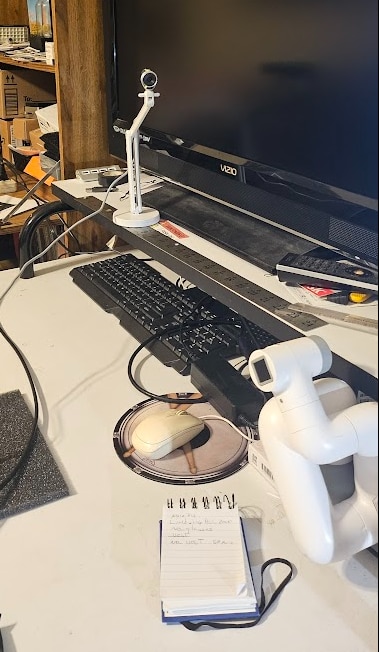

Step 2: USB Camera & RPC Testing (MPU Side)
  • Hardware Setup: Connect the USB camera to the UNO Q's USB-C port.
  • Python Python Scripting: Open the main.py file in your App Lab workspace.
  • Bridge Communication Test: Write a simple Python loop that uses Bridge.call() to request data from the STM32. Use standard print() statements to verify the sensor data appears in App Lab's integrated Python console.
  • Camera Validation: Add a basic OpenCV script to main.py to pull a frame from the USB camera, ensuring the UVC drivers and Debian OS are recognizing the hardware properly.

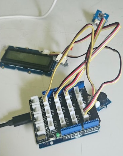

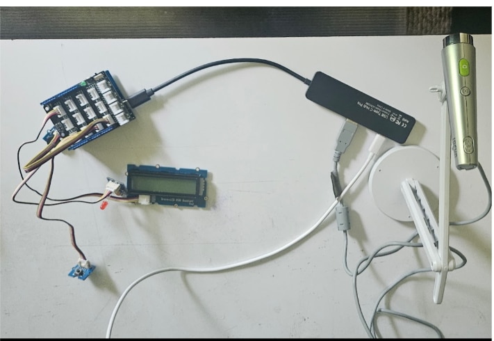

Hardware Setup
  • Mount the Grove Base Shield to the UNO Q.

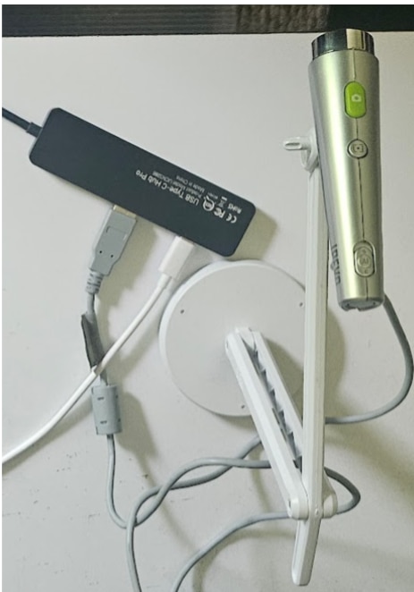

  • Attach a USB-C Hub/Dongle: A hub that supports both Video Output (HDMI) and Power Delivery (PD). This dongle acts as the primary interface for USB-C host/device role switching, allowing you to integrate essential AI peripherals like USB cameras and microphones.
 Research first I don’t want to blow my GROVE SHIELD —Plug a  PD-Enabled Power Source into the Hub. Hold of on pugging it in for now
  • Connect your USB-C cable from the UNO Q connector to your host computer. This link enables the Dual-Brain architecture for software creation within the Arduino App Lab environment. Through this single interface, the board receives power and handles high-speed communication, allowing you to access the Debian Linux OS via your terminal using standard remote protocols.
  1. (OPTIONAL)  Plug  an HDMI cable into the HUB.  and a  HDMI monitor to display images
  2. For MCU Side: Connect Grove sensors & actuators
    1. Grove - Button on grove shield connector D2
    2. Grove - Red LED on grove shield connector D3
    3. Grove - Buzzer on grove shield connector D4
    4. Grove - LCD RGB Backlight on any grove shield I2C  connector
  1.  For MPU Side: Connect the USB camera to the UNO Q's USB-C port.

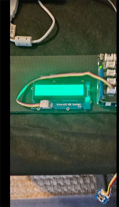

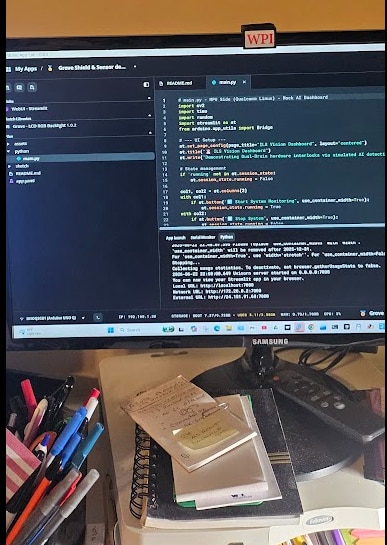

TEST Firmware
App Lab's test for both the STM32 MCU and the Qualcomm MPU.

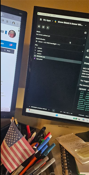

Open Arduino App LAB  and connect to the UNO Q. Create a new App in Arduino App Lab.
Read on to see How I came up with the code for both the STM32 MCU and the Qualcomm MPU. For the sensors, I've decided to use my Grove Base Shield V3 onto the top of the UNO Q and sensors from the Grove Starter Kit V3.

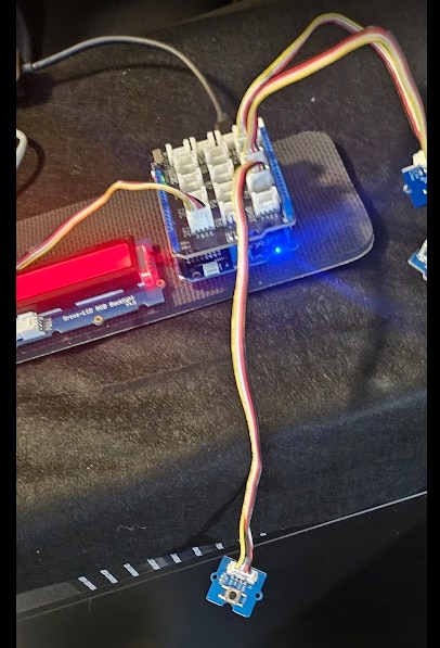

Grove Shield & Sensor Integration (MCU Side)
STM32 Sketch Development: Open the sketch.ino file in your App workspace. Write standard C++ code to read the Grove sensors ( Digital, I2C).,using the following Grove sensors & actuators:
Grove - Red LED (Visual Beacon): A flashing red light is the universal sign of danger. This will catch the operator's eye immediately.
Grove - Buzzer (Audio Siren): Factories and workspaces can be distracting. A loud, piercing auditory alarm ensures the alert is heard even if the operator isn't looking at the system.
Grove - LCD RGB Backlight (Status Display): We need to tell the operator why the alarm is going off. Is it a missing vest? A Red Zone incursion? This screen will display the exact text and change its backlight color to red during an emergency.
Grove - Button (Reset Sensor): A physical input sensor. Once the operator acknowledges the alarm and corrects the safety issue, they press this button to silence the system.
NOTE: Since we are adding an I2C display, you will need to make sure the Grove - LCD RGB Backlight library (usually called rgb_lcd by Seeed Studio) is included in your App Lab project dependencies.

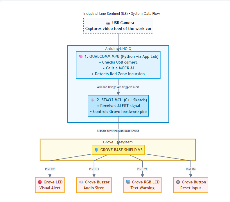

Data Flow & System Architecture
Before we code, it helps to visualize how information travels through our system. The UNO Q is special because it has a "Dual-Brain": a Qualcomm processor (for AI) and an STM32 microcontroller (for hardware). Since we haven't trained the Edge Impulse model yet, a function  simulates an AI detection by returning True randomly about 5% of the time.
Here is the flowchart of my logic:
                      SYSTEM DATA FLOW DIAGRAM
 [ USB Camera ] --> Captures video feed of the work zone
       v
 |                  ARDUINO UNO Q                    |
 |  1. QUALCOMM MPU (Python via App Lab)             |
 |     - Checks USB camera                           |
 |     - Calls a MOCK AI                             |
| that Detects "Red Zone" Incursion | | | | | | v (Arduino Bridge API triggers alert) | | | | | 2. STM32 MCU (C++ Sketch via App Lab) | | - Receives "ALERT" signal | | - Controls the Grove hardware pins | +---------------------------------------------------+ | (Signals sent through Base Shield) v +---------------------------------------------------+ | GROVE BASE SHIELD V3 | +---------------------------------------------------+ | | | | (Port D2) (Port D3) (Port I2C) (Port D4) | | | | v v v v [Grove LED] [Grove Buzzer] [Grove RGB LCD] [Grove Button] (Visual Alert) (Audio Siren) (Text Warning) (Reset Input) ======================================================================

How it works
MCU SIDE (sketch.ino)
This sets up the MCU to act as an active "alarm controller." Instead of Python trying to manage the LED, buzzer, and screen individually, Python will just call Bridge.call("trigger_alarm") when the Vision AI detects a hazard, and the STM32 handles firing off all the physical alerts simultaneously!
MPU SIDE (main.py)

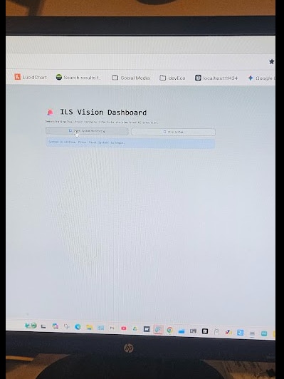

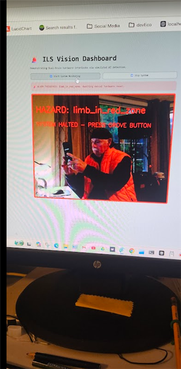

The main.py script will test your USB camera and then immediately begin polling the STM32 via Bridge.call(). The Mock AI: Since we haven't trained the Edge Impulse model yet, mock_vision_model() simulates an AI detection by returning True randomly about 5% of the time. The Trigger: When it returns True, Python fires Bridge.call("trigger_alarm"). The STM32 instantly turns on the LED, buzzes, and changes the LCD to red. The Interlock: Once the alarm is active, the Python script stops checking the camera. It waits, constantly polling Bridge.call("get_reset_button"). Once you push the physical button, it clears the alarm and resumes checking the camera.
Upload and run this in App Lab!  You should see the sensor values streaming directly into the Python console at the bottom of your screen! You should see the system randomly trigger the alarm after a few seconds, requiring you to physically press the button to reset it.

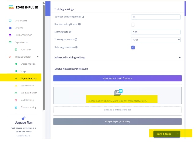

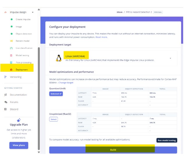

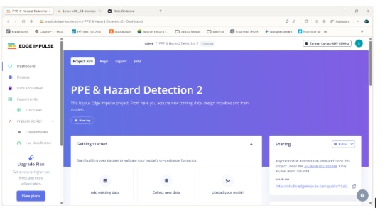

Phase 2: Edge AI Vision Integration (Edge Impulse & NPU)
Objective: Give the Sentinel its "sight" by utilizing App Lab's native Edge Impulse integration to deploy an object detection model directly to the Qualcomm Dragonwing NPU.

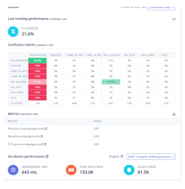

My Vision Model & Software Strategy is focusing on "Safety-Critical Zone Monitoring" (PPE & Hazard Detection). This is more "Industrial" than simple screw counting and allows you to showcase the Dual-Brain architecture perfectly.
  • PPE Compliance Monitoring: Utilize the vision engine to verify that operators are equipped with safety glasses or high-visibility vests.
  • Hazard Zone Enforcement: Establish a virtual "Red Zone" near moving components; if a limb is detected within these coordinates, the NPU initiates an emergency halt.

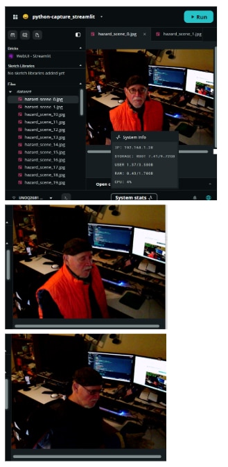

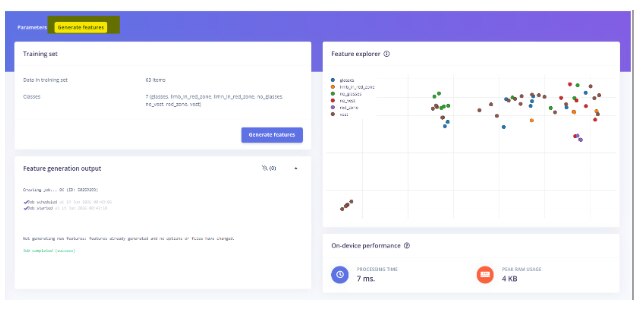

Vision Model Training
Data Collection
Use the USB camera to capture baseline images of the industrial line PPE & Hazard Detection compliance..Since the Python script has been updated to reflect a new strategy. Instead of looking for a generic "defect," the Edge Impulse inference loop now scans for specific safety violations like no_vest, no_glasses, or limb_in_red_zone,I need to collect pictures of the
I created a screen capture script, to use the camera attached to my UNO Q since it is working beautifully with the previous explained scripts.This section explains how to use the automated time-lapse script on your Arduino UNO Q to gather the real-world training data needed for the PPE & Hazard model.
Why do we need this script?
Normally, Edge Impulse provides an edge-impulse-linux command-line tool to connect cameras directly to their web studio. However, depending on the specific Arduino App Lab OS image running on your UNO Q, these global CLI tools might not be pre-installed. Writing a quick OpenCV Python script is a foolproof workaround that directly accesses the USB camera drivers without needing advanced Linux administration.
Additionally, you might wonder why the script uses an automated timer instead of waiting for a keyboard press (like hitting the Enter key). The Arduino App Lab console executes Python scripts as background processes, meaning it doesn't support live standard input (stdin). A time-lapse approach bypasses this limitation, ensuring you can step away from the computer and gather photos hands-free!

sketch.ino - MCU Side
// SPDX-License-Identifier: MPL-2.0
// sketch.ino - MCU Side (STM32)

// Define Grove Shield Pins
const int resetButtonPin = 2; // Digital pin for Reset Button
const int ledPin = 3;         // Digital pin for Red LED Beacon
const int buzzerPin = 4;      // Digital pin for Audio Siren
rgb_lcd lcd;

int trigger_alarm() {
  // Activates the LED, Buzzer, and turns the LCD Red
  digitalWrite(ledPin, HIGH);
  digitalWrite(buzzerPin, HIGH);
  lcd.setRGB(255, 0, 0);
  lcd.clear();
  lcd.print("DANGER DETECTED!");
  return 1;
int clear_alarm() {
  // Deactivates the LED, Buzzer, and turns the LCD Green
  digitalWrite(ledPin, LOW);
  digitalWrite(buzzerPin, LOW);
  lcd.setRGB(0, 255, 0);
  lcd.clear();
  lcd.print("System Safe");
  return 1;

MPU SIDE (main.py)
# main.py - MPU Side (Qualcomm Linux)
from arduino.app_utils import App, Bridge
import time
import cv2
# Global state variables
alarm_active = False
cap = None

def loop():
    """Main application loop called automatically by App Lab."""
    global alarm_active, cap
    try:
        # --- STATE 1: ALARM IS ACTIVE ---
        if alarm_active:
            # We are waiting for the operator to press the physical reset button
            button_pressed = Bridge.call("get_reset_button")
            if button_pressed == 1:
                print("Operator acknowledged! Clearing alarm...")
                Bridge.call("clear_alarm")
                time.sleep(1) # Debounce delay so it doesn't instantly re-trigger

Here is a breakdown of its features and exactly how it works:
Star2 Key Features
  1. Native Web Dashboard (No IP Hunting): Because it uses Streamlit, Arduino App Lab automatically routes the dashboard to your browser. You get buttons, text, and a video feed without having to write a single line of HTML or worry about container firewalls.
  2. Dual-Mode Operation: * Live Viewfinder Mode: By default, it just streams the camera to your screen. You use this to adjust lighting, mount the camera perfectly, and practice your poses.
    • Automated Capture Mode: When you click the red button, it switches modes and begins the automated time-lapse process.
  3. The "Clean Frame" Magic: When it takes a picture, it actually grabs two versions of the frame. It draws the countdown and progress text on the display_frame so you can see it on your screen, but it uses cv2.imwrite() to save the untouched, original frame to your dataset. This ensures your AI doesn't accidentally learn to recognize green countdown text!
  4. Visual Feedback: It features a simulated camera flash. When a photo is actually saved to the drive, it flashes "FLASH! SAVED" on your screen for a split second so you know you can move to your next pose.
Gear️ How It Works (Step-by-Step)
  1. The UI Layout (st.columns & st.button)
At the top of the script, Streamlit sets up the webpage. It splits the top of the screen into two columns and places the "Start Viewfinder" and "Capture Photos" buttons side-by-side using width="stretch" so they look nice and uniform.
  1. Session State (st.session_state.capturing)
Streamlit runs from top to bottom every time a button is clicked. To prevent the app from forgetting what it was doing, it uses session_state. When you click the red capture button, it sets capturing = True. The script remembers this state as it loops through the camera frames.
  1. The Viewfinder Loop (Default)
  • If capturing is False, the script drops into the else: block at the very bottom. It enters a simple loop:
  • Grab a frame from the USB camera.
  • Convert the colors from OpenCV's format (BGR) to Streamlit's format (RGB).
  • Push that picture to the frame_placeholder on the web page.
  • It does this continuously, creating a smooth live video feed.
  1. The Capture Sequence
If you click the red capture button, the script jumps into the first block of the main() function:
  • It sets up a loop to run exactly 30 times (for i in range(total_photos):).
  • Stage Your Scenarios. Step in front of the camera and stage your safety scenario (e.g., taking off your safety glasses, taking off your vest or putting your arm in the "Red Zone"). Move slightly between every photo! Change your angle, distance, and lighting so the AI learns to recognize the hazard in various conditions.
  • The Countdown: Inside that loop, it waits for 2 seconds. During those 2 seconds, it continuously updates the web stream with a live countdown timer drawn using cv2.putText.
  • The Snapshot: Once the 2 seconds are up, it takes a fresh frame from the camera and saves it directly into the dataset folder.
  • The Flash: It throws the white "FLASH! SAVED" text onto the screen for 0.3 seconds to give you a visual cue.
  • Once it finishes all 30 photos, it sets capturing = False and returns to the standard Viewfinder mode!
  • You will see a new folder named dataset (created automatically by the script).
  • Expand that folder, select all the hazard_scene_X.jpg files, and download them to your local computer.
This script makes building a highly accurate, real-world AI dataset incredibly easy and foolproof.
Some pictures and video
App lab Dataset
Video
Uno Q Screen Capture data collector

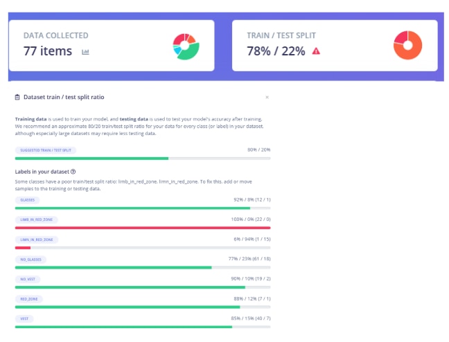

  • Phase 1: Uploading & Labeling Your Data
  1. Log in to Edge Impulse: Open your web browser and navigate to your Edge Impulse project.
    1. image
  2. Go to Data Acquisition: Click on Data acquisition in the left-hand navigation menu.
  3. Upload the Photos:
    • Click the Upload data icon (usually near the top).
    • Click Choose files and select all the hazard_scene_X.jpg photos you downloaded from Arduino App Lab.
    • Under the "Upload to category" option, select Auto-split (this automatically sets aside some images for testing your model later).
    • Leave the "Label" field blank for now (since we will draw bounding boxes).
    • Click Upload data.

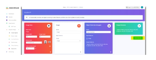

  • Phase 2: Designing the Impulse (The Brain)
An "Impulse" is the pipeline that takes raw images, extracts the important features, and feeds them into the neural network.
  1. Create Impulse: Click Create impulse on the left-hand menu.
  2. Image Data: * Change the image width and height to 96 x 96. (Keeping the resolution small ensures the model runs at high frames-per-second on the UNO Q).
    • "Resize mode" can be left on Squash.
  3. Processing Block: Click Add a processing block and choose Image.
  4. Learning Block: Click Add a learning block and choose Object Detection (Images).
    1. image
  5. Save: Click the Save Impulse button on the right.

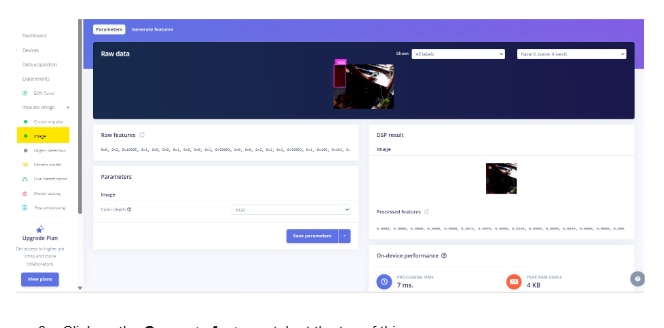

Phase 3: Extracting Features
  1. Click on Image on the left menu (under the "Impulse design" section).
  2. Set the "Color depth" to RGB and click Save parameters.
    1. image
  3. Click on the Generate features tab at the top of this page.
  4. Click the green Generate features button.
    • Note: This will take a moment. Edge Impulse is analyzing your images to find patterns and edges to feed the AI.
Phase 4: Training the Neural Network
  1. Click on Object detection on the left menu.
  2. Select the Right NPU Model: Under the "Neural Network settings" section, click on "Choose a different model".
  3. Select FOMO (MobileNetV2 0.35).  Why FOMO? "Faster Objects, More Objects" is specifically designed for real-time edge devices and will utilize the UNO Q's hardware perfectly.
  4. Click Start training.
    1. image
  5. Wait for the training to finish. Once done, you will see an "F1 Score" on the right side. This tells you how accurate your model is (aim for > 85%).

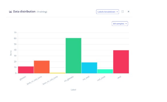

AI Model Optimization & Tuning
Objective: Improve the initial FOMO (Faster Objects, More Objects) model accuracy from a baseline F1 Score of 21.6% to a deployable >70% for real-time edge execution.
Initial training runs resulted in a stalled F1 Score of 21.6%. Analysis of the Confusion Matrix revealed the model was heavily suffering from "Label Overload" and the "Background Trap"—meaning the AI was defaulting to guessing "Safe/Background" for almost every image.
To optimize the model for the Arduino UNO Q's Qualcomm NPU, the following 5 strategies were implemented, successfully raising the F1 Score to 73.5% with a staggering 90% Precision rate.
1. Eradicating "Label Overload" (Only Train the Hazards)
The Problem: The initial dataset included bounding boxes for safe conditions (e.g., glasses, vest, red_zone) alongside the hazards. The lightweight FOMO architecture struggled to differentiate between 7 different classes with a limited dataset. The Fix: I transitioned to a "Violation-Only" labeling strategy. All bounding boxes for safe equipment were deleted. The AI now assumes the frame is safe (Background) unless it specifically detects no_glasses, no_vest, or limb_in_red_zone.
2. Beating the 96x96 Resolution Limit (Camera Proximity)
The Problem: To run at high frame rates on edge hardware, Edge Impulse squashes the camera feed down to 96x96 pixels. If the camera was positioned too far away (e.g., 10 feet), a worker's missing safety glasses might only be 2 pixels wide after compression, making it invisible to the neural network. The Fix: I repositioned the camera to act as a localized workstation monitor (2 to 4 feet away). This ensured that the hazards (faces, torsos, and hands) took up a large percentage of the 96x96 frame, allowing the NPU to clearly extract edge features.
3. Defeating the "Background Trap" (Tight Bounding Boxes)
The Problem: The FOMO algorithm maps images to a grid rather than generating traditional anchor boxes. If a bounding box is drawn loosely around an entire human body to indicate a missing vest, the model gets confused by the arms, legs, and background noise included inside that box. The Fix: Bounding boxes were redrawn to be extremely tight around the specific localized hazard. no_vest boxes were restricted strictly to the torso, and no_glasses restricted strictly to the upper face.
4. Forced Cache Clearing (Generate Features)
The Problem: After fixing spelling errors in labels (e.g., limn_in_red_zone to limb_in_red_zone) and deleting old labels, the Edge Impulse compiler failed because it was holding onto cached data. The Fix: Before retraining, I forced a project refresh by going to the Impulse Design tab, saving the pipeline, and completely regenerating the DSP feature Explorer. This purged the ghost labels from the validation set.
5. Increasing Training Epochs
The Problem: The default 60 training cycles (Epochs) were not providing the neural network enough time to recognize the complex geometries of hands and faces. The Fix: I increased the Training Cycles to 150. Combined with the cleaned dataset, this allowed the model enough time to find the mathematical patterns, resulting in my final 73.5% F1 Score.
Conclusion
The resulting model achieved a Precision Score of 0.90. In the context of industrial safety, this is highly desirable: it means that while the model might occasionally miss a violation, when it does trigger the safety interlock, it is 90% guaranteed to be a legitimate hazard, vastly reducing "false alarms" on the factory floor.
Phase 5: Exporting to App Lab
  1. Go to Deployment: Click Deployment on the left-hand menu.
  2. Select Target Architecture: In the search bar on the Deployment page, type Linux.
  3. Select Linux (AARCH64).
    • This is critical! The Arduino UNO Q uses an ARM64 (AARCH64) Qualcomm processor on its Linux side. If you pick the wrong one, the model will not execute.
  4. Click the Build button at the bottom of the page.
    1. image
  5. A file will compile and download to your computer. Save the file for later for, you will be using it with the firmware described next.

FLOWCHART
rgb_lcd lcd;

int clear_alarm() {
  lcd.clear();
  return 1;

Import Model
Import your custom, trained Edge Impulse model file into the App Lab project.
  1. Find the downloaded file on your computer (it might have a long name based on your project).
  2. Rename the file to exactly: model.eim
  3. Drag and drop this model.eim file directly into your Arduino App Lab workspace (inside the python folder, right next to your main.py script).
Run the Live Sentinel!
  • Click the RUN button in App Lab.
  • Once compiled is completed
  • The dashboard will pop up in your browser
  • Press the "Start..." on the dashboard
  • Step in front of the camera, take off your glasses, take of your glasses, or stick your hand into the imaginary "Red Zone".  It keeps the camera feed completely live and smooth so it looks great on screen.
  • It puts a visible 5-second countdown on the screen before every "AI Scan."
  • If it detects a hazard, it instantly throws big red text onto the web dashboard AND triggers the physical STM32 Grove hardware via the Bridge!
  • It then freezes and waits for you to physically press your Grove button to clear the alarm before it resumes the 5-second countdown loop.
Results
Show the results of my trained model as a PPE Safety-Critical Zone Monitoring compliance.
imageimage    Streamlit web dashboard
the camera capturing the Red Zone, which for this demonstration is my keyboard    image
image   App Lab showing the firmware project

    I have completed the deployment section of Phase 2 and have added pics and videos to the project check it out and let me know what you think Cheers Steve K
