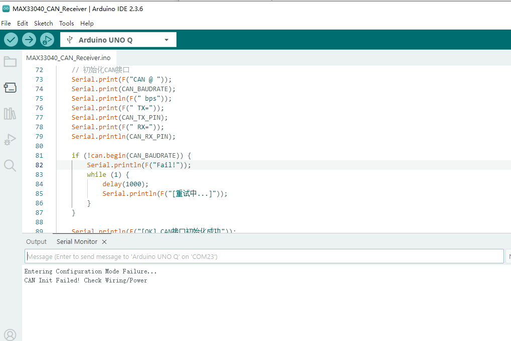

1.1 Low-cost distributed IMU motion sensing over industrial CAN bus, edge data forwarding to PC-side LabVIEW visualization & AI monitoring.
The schedule is delayed totally since I misuse Arduino CAN library which support MCP2501 over SPI. I have to rebuild sustomized CAN library by GPIO simulation, although the Arduino Uno Q support CAN natively, but the port is not wiring out. The STM32U support high speed CANFD, which is perfect fit for MAX33040 shield.
Fully custom CAN receiver stack on Uno Q  demonstrate embedded low-level CAN protocol implementation, end-to-end industrial sensing pipeline for manufacturing line monitoring challenge.

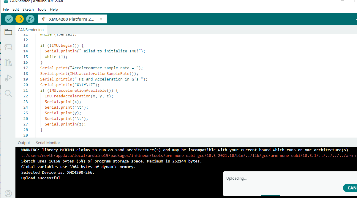

2 Transmit Side – Platform2Go 4200 Workflow
Platform2Go 4200 polls IMU via I2C, reads raw acceleration X/Y/Z , converts raw integer register values to engineering float units
#include <CAN.h>
#include <MKRIMU.h>
float x, y, z;
void setup() {
  Serial.begin(9600);
  while (!Serial);
  if (!IMU.begin()) {
    Serial.println("Failed to initialize IMU!");
    while (1);
  Serial.print("Accelerometer sample rate = ");
  Serial.print(IMU.accelerationSampleRate());
  Serial.println(" Hz and Acceleration in G's ");
  Serial.println("X\tY\tZ");
  if (IMU.accelerationAvailable()) {
    IMU.readAcceleration(x, y, z);
    Serial.print(x);
    Serial.print('\t');
    Serial.print(y);
    Serial.print('\t');
    Serial.println(z);
  Serial.println("CAN Sender");
  // start the CAN bus at 500 kbps
  if (!CAN.begin(500E3)) {
    Serial.println("Starting CAN failed!");
    while (1);
void loop() {
  // send packet: id is 11 bits, packet can contain up to 8 bytes of data
  Serial.print("Sending packet ... ");
  CAN.beginPacket(0x12);
  CAN.write('h');
  CAN.write('e');
  CAN.write('l');
  CAN.write('l');
  CAN.write('o');
    CAN.write(&x,4);
    //Serial.print('\t');
    CAN.write(y);
    CAN.write(z);
  CAN.endPacket();
  int packetSize = CAN.parsePacket();
  if (packetSize) {
    // received a packet
    Serial.print("Received ");
  Serial.println("done");
The reading for x-y-z is output

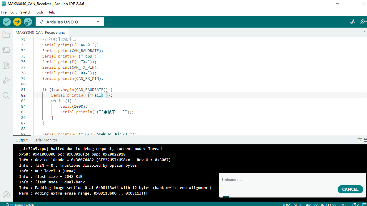

3 Receive Side – Arduino Uno Q + MAX33040 Custom Self-Built CAN Library
3.1 Hardware Control Logic
  1. MAX33040D4 STB pin set HIGH on startup to exit low-power standby
  2. UART hardware pins D0(RX)/D1(TX) connect directly to MAX33040 differential CAN physical layer
3.2 The library with GPIOpin simulation for CAN

Flash the code in Arduino IDE and receive the x-y-z data in float type,first wait for the CAN initiation.
The Arduino UNO Q send data received from CAN bus over SERIAL port, this is for LABVIEW VISA port to get data. The operation loop,
  1. Initialize custom CAN library + MAX33040
  2. Continuous poll for incoming CAN frames
  3. If valid IMU CAN ID detected: unpack all X/Y/Z float values
  4. Format serial CSV string, transmit over Uno Q USB UART
