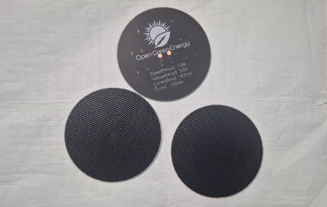

In this challenge I want to build a system where three solar panels ( 3×1W, 5.5V  panels which i had previously bought from China) will have their output measured by the Arduino UNO Q alongside a suite of environmental sensors. One panel is kept mechanically clean at all times as a live reference. Whatever current it produces at any given moment is exactly what the other two panels should produce under the same sky. Any deviation is soiling is measured live, tagged automatically, no ambiguity.

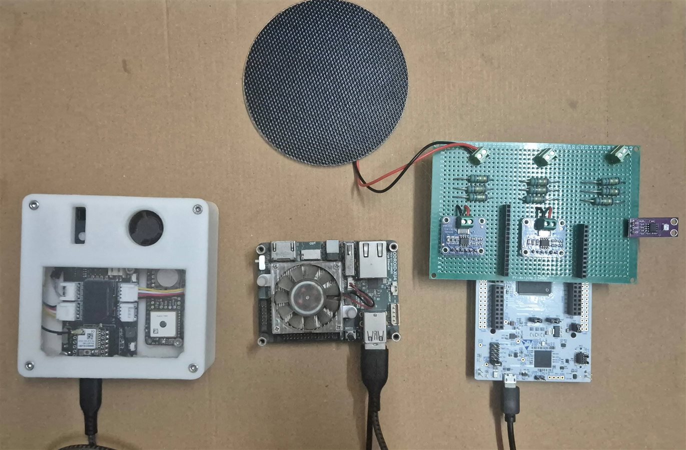

I was already in the process of making this project when this challenge was announced as it was complementing my masters thesis and this is how it looks.
The setup uses two identical solar panels side by side. One stays clean (the control), the other collects dust (the test panel). Both power the same resistor, so measuring voltage across each gives you the current through it.
The key insight: divide the test panel's current by the control panel's current. That ratio — the Performance Ratio — cancels out weather entirely, since both panels see the same sky. A clean panel gives PR ≈ 1.0. As dust builds, PR drops. That's the whole experiment.
With this rig, i had run into some reliability issues, Especially with my Odroid, But still managed to run it for 3 weeks. Ran the saved data through the Edge Impulse. I was not sure if i should do Anomaly Detection or Classifier, so I tried both.

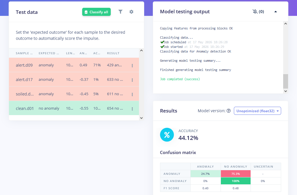

K-means anomaly detection
Essentially, I will be feeding it good values and expect AI to find something which is not within the norms
Accuracy: 44.12% - Of actual anomaly windows, only 24.7% were correctly flagged; 75.3% were called no anomaly. The K-means clean cluster is not tight enough on the data to reliably eject soiled and alert windows as outliers. Now I am not a great AI Expert but 44 is a poor value even for a Proof of Concept.
Neural network classifier (3 classes)
The second impulse switches to a Classification learning block with 3 output classes: alert, clean, soiled. Alert is when Things have started to degrade and cleaning should be planned soon, whereas alert is when The panels output has degraded qutie significantly.
This turned out to have better results 67%.  Now in the confusion matrix - There was some inconsistencies between Alert and Soiled, but given the small dataset, it is quite acceptable.

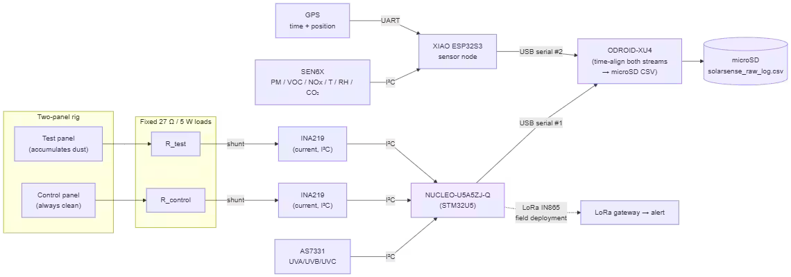

Make the proper setup for Data Collection Module using
  1. 3 Panels stated Above
  2. The Omega  Humidity and Temperature sensor (The temperature sensor here is  way better than the one in SEN66)
  3. AQI using Sensirion SEN66
  4. UV Light
  5. Current Sensor - INA218B
  6. Custom STM32 Board which sends data over by CAN
Data Aggregation Module
  1. Arduino Q with MAX33041E Shield to Receive Data from data collection module
  2. Do local processing of the data and send it to Edge AI using data Ingestion AI
  3. Receive Updated model from Edge AI
  4. Perform check on the data received from test panel to classify data in real time
