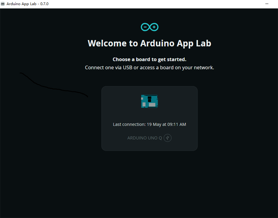

Open the Arduino App LAB and search the board

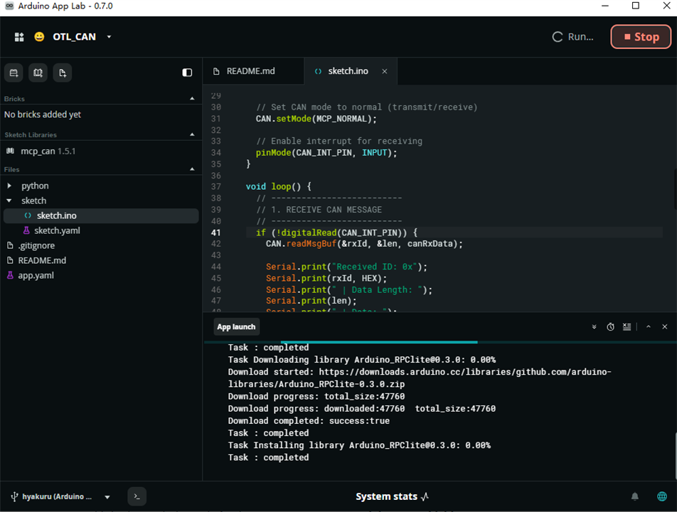

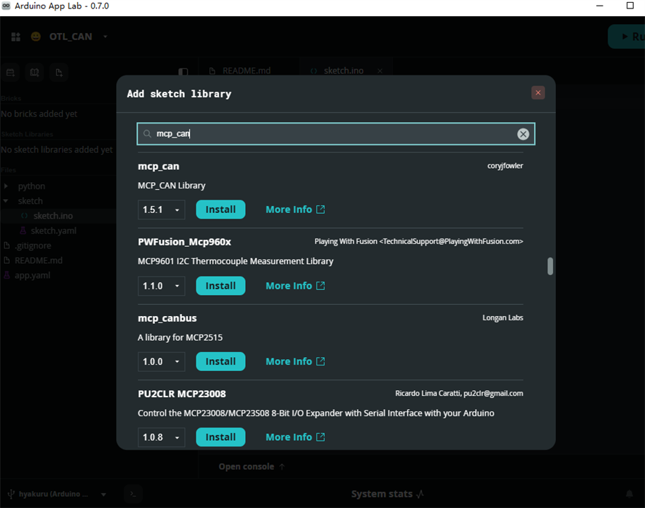

download and install the can library for arduino, refer to GitHub - coryjfowler/MCP_CAN_lib: MCP_CAN Library · GitHub

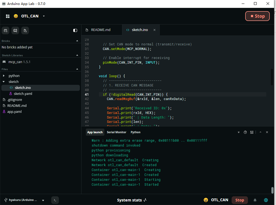

Here is the  test code

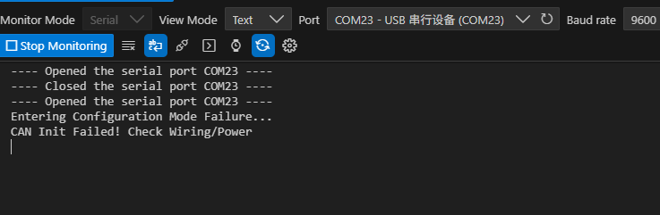

Press run for the progress
and here is output from terminal, since this is only one side of CAN transmitter, fail it is right result. Improve later.

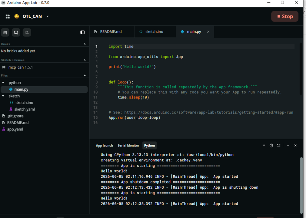

Be noted, python is run as well. That is Arduino Uno Q, and how it plays
