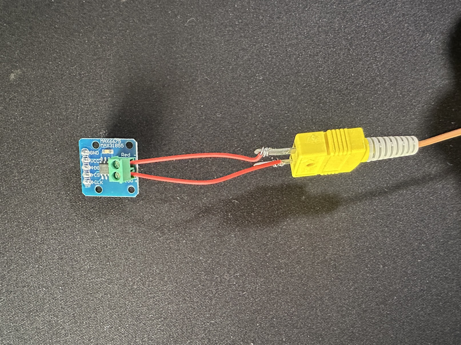

For my project, the measurement of a machine temperature is required. A thermocouple is one of the best sensors for measuring the temperature of an electrical machine. Thanks to Omega for sending several K-type thermocouples as a part of the Challenger kit. These thermocouples are capable of measuring from -200°C to 1250°C. For measuring temperature using any microcontroller, we need to use an amplifier and signal conditioning circuit like MAX31855 or MAX6675. As the thermocouples came without any amplifier module, I managed a MAX6675 module to connect the thermocouple with the ESP32. The following image shows my connection of the thermocouple with the amplifier module.

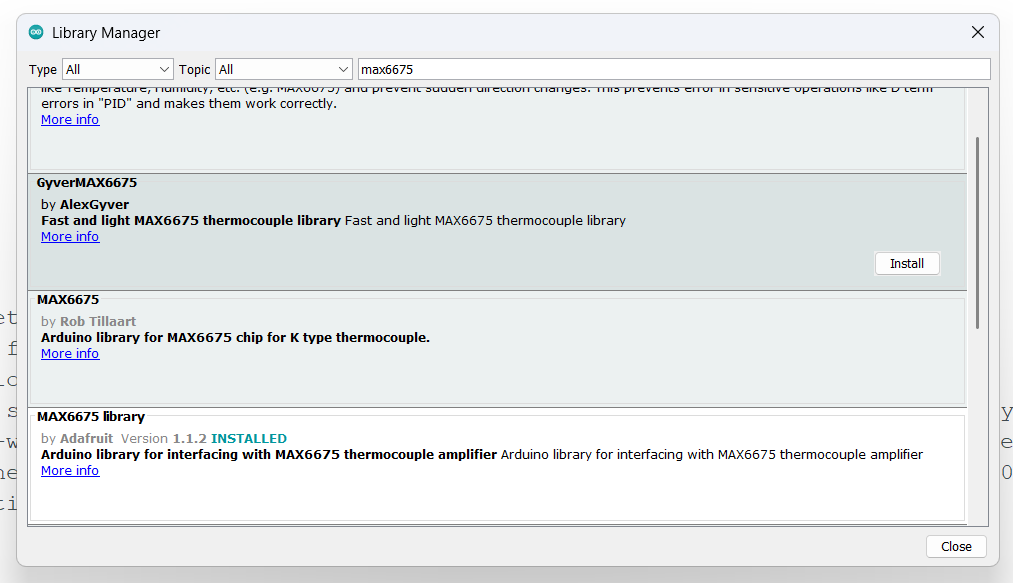

ESP32 module was programmed using Arduino IDE. I installed the MAX6675 Arduino library.

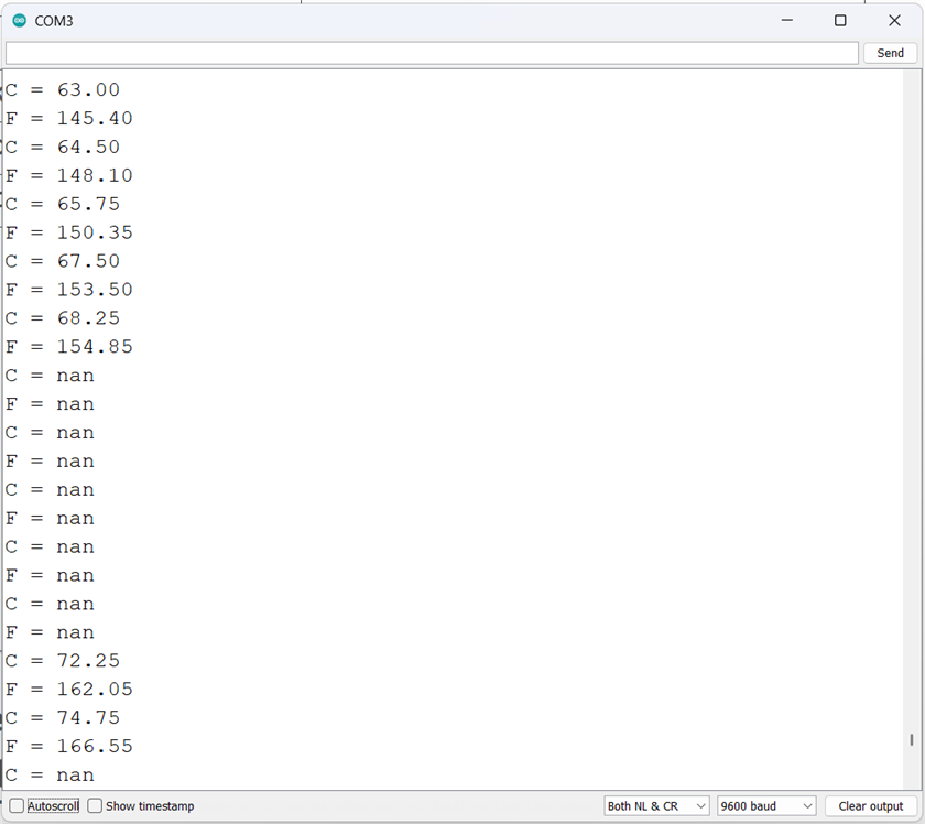

At room temperature, without connecting anything, the thermocouple, I got the following response in the serial terminal:

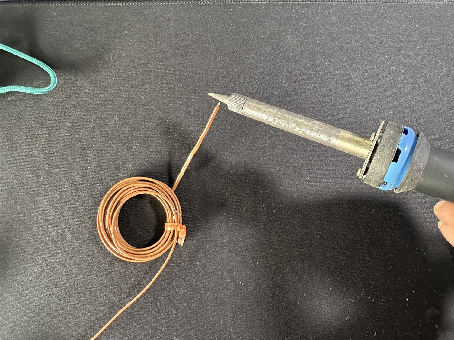

I connected my hot soldering iron tip to the thermocouple and got the following data.
I noticed the temperature has increased, but I am not sure whether this is the correct temperature or if I need calibration. I will try to find it later.
