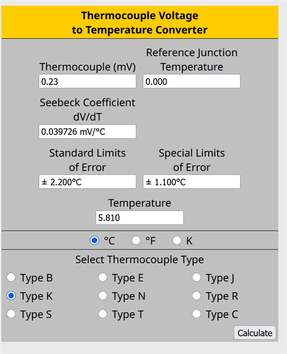

I tried Fluke online calculator at: www.fluke.com/.../thermocouple-voltage-to-temperature-calculator
As you can see, such small voltage difference correspond to 5,810 °C temperature difference between cold junction and thermocouple. It corresponds to difference between room temperature about 29°C these days and my finger temperature around 36°C.
