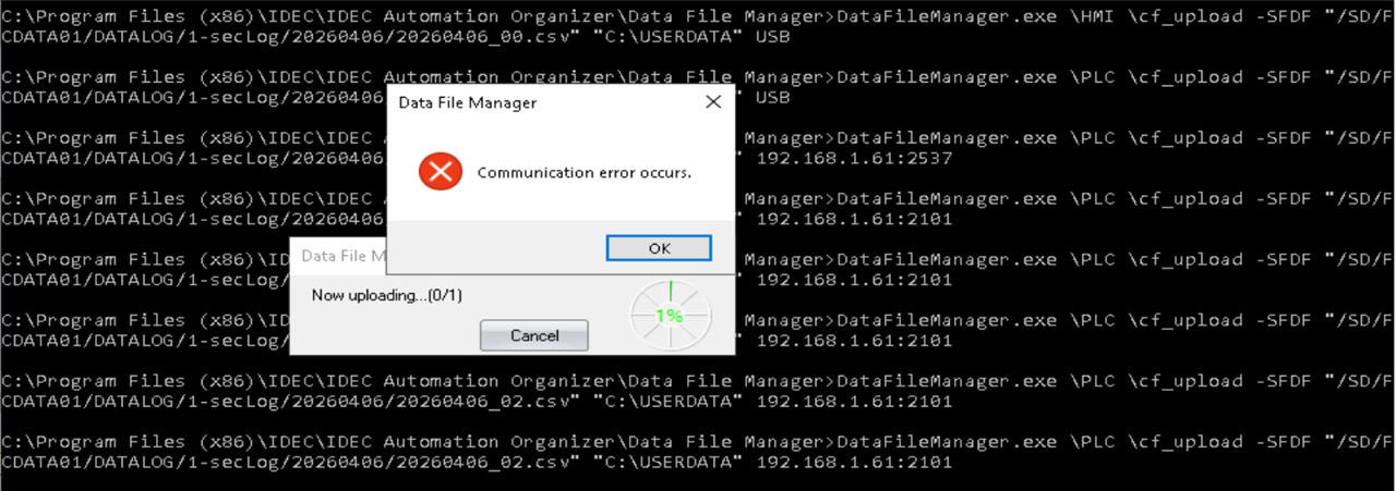

I work with IDEC PLCs. They have some software which was probably really nice in 1982.
yesterday, I was so infuriated when a log download process kept failing, I went off and made my own utility to get logs.
The general gist is that when the OEM supported software looses connection, you loose the entire set of data you had been downloading.
many of our systems are thousands of miles away, on questionably reliable networks. While you might see 20Kpbs down, locally, remote connections even for small files can take hours at 2-4KBps. then to loose it. .. OMG. or the syntax is convoluted AF, or theres no direct way to automate the process via the OEM supported software.
Well last night, I had enough, and delved into the internal operation of remote SD Card reading, via Maintenance Protocol.
