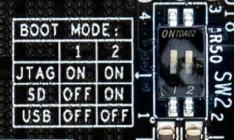

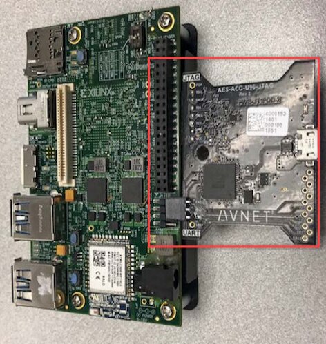

I had to connect the JTAG/UART pod to the board and set BOOT jumpers on the board to boot from JTAG.
The image below is for the Ultra96-V1 board. The Ultra96-V2 does not have the USB boot option.

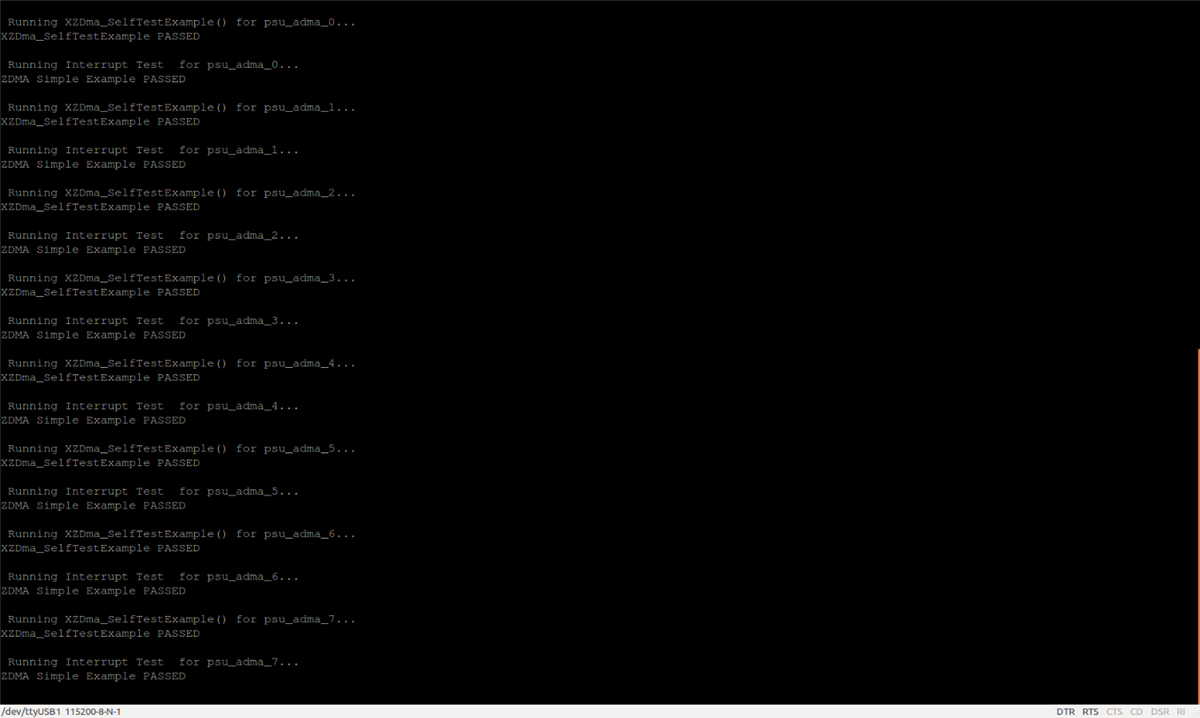

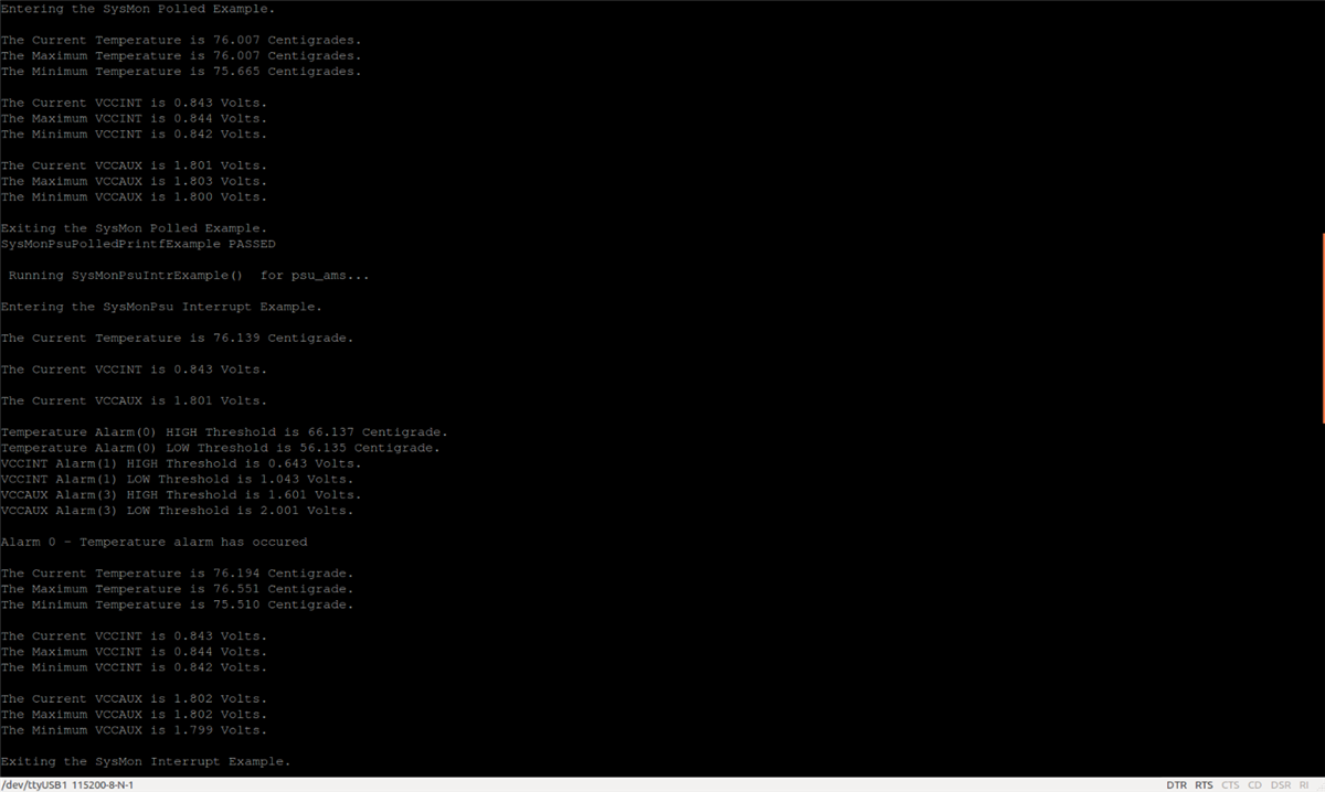

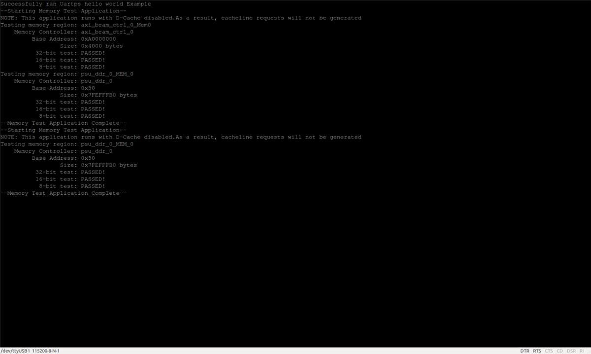

The terminal output of the board was used for application outputs, so I finally go to use the Ubuntu Serial Terminal installed in a previous lab. See below.
I successfully tested applications:
  • Hello World
  • Test_Memory
  • Test_Memory_1MB
