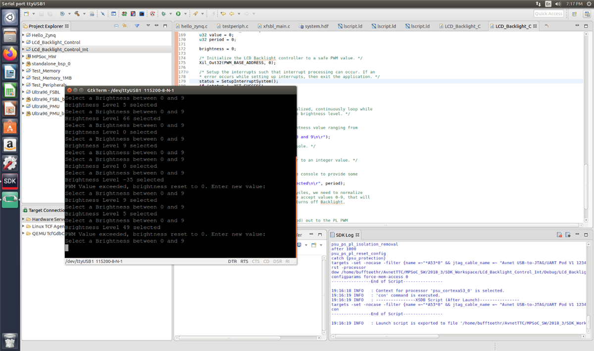

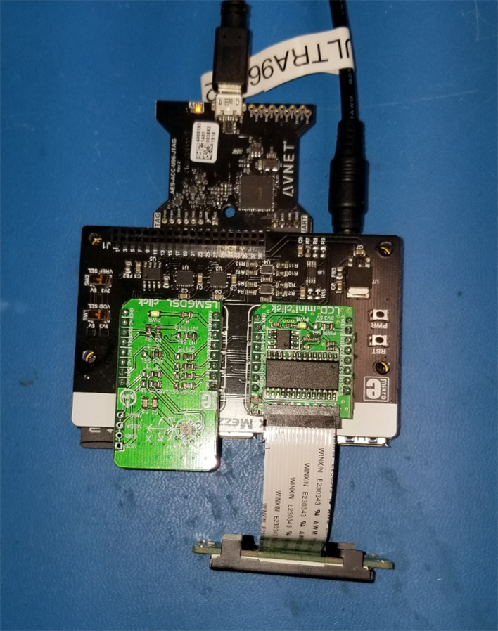

In this lab we will perform steps to import a known good code base to access a piece of custom hardware built into the system. This hardware will control the back light on the LCD mini click allowing the backlight intensity to be increased and decreased. From that point, we will modify the application code to respond to an interrupt generated by the custom hardware platform when an incorrect PWM value is written to the PWM controller.
This was the first lab I did that utilized the Click Mezzanine and Click boards. It used the LCD Mini Click and the lab software was used to change its brightness of the LCD back lighting, showcasing an interrupt service routine when an invalid value is entered.
In the first experiment of the lab I walked through a sample application that allowed me to control the backlight brightness of the LCD. The brightness was select via a keyboard entry using the serial terminal.
The second experiment in the lab involved adding interrupt support to the application imported and used in the first experiment. Acheck was also added to prevent a user from entering a value that excedded the allowed range. The follwoing api calls used to support Interrupts were highlighted:
