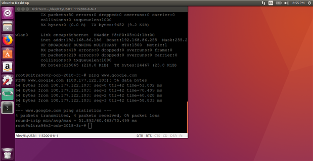

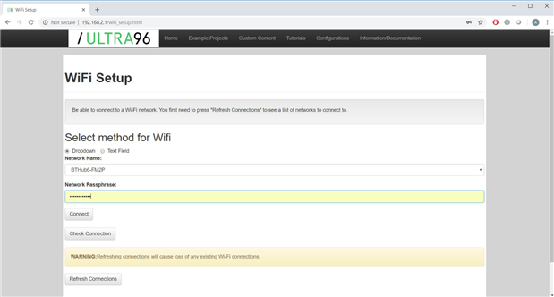

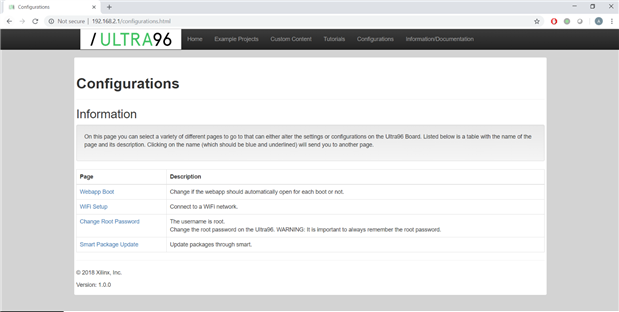

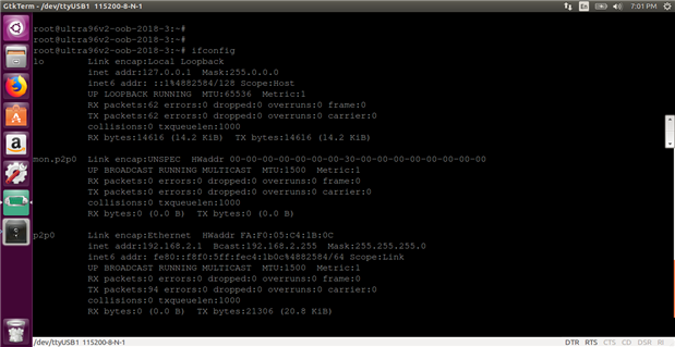

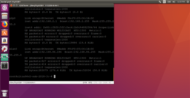

In Lab 3 the object was go setup the WiFi connection between the Ultra96-V2 and my home WiFi network. You can see form the image about that I was able to establish a connection and ping www.google.com. The Ultra96-V2 by default comes up as WiFi access point. I connected to it with my laptop and using the Web Browser interface on the Ultra96-V2 and selected the Configuration setting and setup the Wifi on the board to access my home network.
