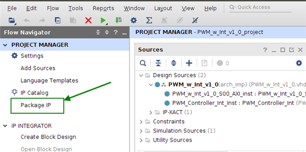

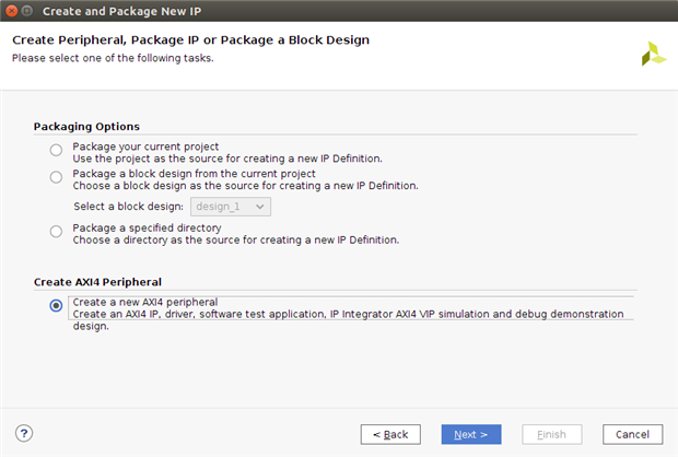

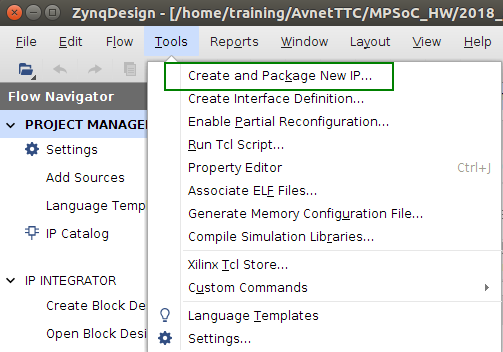

In the Menu there is an Option called Tools. There is a selection to Create and Package New IP

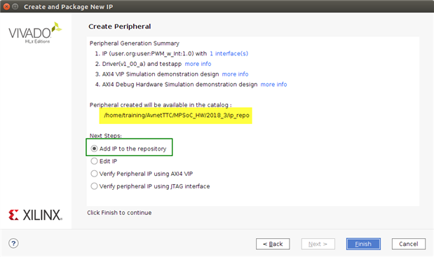

I made an AXI peripheral

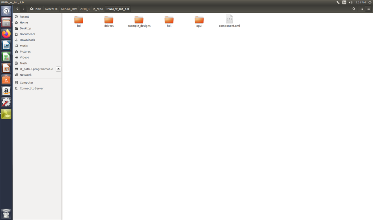

After creation the IP was then added to the repository.

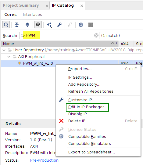

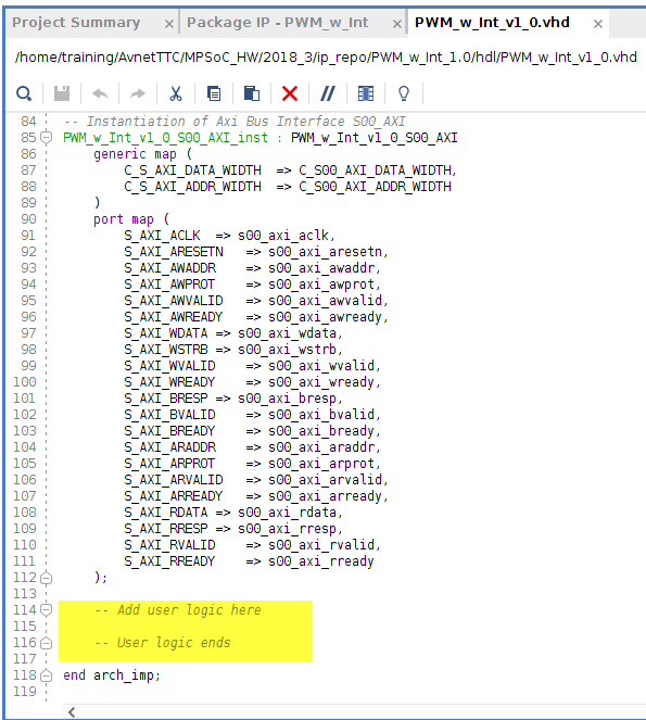

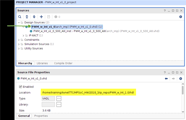

Once the Custom IP was added to the repository I was able to edit it in the IP packager.
This allowed me to edit the source code for the custom IP and well as add new sources.

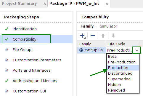

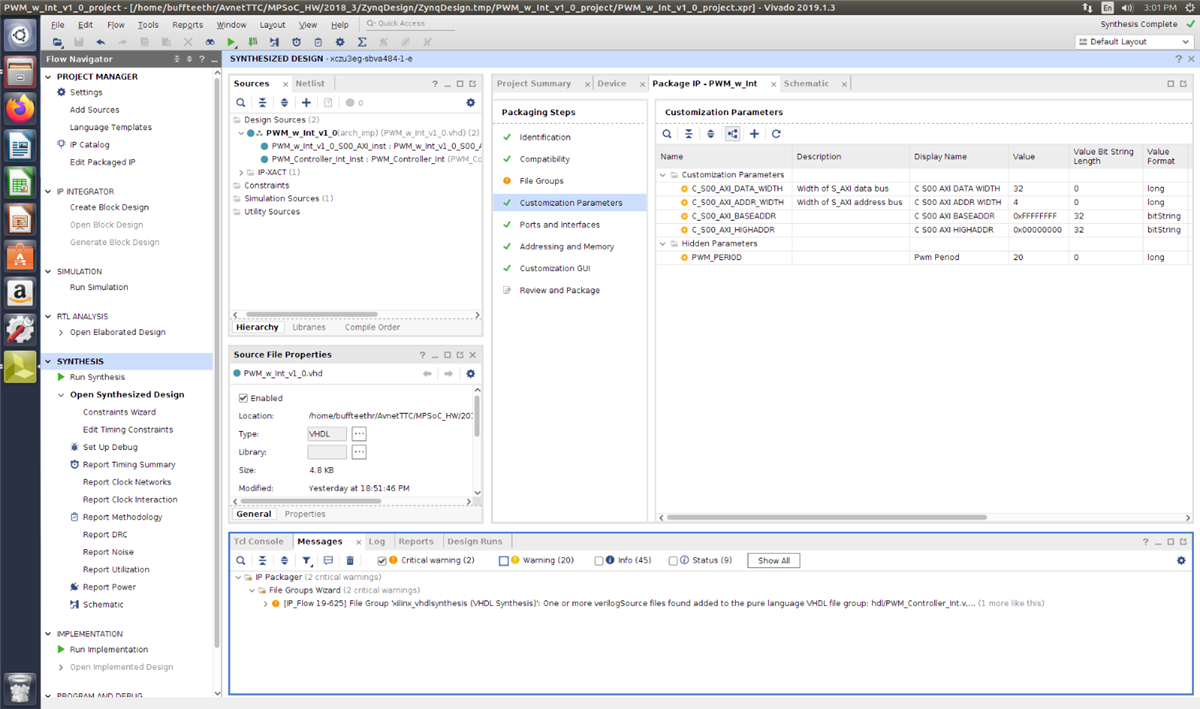

The next stage involved Packaging the IP

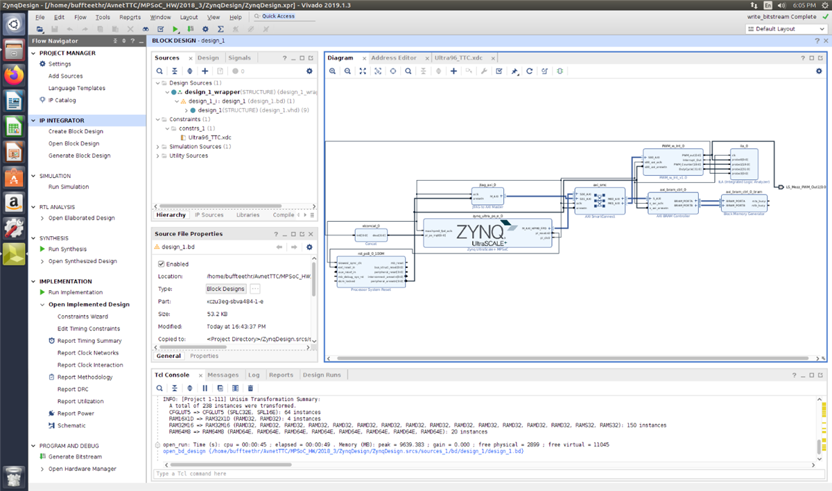

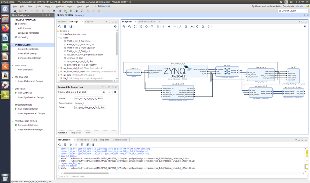

Once the Custom IP compiled and was package I was able to add it to my design as shown below.
