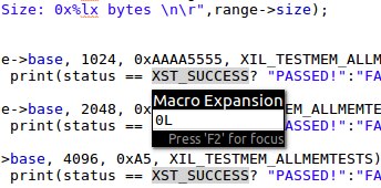

The SDK is built on the Eclipse IDE platform. I have had very little interaction with Eclipse in the past, but I'm liking it quite a bit already. To an inexperienced user, it's hard to tell what features are native Eclipse and what features have been added in by Xilinx. Overall, the feel and design flow seems user-friendly and intuitive. My favorite feature is the context popups you get when hovering over different elements in source files. You can see macro expansion (i.e. what values / definitions macros are initialized with), function definitions / prototypes, and I even saw info on a string (within a print statement), but haven't been able to replicate it for a screenshot. Below are a couple examples (Fig 1 and 2). Once the popup appears, you can move your mouse over it in order to expand the popup or scroll to see more context. Definitely a handy feature!
Fig 1. XST_SUCCESS Macro Expansion

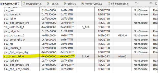

We know from the previous lab that the Test_Memory application first tests the AXI BRAM, followed by the DDR4. The base address for the AXI BRAM can be found in the HDF:
Fig 5. AXI BRAM Base Address in Hardware Definition File

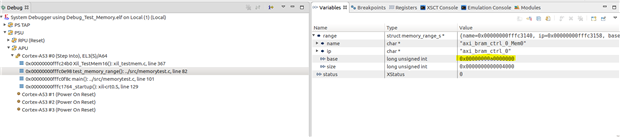

The address listed in the memory map is 0xA0000000 for the AXI BRAM. This can also be found in the variables view in the debug perspective. The "memorytest.c" source file declares a "memory_range_s" variable containing the memory base address:
Fig 6. AXI BRAM Base Address defined in program variable (Upper right of Debug perspective)

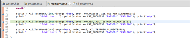

I set the location of my first memory monitor to location 0xA0000000. I then set break points in front of each memory test function call; the 32 bit test, the 16 bit test, and the 8 bit test:
Fig 7. Program break points
Using "Step Over" will not enter function calls / loops, but I wanted to step through some of the memory test application. For this, I used "Step Into":
Fig 8. Step Functions in Debug Perspective

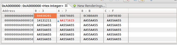

This brought me into the "xil_testmem.c" source file, and I could see values being written to the memory addresses in the memory monitor. The following shows a 8-bit write test on the AXI BRAM. Values 0x01, 0x02, 0x03 and 0x04 are written to addresses 0xA0000000 through 0xA0000003, and so-on, as I step through the application:
Fig 9. AXI BRAM 8-bit word memory test (stepped)

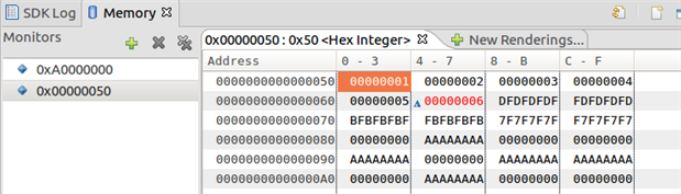

In the previous lab, we also learned that DDR4 address locations are reserved until 0x50, which can be seen back in the variable view. I added the Memory Monitor for address 0x50. The following are screen shots captured while stepping through the 16-bit and 32-bit memory test on the DDR4:
Fig 11. DDR4 16-bit word memory test (stepped)
Fig 12. DDR4 32-bit word memory test (stepped)
