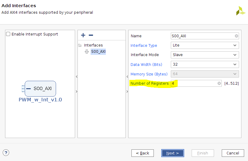

As you can see, the only signal accessible through the AXI interface is the PWM Duty Cycle. Therefore, at least one AXI slave register needs to be added to the IP block. Registers can be added through the GUI as highlighted in the figure below.
I won’t cover the internals of the PWM logic itself. What is more interesting is how to connect that to the AXI interface, so that the duty cycle can be set by the PS. The PWM_w_Int_v1_0_S00_AXI.vhd is autogenerated by Vivado and has AXI interface signals and logic. File also has some placeholders to fill in with user logic. One of the 4 AXI slave registers can be used to receive Duty Cycle setting. A 32-bit wide slave port can be added to the AXI bus port map. It can then be connected to Duty Cycle port of the PWM_controller module in the wrapper.

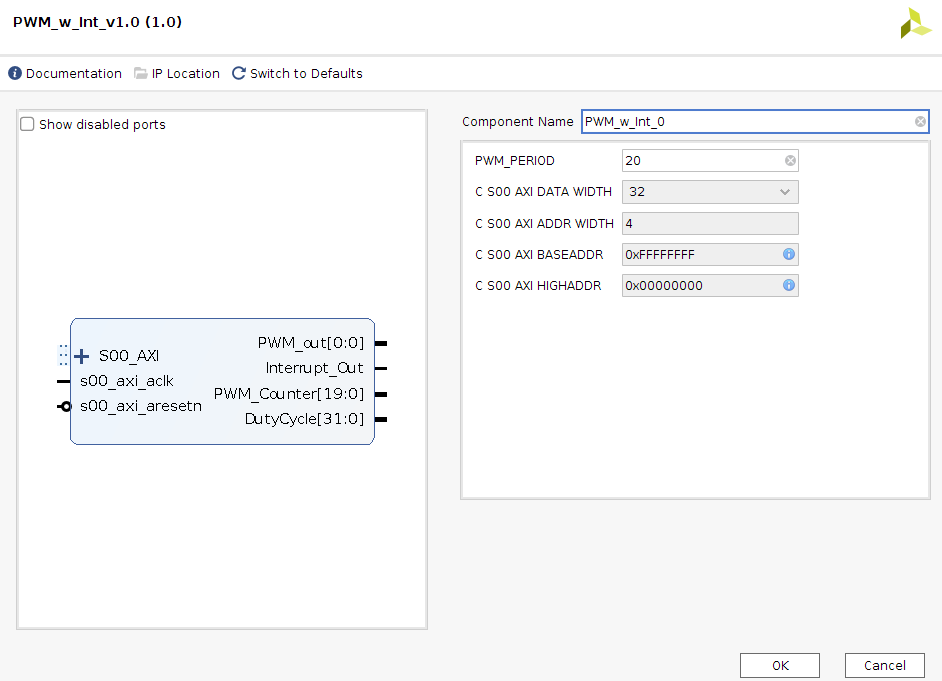

The IP block can be packaged once all signals are interconnected as desired. In the IP Packaging tool GUI many options can be configured such as what to include with the component (simulation files, synthesis, etc.) and what signals are accessible from outside the block. The resulting IP looks like this:
PWM driver is then accessible from the Vivado IP library. It can be added to the Block Design and connected to Zynq MPSoC.

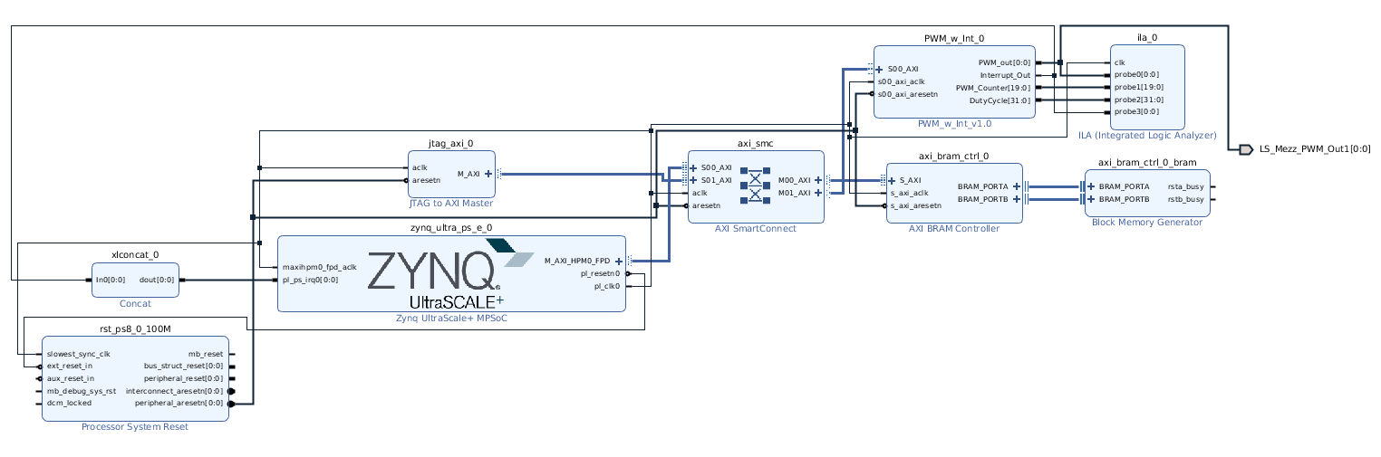

Two extra components were added for debugging purposes: Integrated Logic Analyser (ILA) and JTAG AXI. The following is the complete design:
ILA is extremely useful to monitor the internal signals live. In this example, it was used to monitor the Duty Cycle changes based on the user input for the backlight brightness. Since used ILA before, I was more curious about the JTAG to AXI core.
This block allows to manually trigger AXI transactions and inspect their behaviour. This can be very handy to verify communications between various AXI peripherals. In this example, contents of AXI connected BRAM was modified by performing AXI write operation.
