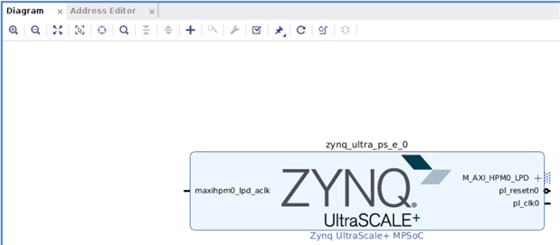

Vivado allows the designer to create an overall hardware block diagram of the design from different components in the IP catalog. As will be seen later, we can even create our own custom packaged IP to add to this block diagram. The first item we added to the block diagram was the main component of the Ultra96-v2 board: the Zynq UltraScale+ MPSoC itself which we already selected the correct part number for.

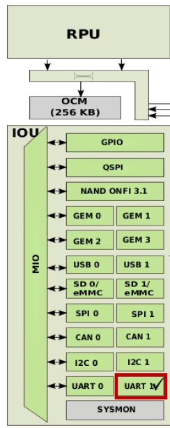

Once the MPSoC IP was added, we double-clicked to edit the configuration:
All the items in green are hardware peripherals of the MPSoC which can be customized in Vivado. Once a peripheral is enabled and customized, a check mark appears next to it on the MPSoC block design:

There are two types of I/O, MIO and EMIO. EMIO is I/O which can map the processing system peripheral I/O to the programmable logic. The MIO are dedicated I/O for processor peripherals, especially high speed peripherals, which can't be routed via the EMIO.
We configured settings for the UART1 peripheral, MIO bank voltages, memory (DDR4), and clocks, before building the hardware platform for export to the SDK. We validated the design and then created a top-level wrapper for the design. This wrapper will later contain all the connections made in our hardware block design. A few PS-PL interface related options are enabled by default (clock, reset, AXI connection). We disabled these, as we were not ready to use the PL. The final step in Vivado was to generate the PL bitstream before exporting the HDF to SDK.
