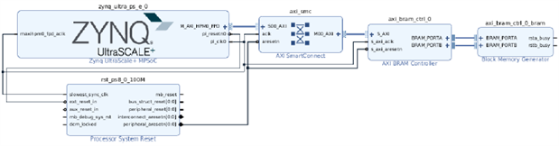

Lab 5: Adding a PL Peripheral
In this lab, we added our first PL peripheral to the hardware design. We added an AXI BRAM controller which allows the processing system to access the programmable logic block ram via an AXI interface, giving the PS yet another source of memory (in addition to the on-chip memory and DDR4 memory on the Ultra96-V2 board). The Xilinx AXI BRAM controller IP allows for configuring AXI protocol, number of BRAM interfaces, data width, and memory depth, as well as error correcting code options.
Once the controller IP was added, some additional IP needed to be added. Vivado has a convenient feature called "Designer Assistance" which can automatically add and/or connect certain IP as needed:
In this case, Vivado added a Block Memory Generator which creates instantiations of interfaces to the BRAMs.
The final pieces needed to access the BRAM were an AXI master, a fabric clock and a fabric reset configured in the PS. We added the AXI master and fabric reset in the MPSoC+ configuration block under PS-PL Configuration, and the clock in the Clock Configuration.
Again the Designer Assistance option was available. Running it added an AXI SmartConnect block (connects AXI master in PS and AXI slave BRAM controller in PL) and a Processor System Reset block. After this was all done, we generated the bitstream.
NOTE:There was one lab instruction that seemed out of order in this lab. Step 15 in experiment 2 viewed the BRAM settings which should have been 128 write/read width and 1024 write depth. Mine initially showed 32 write/read width and 8192 write depth. This step said these parameters are inherited from the BRAM controller IP and updated when the design was validated. It wasn't until after step 17, where we were instructed to validate the design, that the parameters did indeed update and match what was shown in step 15.
