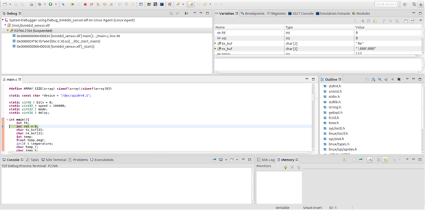

In this lab we finally get to develop a custom application for PetaLinux and debug it on hardware. We proceed as in the previous modules (Hardware and Software). The difference is that Linux should be selected as the OS platform when creating a new project in the Xilinx SDK.
The application code is provided with the tutorial files and simply reads temperature data from the LSM6DSL sensor that is plugged in the Ultra96 using the Click Mezzanine. Communication happens over SPI.

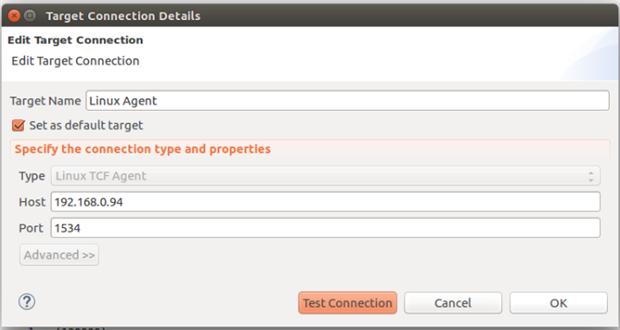

On the other hand, debugging interface is quite different from the previous exercises. The application loading and debugging will be happening remotely. To achieve that we need to set up a tool called Linux TCF Agent. IP address noted in the last lab is required. The Port field should be set to 1534.
Then create new Run/Debug settings and launch Debug on Hardware. This will switch you to the Debug view of the Xilinx SDK.

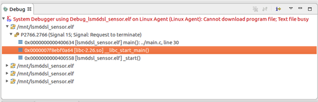

The first time I did this I got an error message that the program file cannot be downloaded. I tried to reset the debug session several times. It did not resolve the issue so I had to restart the SDK and repeat all the steps from scratch to make the debug session work.
Otherwise, debug process is identical to whatever was covered in Hardware and Software modules.

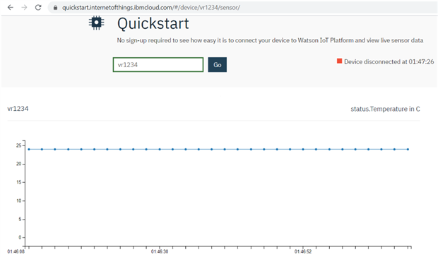

I never expected that connecting your device to an IoT server would be this simple. I never used IBM Cloud before and only worked with the AWS IoT Core previously. I really enjoyed the quickstart feature where you only need to type in your device name to see the data it is ending. This is done via the link:  https://quickstart.internetofthings.ibmcloud.com/#/
Obviously, there is work to do on the Ultra96 side. We need a working MQTT client to handle communications with the IBM Cloud. Again, the application code was provided and only the device name needs to be changed. There is a great tutorial that covers step by step how to integrate MQTT with your application: https://forums.xilinx.com/t5/Adaptable-Advantage-Blog/MicroZed-Chronicles-MicroBlaze-Linux-MQTT-and-IoT-Frameworks/ba-p/975804
When application is loaded and Ultra96 is connected to the network, temperature data from the LSM6DSL sensor is plotted in the IBM Cloud web interface.

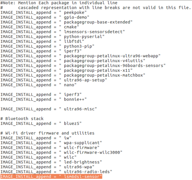

In the final lab I learnt how to add my application to the PetaLinux build. To do that, we need to use a different PetaLinux command option:
petalinux-create -t apps --template c --name lsm6dsl-sensor –enable
As you can see, the same command is used as for creating a new project. However, the -t option is changed to apps. The LSM6DSL application is used again as example. You will find your application listed in the bitbake file (<path_to_petalinux_directory>/2018_3/support_documents/v2/lab6/<project_name>/project-spec/meta-user/recipes-core/images) once the command above is executed successfully.
It is important to modify your application bitbake file (<path_to_petalinux_directory>/2018_3/support_documents/v2/lab6/<project_name>/project-spec/meta-user/recipes-apps/<app_name>), too, to point it to correct sources and Makefile. You also need to specify the installation folder in the root file system by setting a parameter: FILES_${PN} += "/home/petalinux/*"
Finally, PetaLinux can be rebuilt so that the application is included.
