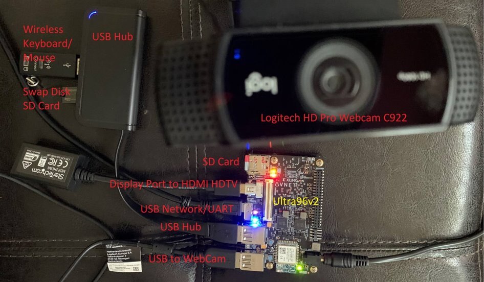

Hardware
A list of hardware devices used for this project (shown in the picture below):
1. Logitech C922 webcam x1
2. Ultra96v2 x1
3. 8G uSD cards x2
4. Display port ot HDMI adapter cable x1
5. HDTV x1
6. USB Hub x1
7. Wireless keyboard & mouse x1
8. USB network/NART cable x1

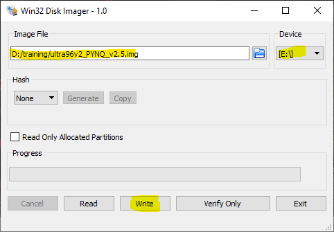

Prepare PYNQ image SD Card
First, you need to download the latest pre-built PYNQ image here. When I wrote this blog, the latest version is 2.5 (ultra96v2_PYNQ_v2.5.img).
Next, you need to create a bootable SD card with the downloaded image. Here's a few tips for how to correctly create the SD card:
1. If you have a brand new SD card, use the utility tool Win32 Disk Imager to write the downloaded image to the SD card as shown below

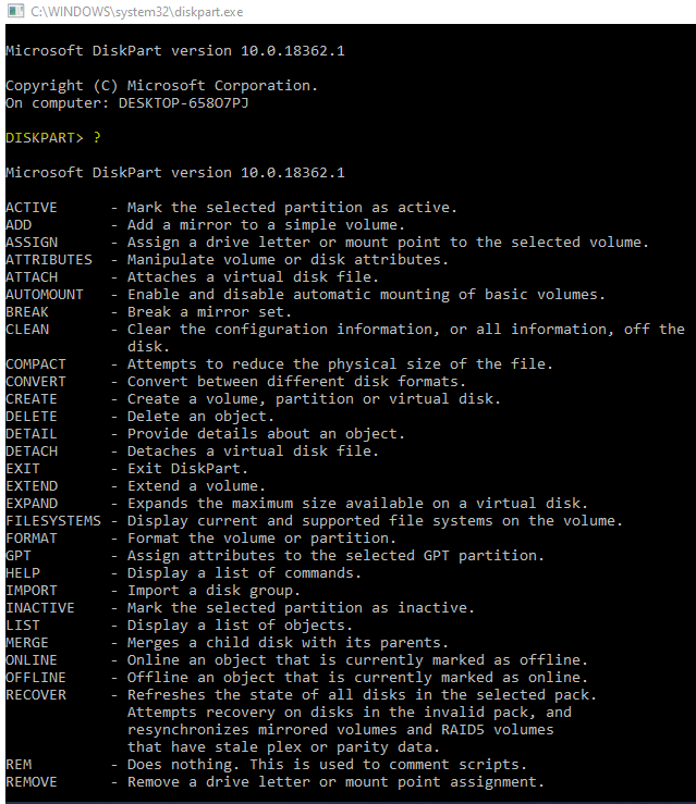

2. If your SD card has been used for other projects, you may need to use Windows' DiskPart command to remove all existing partitions and create a new FAT32 partition. Then format it. After that, you can do the previous step for creating the SD card. You can find DiskPart documentation here.

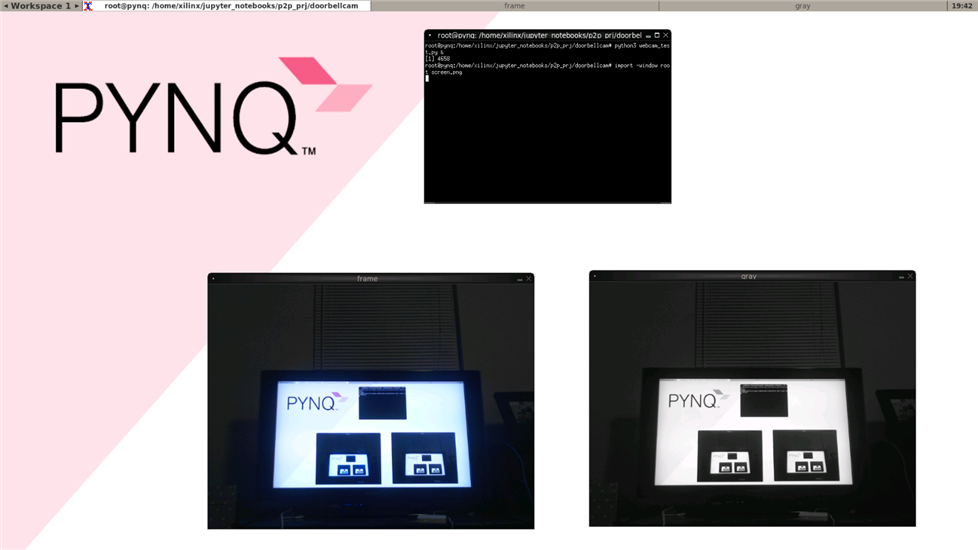

Check if Your Webcam Works with PYNQ
My Logitech C922 webcam is supported by PYNQ, but you may need to check if your webcam is supported. If you run the following Python code in (https://www.codingforentrepreneurs.com/blog/opencv-python-web-camera-quick-test) and see a similar screen as shown below, that means your webcam is supported by PYNQ.

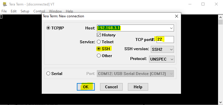

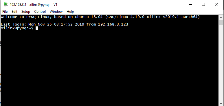

Connect to Ultra96
You can use either of the following two methods to connect to Ultra96:
1. Serial UART connection through USB Network/UART cable
2. Network connection through USB Network/UART cable

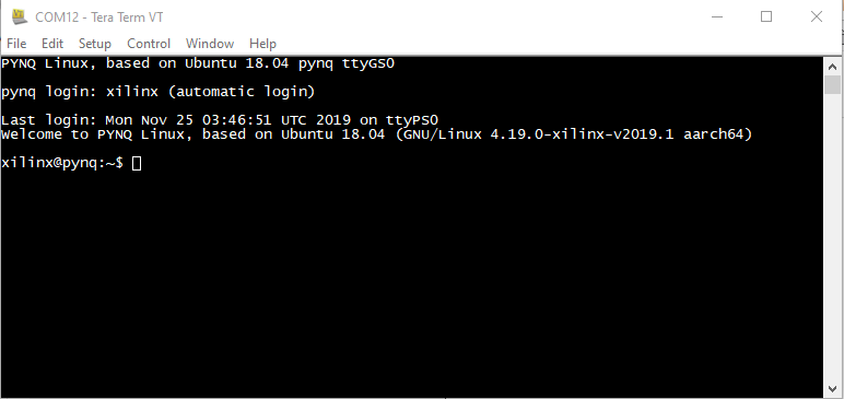

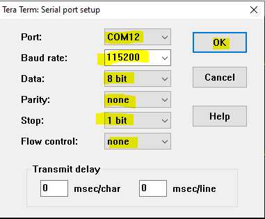

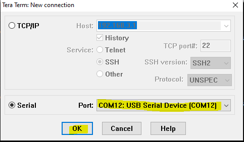

UART Connection
I use Tera Term and the set up of UART connection is shown below.

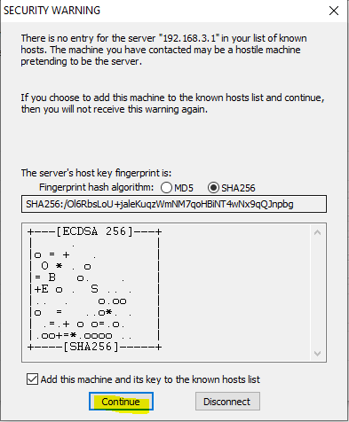

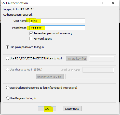

Network Connection through USB Cable
Default password is xilinx.

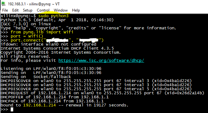

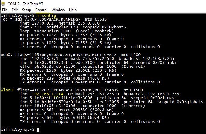

WiFi Connection
Use either of the above two methods to connect to Ultra96, type the commands below (in bold font)
xilinx@pynq:~$ sudo python3
[sudo] password for xilinx:
Python 3.6.5 (default, Apr  1 2018, 05:46:30)
[GCC 7.3.0] on linux
Type "help", "copyright", "credits" or "license" for more information.
>>> from pynq.lib import Wifi
>>> port = Wifi()
>>> port.connect("your_wifi_essid","your_wifi_password")
ifdown: interface wlan0 not configured
Internet Systems Consortium DHCP Client 4.3.5
Copyright 2004-2016 Internet Systems Consortium.
All rights reserved.
For info, please visit https://www.isc.org/software/dhcp/
Listening on LPF/wlan0/f8:f0:05:c3:30:96
Sending on   LPF/wlan0/f8:f0:05:c3:30:96
Sending on   Socket/fallback
DHCPDISCOVER on wlan0 to 255.255.255.255 port 67 interval 3 (xid=0x7928c939)
DHCPDISCOVER on wlan0 to 255.255.255.255 port 67 interval 5 (xid=0x7928c939)
DHCPREQUEST of 192.168.1.214 on wlan0 to 255.255.255.255 port 67 (xid=0x39c92879)
DHCPOFFER of 192.168.1.214 from 192.168.1.1
DHCPACK of 192.168.1.214 from 192.168.1.1
bound to 192.168.1.214 -- renewal in 21017 seconds.
You can see the Ultra96 got an IP address 192.168.1.214. Internet connection is required for the software installation described in the next chapter.

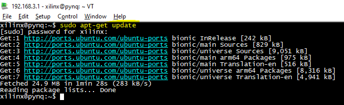

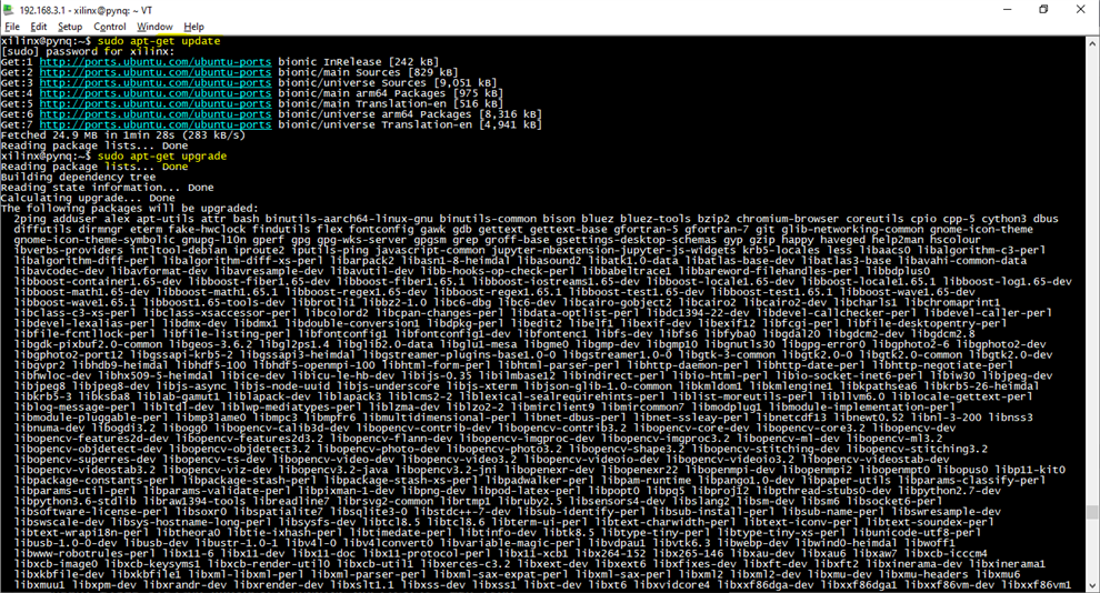

Update PYNQ
The following commands just make sure PYNQ components up-to-date. On Linux based system, these two commands are usually executed before installing and/or update software.
sudo apt-get update
sudo apt-get upgrade

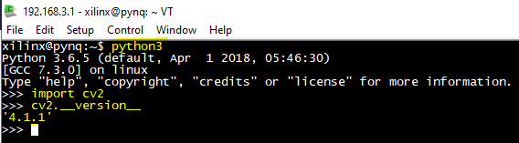

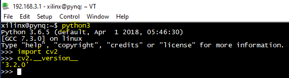

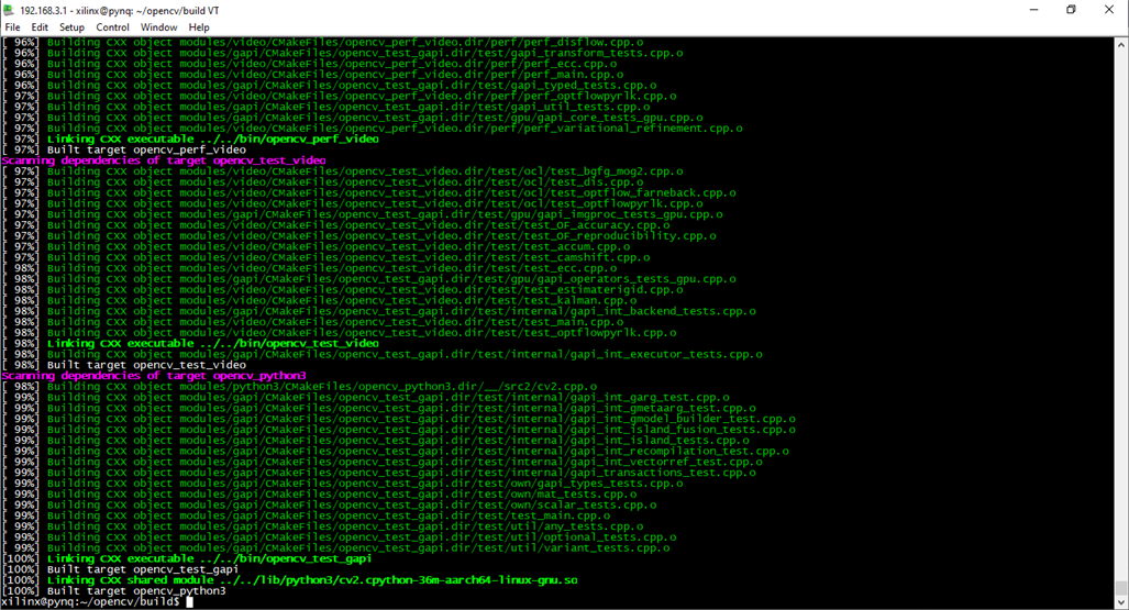

Download, Build and Install OpenCV 4.1.1
PYNQ 2.5 came with an old version OpenCV - v3.2.0 and I updated to 4.1.1.
First, make sure you have WiFi connection using ifconfig command as shown below. If not, please refer to the WiFi Connection section above.
Next, download the source code as shown below
After download completed, a file named opencv.zip is created. Unzip it and create a symbol link to the unzipped folder using the following commands:
xilinx@pynq:~$ unzip opencv.zip
xilinx@pynq:~$ ln -s opencv-4.1.1 opencv
Before building OpenCV, let's make some preparation. First, create a build folder using the following commands:
xilinx@pynq:~$ cd opencv
xilinx@pynq:~$ mkdir build
xilinx@pynq:~$ cd build
Then we insert the second SD card and find its device name
We can see the device name is /dev/sda1 from the above screen shot. Next, we enable it as a swap disk

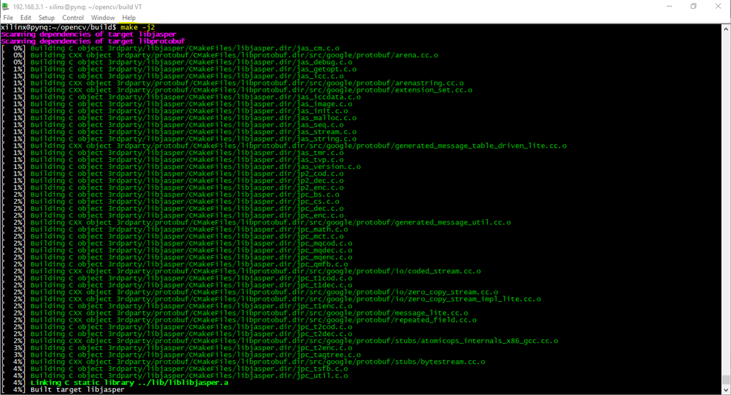

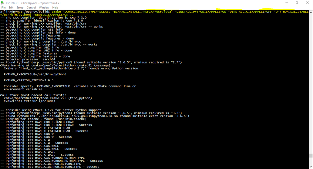

After preparation is done, we can configure OpenCV and build it using the following two commands
xilinx@pynq:~$ cmake -DCMAKE_BUILD_TYPE=RELEASE -DCMAKE_INSTALL_PREFIX=/usr/local -DINSTALL_PYTHON_EXAMPLES=ON -DINSTALL_C_EXAMPLES=OFF -DPYTHON_EXECUTABLE=/usr/bin/python3 -DBUILD_EXAMPLES=ON ..
xilinx@pynq:~$ make -j2
The build took 2 hour 55 minutes to complete on my Ultra96-22 board.

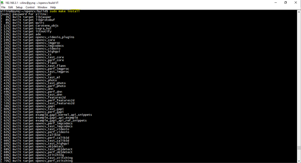

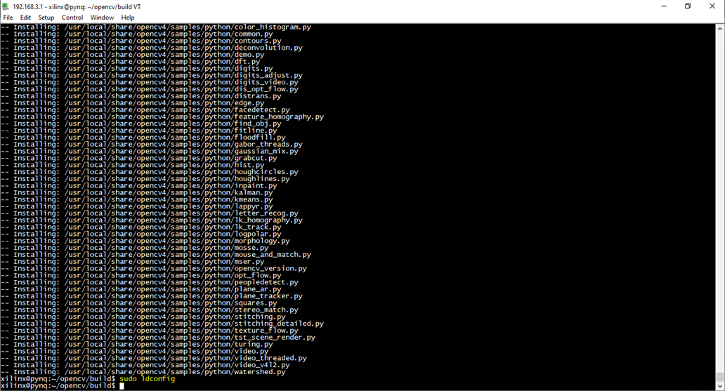

The last step is to install the newly built OpenCV 4.1.1 using the following commands:
xilinx@pynq:~$ sudo make install
xilinx@pynq:~$ sudo ldconfig
Let's check the new OpenCV version. Now it's 4.1.1 as shown below.

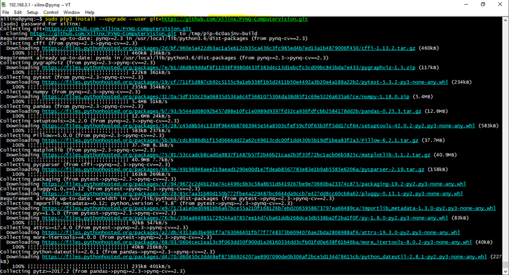

Update PYNQ Computer Vision
Using the following command to update PYNQ computer vision overlay:
xilinx@pynq:~$ sudo pip3 install --upgrade --user git+https://github.com/Xilinx/PYNQ-ComputerVision.git

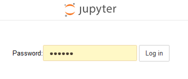

The demo software will be created in Jupter notebook. To access Jupyter Notebooks, type http://192.168.3.1:9090/  into your web browser's address bar. Log into Jupyter Notebook use password xilinx.
You can create a Jupyter notebook from the following Python code or you can upload the notebook file from the attached zip file (you need the caffe mode file and the prototxt file).

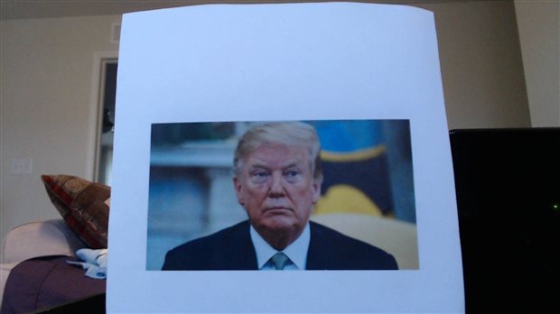

print("Learning Trump's face has completed using the picture below.")
showFrame(np.copy(frameIn))
input("Start facial recognition...")
while True:
    frameIn = readAFrame(webcamStream)
    faceFingerprint = getFaceFingerprint(frameIn)
    if faceFingerprint is None:
        continue
    for i,face_encodings in enumerate(trumpFaceFingerprints):
        if np.linalg.norm(face_encodings[0] - faceFingerprint, axis=1) < cutoff:
            print("Recognized Trump's face in the picture below.")
            break

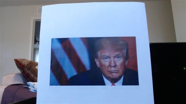

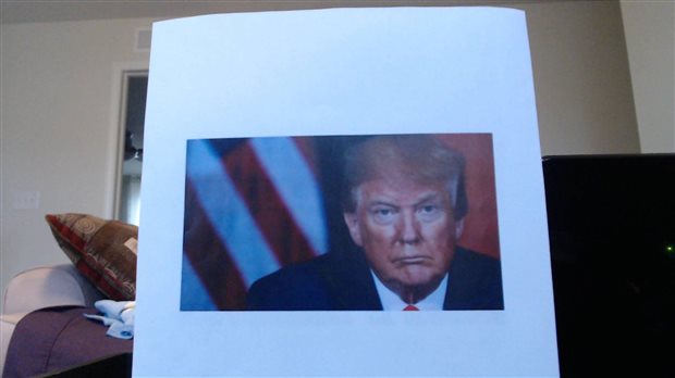

Here's the output from the above code:
Start facial recognition... Recognized Trump's face in the picture below.
