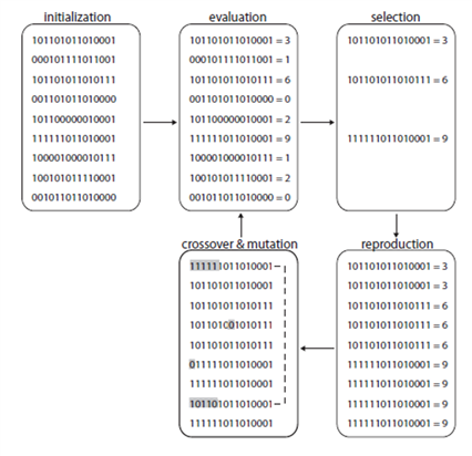

The picture below summarises the main algorithm stages.
Source: Floreano and C. Mattiussi, Bio-Inspired Artificial Intelligence: Theories, Methods and Technologies, Cambridge: MIT Press, 2008.
In short:
  1. Create a set of randomly generated solutions to your problem (Chromosomes) each consisting of a set of parameters/coefficients (Genes).
  2. Evaluate the function to be optimised using that set of parameters for each solution (Fitness Calculation). For example, we can be trying to optimise the hyperparameters for training a Neural Network as suggested here: https://towardsdatascience.com/gas-and-nns-6a41f1e8146d
  3. Select the chromosomes that allow the function to evaluate to the highest values (if the function needs to be maximised).
  4. Modify values of the randomly selected Genes (Mutation).
  5. Mix up the “fittest” chromosomes (Crossover)
  6. Evaluate again.
Steps 2-6 are normally iterated several times which represents multiple Generations.

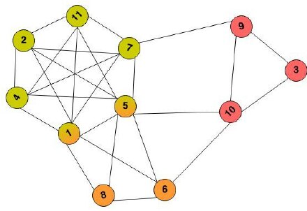

EAs became quite popular in the field Networks Analysis as they can be applied quite easily to solving Graph theory problems. This is useful for a data set with a lot of members that also has information about how those members are related or connected to each other. One interesting problem that can be solved with a GA is called Maximum Clique. It is easy to understand visually:
Source: https://www.researchgate.net/figure/Example-of-maximum-clique-problem_fig1_277198065
In the picture above, members 1, 2, 4, 5, 7 and 11 for a Maximum Clique because every member is connected to the other (each one has 5 out of 5 possible connections). Finding the biggest set like that in a very large graph is a very computationally heavy task. And this is where algorithms like GA come useful. This particular search is used quite a lot when analysing social networks, for instance.

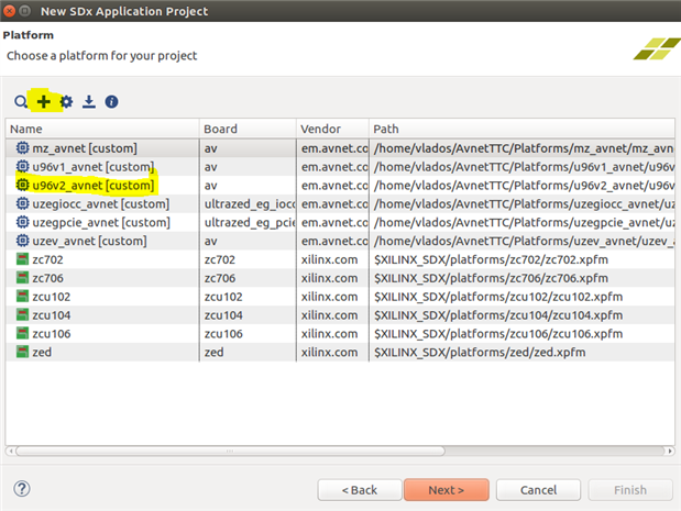

The first thing to do is to download the SDSoC files specifically for Ultra96-V2, this contains a ready Platform project, on which our Application project will be based (http://zedboard.org/support/design/28476/181). At the moment of writing, only Baremetal platform is available.
When creating an application project, you will be asked to select one of the platforms. Ultra96-V2 does not appear on the list by default, you need to add the path to the folder you downloaded which contains the required files by pressing the “Plus” icon. The list will be updated and should look as below:

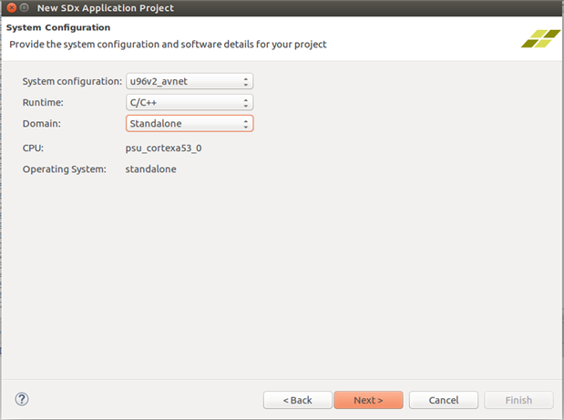

You will then end up with the following system configuration. As I mentioned earlier, only Standalone can be selected as “Domain”.

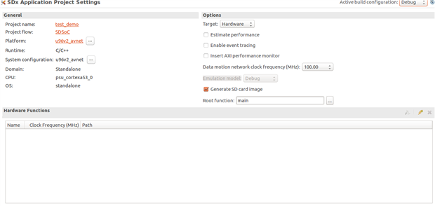

And then it is all done, your SDx project is ready! There will be a window with some settings for your project. You can also note that only one A53 CPU core seems to be available for Ultra96.

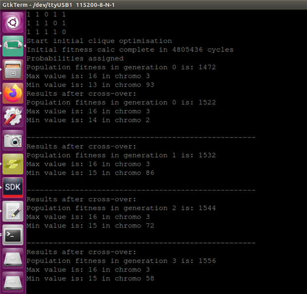

SDx generates a bootable image for the SD card by default. However, I started with launching the program in the “Debug on Hardware” mode over the JTAG adapter. And, surprisingly, it analysed the graph correctly from the first attempt and gave the expected Maximum Clique almost very quickly.
There is another useful function included in the SDS library - sds_clock_counter(). It can be used to measure the number of processor ticks to perform some operation. It took around 4.8 million cycles to perform one iteration of the algorithm.

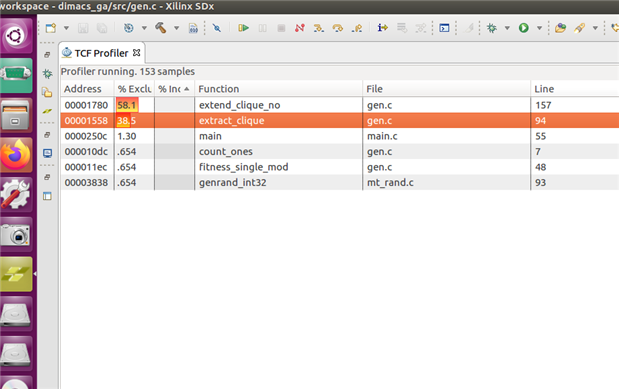

Step 4: Profiling the application
Now it is time to see in which functions the program spends most of the execution time. The recommended way to profile your code is to use a tool included in the SDx – TCF (Target Communication Framework) profiler. To access it, start a debug session as you would normally do (Debug As -> Launch on Hardware) and switch to the debug perspective. Then, click on Window -> Show View -> Other -> TCF Profiler. This will adda new window to the debug view.
I profiled my code as well. To exclude the time taken to a load the file from SD card info memory, I set a couple of breakpoints to only analyse one algorithm iteration. I also had to set the sample refresh interval to 10ms instead of default 4000ms to get some sensible data. Here are the results I obtained:
As expected, the most computationally heavy operations are extracting and then extending the Clique.
In the next post I will describe how these two functions had to be modified to be accelerated in hardware and what speed up I obtained in the end.
