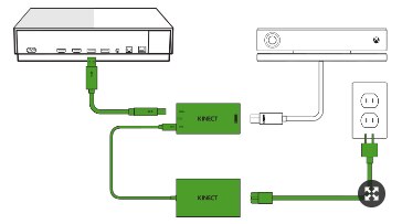

My idea for this project was to pair the capability of the Ultra96-v2 board with some pieces of external hardware, in the form of a roving, mapping robot with computer vision. One piece of external hardware is a MakeBlock Ultimate Robot Kit (https://www.makeblock.com/project/ultimate-robot-kit) which I've had for a while. It has an Arduino compatible controller and comes with a variety of peripherals which can be plugged in to the controller with RJ-11 jacks. Some of the peripherals include a Bluetooth module, a IR sensor module, sonar distance sensor module, addressable RGB-LED strip and several motors for drive and articulation of an arm and claw. The bot is powered by a pack of AA batteries. The second piece of external hardware is a 2nd generation Kinect sensor for Xbox One. The main components contained by the Kinect sensor are an RGB camera, IR projector array, and an IR camera. My plan for the project is to use the robot as a platform for the Ultra96 and the Kinect sensor, with data from the Kinect being streamed to the Ultra96 over USB, and used to map the surrounding environment, detect objects, and help the robot navigate. One shortcoming of this hardware setup is the Kinect sensor is not very portable. In order to interface over USB with something other than an Xbox (like a PC or Ultra96 board), a power and data converter brick are needed, which adds to the already bulky form factor of the Kinect sensor.
Source: https://support.xbox.com/en-US/xbox-one/accessories/kinect-adapter
The power brick plugs into A/C power and provides a 12V supply. The data brick combines the 12V power with the data from USB into a proprietary plug, which then runs to the Kinect sensor. When combined with the power brick used for the Ultra96 board, this setup got clunky very quickly. Of course, it's never ideal having a robot tethered to A/C plugs. This was just a temporary, development setup. At some point, I would like to power the whole thing off a hobby/RC battery, with one or more regulators to supply the Ultra96, Kinect and the robot kit. There are some examples of people hacking the Kinect proprietary cabling to eliminate the converter brick and supply power with a DC barrel jack. One of my future goals for the project as I revisit it later is to address all this and clean up the hardware setup.

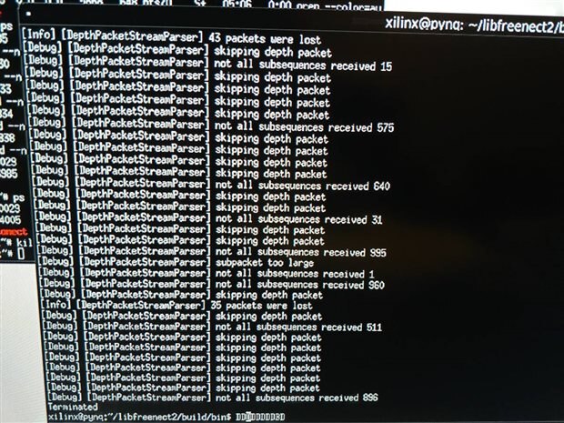

There are some open-source projects for accessing data from Xbox Kinect sensors on a non-Microsoft platform. For the original Kinect, there is "libfreenect", and for Kinect One, there is "libfreenect2". I was able to follow the setup somewhat successfully here (https://github.com/OpenKinect/libfreenect2/blob/master/README.md#linux), and run the available demos. I mostly followed instructions for Ubuntu 16.04 or "Other" where applicable, and followed the Mali instructions for OpenCL. There may be some things specific to Zynq which are required, as the demos I tried did not perform very well.
As seen in the video of the demo, the data stream had quite a bit of lag. Frame rate appeared to be no more than about 1 Hz, and there was significant delay from the time of camera input to the time of corresponding update on the display. The default demo is a program called "Protonect". When run, along with the laggy stream, I received several debug/info messages tagged "[DepthPacketStreamParser]" in the Bash terminal indicating issues with the stream, including "X packets were lost", "skipping packet depth", "not all subsequences received", "subpacket too large", and "image data too short!".
Protonect terminal messages
I decided to try another library called "pylibfreenect2" which is a Python extension for "libfreenect2". Once installed, I tried running a Python demo similar to "Protonect". The frame rate seemed to be slightly improved, maybe 1-2 Hz max, but nothing that seemed very useable. When I get time to revisit the project, I will have to see if there is anything missing from the Kinect tools library which may be needed specifically for Ultra96-v2.
