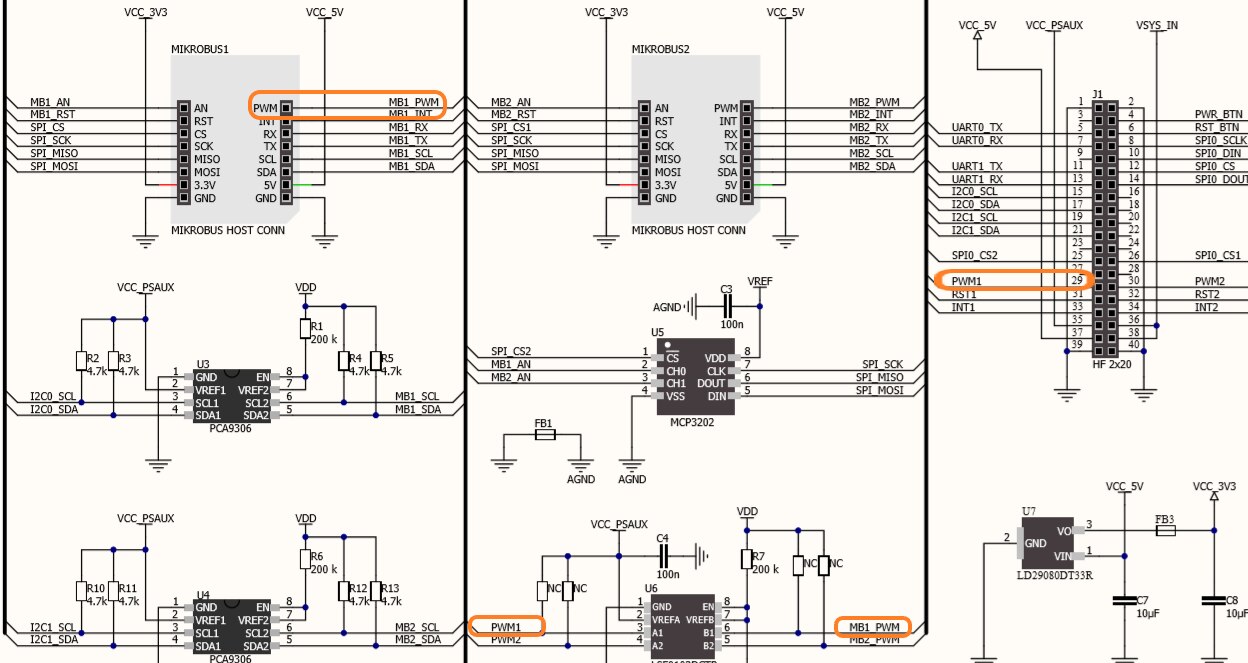

This lab required the Click Mezzanine Kit, which I did not initially have when doing this lab. Instead I simply plugged in an LED to the low speed header on the Ultra96-V2 board. I was initially unsure which pin to use for this. I worked backwards from the LCD Mini Click schematic (https://download.mikroe.com/documents/add-on-boards/click/lcd-mini/lcd-mini-click-schematic-v101.pdf) and the Click Mezzanine schematic (https://www.avnet.com/opasdata/d120001/medias/docus/197/HW_Click%20Mezzanine_v103_Output%20Files_PDF_Click%20Mezzanine_v103_Schematic.PDF) to determine the PWM signal was pin 29:
LCD Mini Click (PWM)Click Mezzanine

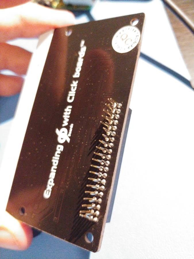

My mezzanine board was a little worse for wear when it arrived. I had to bend several pins back into place in order for it to be usable. I haven't had any issues with it, though. Good thing for that QC tag (Lol!):

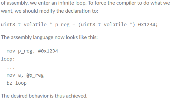

In my last blog, I wrote about an issue in SW Lab 7. Thanks to a good post by cmelement14 found here (Do Not Hide the Problem - A Correct SW Lab 7 Solution), I was able to understand what was going on.
The short of it is that an application can break during build of the release version due to compiler optimizations. The optimizer may see a variable appearing to only be assigned once, even though it may be modified externally (via ISR, hardware peripheral register, multithreading, etc). In Lab 7, build optimization created a dead loop causing the program to hang up (this was not mentioned in the material, and the solution lab even commented out the particular test causing the hang up so it would run). The variable that appears to only be assigned once gets its assignment before the loop, then enters the loop. This is shown in x86 assembler from https://barrgroup.com/Embedded-Systems/How-To/C-Volatile-Keyword. The condition for the bz instruction will never be met, since the mov happened before the loop, and the value was not 0 during the initial mov:
When the volatile keyword is used, this tells the optimizer not to optimize the variable, as it may be modified asynchronously from other sources. That creates the following x86 assembler which performs the mov inside the loop, allowing the value to continuously be checked:
