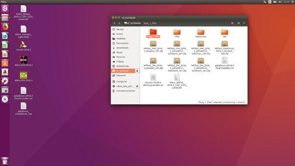

The first step was of course to set up the development environment and install the required Xilinx tools. The Avnet guide on setting up an Ubuntu VM for these purposes is probably the most extensive guide of this kind you will ever find – almost 60 pages of detailed step-by-step instructions with relevant references to external resources. All the tweaks you have to do in Ubuntu are explained properly, so you never get a feeling of blindly following a set of “black box” actions. I also decided not to deviate from the guide and proceeded with installing Ubuntu 16.04 LTS and Xilinx tools v2018.3 instead of the latest ones available (18.04 LTS and v2019.1 respectively). I wanted to make sure that my setup matches exactly the one used in the course materials to avoid any unnecessary compatibility issues.
The screenshot below shows my VM with a shared folder setup and Oracle VirtualBox Guest Additions mounted correctly.

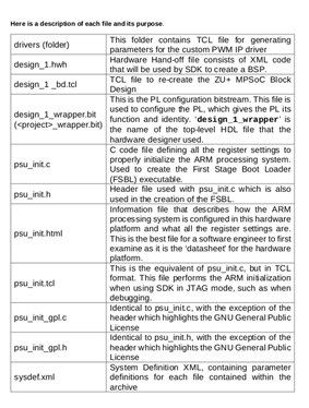

The first 3 Software module labs give a good overview of the Xilinx SDK and how it links to the Hardware platform. I have through the process of exporting hardware platform generated in Vivado to the SDK before in my university courses. However, I have never really paid attention to what the internals of the exported archive file are (this is the file with .hdf extension). Therefore, I found it very useful that the purpose of each component is explained clearly (see screenshot below).

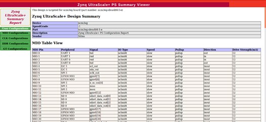

Tutorials give you a lot of pointers to the information on the drivers and IP blocks that are included in the hardware platform. It also forces you to use the documentation efficiently and allows you to explore multiple options to do so. For example, I found the hardware report generated from psu_init.html file handy.
