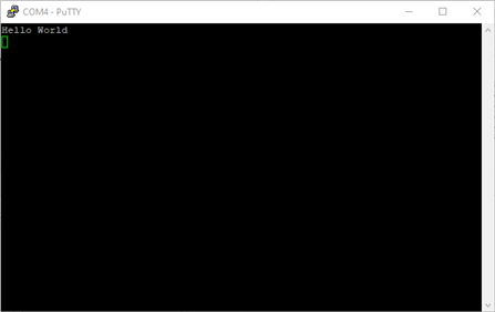

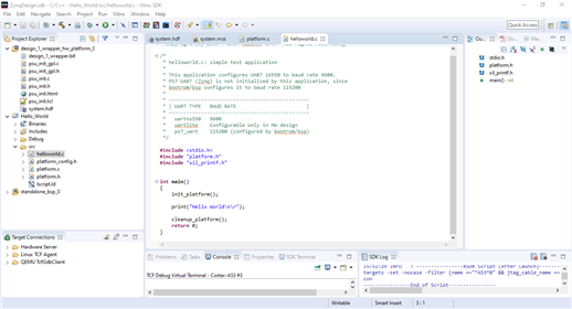

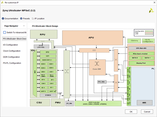

HW Lab 2 - PS Configuration Part 1 - HelloWorld
In this lab, we:
  • enabled and mapped a PS UART to the MIO
  • configured the clocks and DRAM controller
  • exported the design to Xilinx SDK
  • Created a BSP & Hello World application, which was executed.

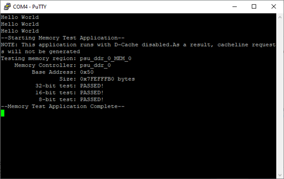

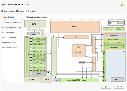

HW Lab 3 - PS Configuration Part 2 - MIO Peripherals
  • Enabled a bunch of MIO peripherals: SPI, UART, SD, USB etc.
  • Configured various clocks (sources, PLL settings etc.)
  • Ran the Hello World & Memory Test applications

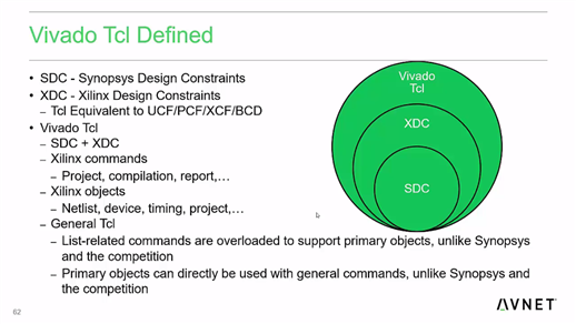

HW Chapter 4 video: The Power of Tcl
  • An introduction to Tcl
  • The benefits of XDC & Tcl
  • Scripting in Vivado using Tcl
