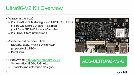

Petalinux Chapter 1 video: Overview, Review of Ultra96 Kit, PetaLinux Overview
  • An overview of what's bundled with the Ultra96.
  • What else we need: power supply, debugger, mezzanine board etc.

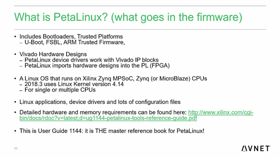

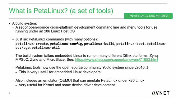

  • An Introduction to Petalinux - a collection of tools for building Linux for Zynq on x86.
  • How Petalinux works with other Xilinx tools (Vivado, SDSoC & SDK).
  • Petalinux on Zynq MPSoC - how it works with the bootloader, programs the PL etc.

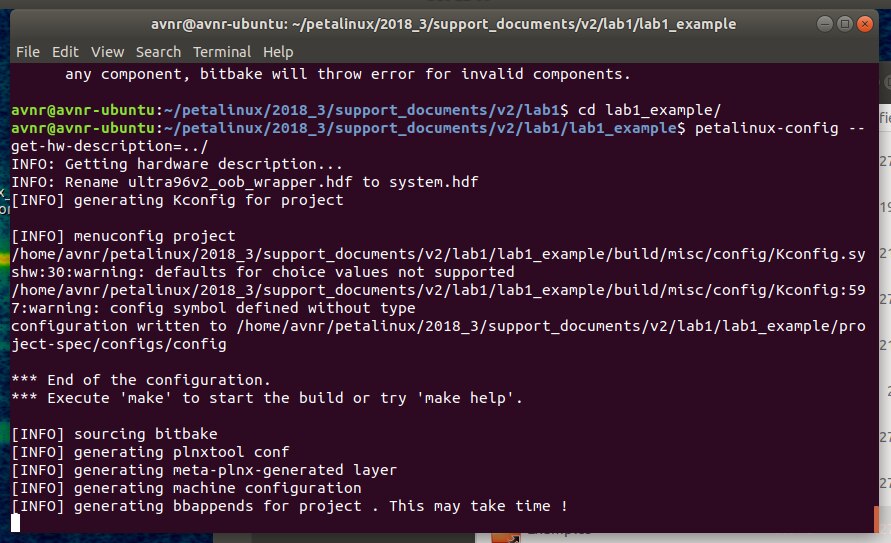

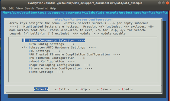

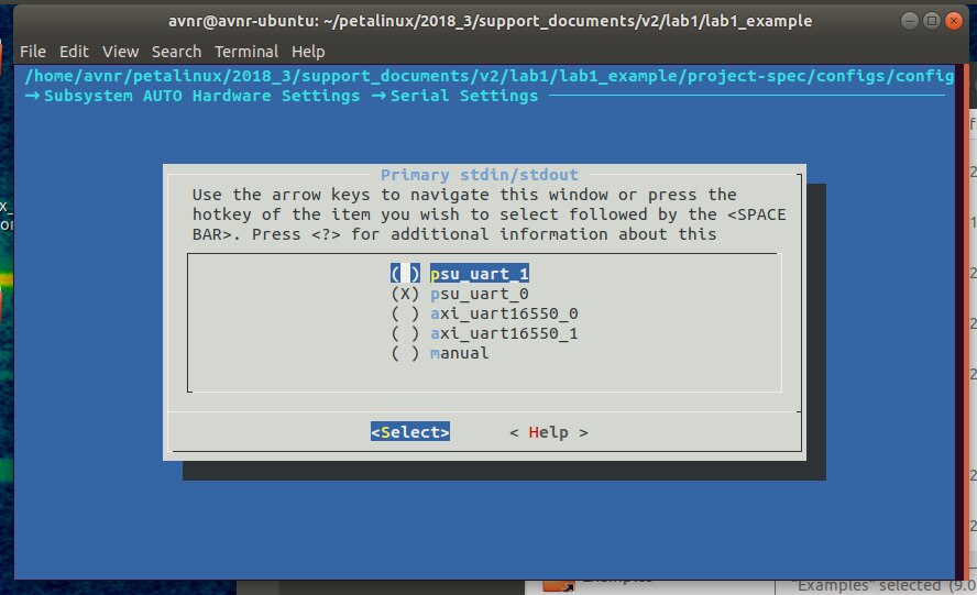

  • The PetaLinux environment was setup in a pre-lab - this was a pretty lengthy process & involved entering quite a few commands in the terminal.
  • Lab 1 was to create, configure & build a minimal PetaLinux - this used 2 commands which were entered into the Linux terminal, where the PetaLinux configuration also gets displayed. The configuration used the defaults, except for the primary stdin/stdout which was changed to ps_uart_1 due to how things are connected on the Ultra96.
  • According to the lab document, the kernel configuration takes around 10 minutes, and the PetaLinux build takes another 40. There was an option to use the bundled pre-built files, so I went with that.
  • The generated files need to be copied over to the SD card. Boot & rootfs partitions need to be created on the SD card, which need to be formatted as FAT32 & EXT4 respectively.

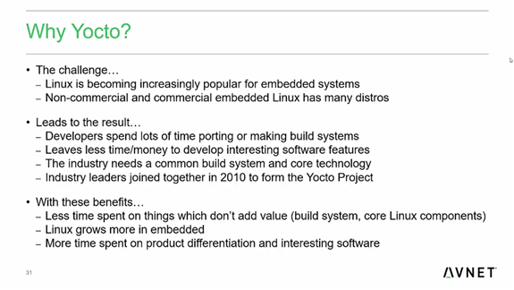

  • An intro to the Yocto project - how the build system reduces complexity & makes building Linux easier.
  • A Yocto crash course - how things are structured, how files are fetched.
  • How Petalinux & Yocto work together.

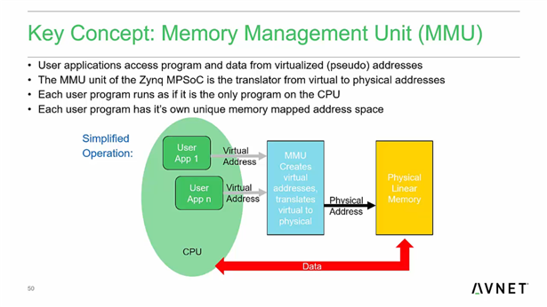

  • The importance of the memory management unit when it comes to running user applications & how addressing is handled.
  • Advantages & disadvantages of using the MMU to isolate/abstract hardware/memory from the user application.

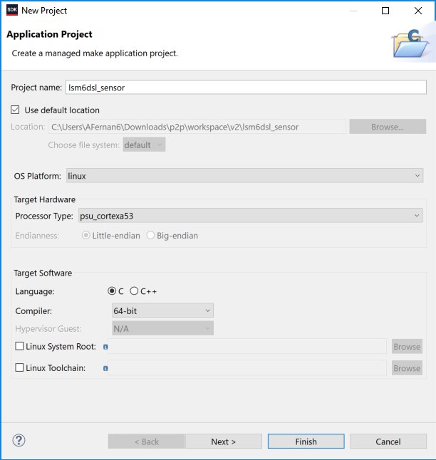

PetaLinux Lab 4 - Creating PetaLinux Applications using Xilinx SDK

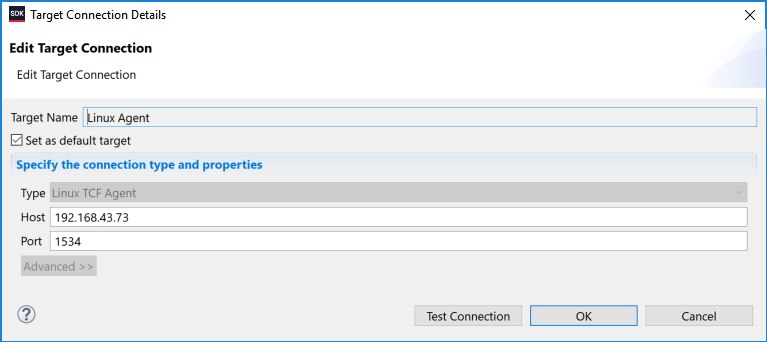

  • Created a new Xilinx SDK project. The process was the same was the same as previous projects, except that this time, 'linux' was selected as the 'OS Platform', and 'psu_cortexa53' was the 'Processor Type'.
  • The Linux TCF agent is used to debug the application - setting this up required entering the IP address of the Ultra96v2.
  • The debug session was launched as usual, but ending a debug session requires selecting the 'Terminate & Remove' as an extra step.
