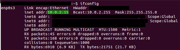

The VM instructions were thorough and detailed for the most part; however, there were a few items which weren't explicitly stated. In the network bridging section it said to select "Bridged Adapter" in order to connect the VM to the Internet via my computer's network hardware. If a new IP address was not assigned, it said to restart the Ethernet service. There are a few ways to check the IP address. One is to use the Ubuntu GUI and navigate to network settings. Another method is to open a terminal and use the ifconfig command. As seen in Fig 1, this showed a non-standard IP address before applying the "Bridged Adapter" setting.
Fig 1
After applying the "Bridged Adapter" setting, a more standard default IP address was assigned, as seen in Fig 2.
Fig 2

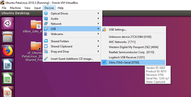

When installing the GTK terminal and selecting the USB-UART device to use, the instructions showed a device called "Digilent USB Device". The JTAG programming card included in this training program showed up as "Xilinx JTAG+ Serial" for me, as seen in Fig 3.
Fig 3

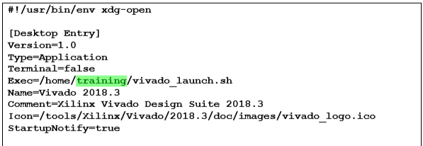

It was mostly smooth sailing from there. One final "gotcha" was forgetting to change the name "training" to my VM username when setting up the Desktop links to launch all the Xilinx tools, as seen in FIg 4. It was a simple fix to get the links working and everything seems to be installed correctly now.
Fig 4
