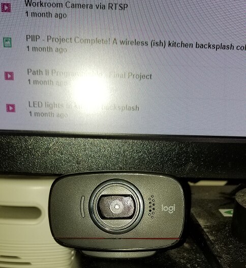

There are a few LPR algorithms available out there and most are open source. One of the most popular ones is OpenALPR. However I found that during a Xilinx PYNQ Hackaton in 2017 an LPR algorithm was created for PYNQ ( https://github.com/Xilinx/PYNQ_Hackathon/tree/master/teams/team_lynx/OpenCV/License%20Plate%20Recognition ). There was no need to re-invent the wheel. I purchased a Logitech HD C525 webcam.

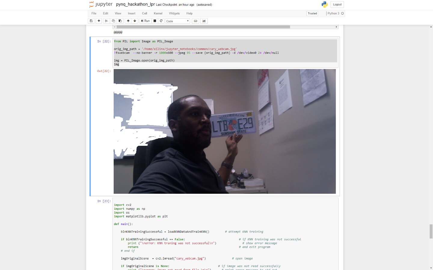

Therefore, I modified some exiting jupyter notebook code used for webcam capture to capture images and save to a location for analysis by the LPR algorithm.
from PIL import Image as PIL_Image
orig_img_path = '/home/xilinx/jupyter_notebooks/common/cary_webcam.jpg'
!fswebcam  --no-banner -r 1000x600 --jpeg 95 --save {orig_img_path} -d /dev/video0 2> /dev/null
img = PIL_Image.open(orig_img_path)
I set the resolution to 1000x600 and the image quality because the C525 image quality was less than expected.

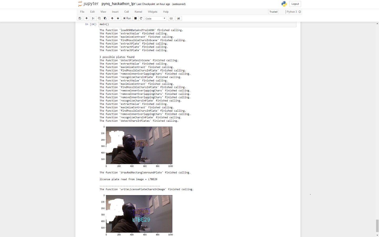

The jupyter code takes about a minute to run but works like a charm. I used an old Florida License plate I have and it was able to decipher the plate number: LTB E29
