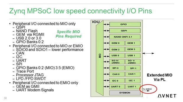

The first 3 lectures provided an overview of the hardware - the Zynq MPSoC Processor and its peripherals.  Other lectures cover the memory system and the interconnect between the Processing System (PS) and the Programmable Logic (PL) and the peripherals using the Advanced eXtensible Interface (AXI).  I have to admit that after a couple of weeks that my head feels like it is about to explode with all these acronyms image.  After a while I guess it will just seem natural.  The array of hardware options is amazing.  One of the main issues is making sure that you can utilize a given set of hardware options without violating any interconnect or memory constraints.  A simple example is that there are a fixed set of external IO pins and they are divided into high performance and low performance categories and there are pins dedicated to the PS (Muxed IO - MIO) and to the PL (Extended Muxed IO - EMIO).
Here is a slide showing restrictions on low speed IO connectivity.  Certain peripherals can only connect to MIO and in some cases only on specific pins.
The good news the design tools will prevent you from making errors, the bad news is that until you get familiar with the constraints you could end up planning unworkable designs.

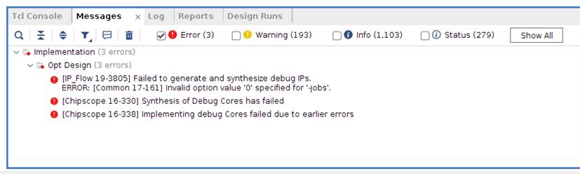

There was a lecture about using Xilinx IP or even your own custom IP (Intellectual Property refers to preconfigured logic functions that can be used in your PL design).  In the lab a custom IP was built and deployed to the hardware.  It is nice that this process is reasonably straightforward.  It allows the ability to conveniently reuse your own designs.  This was a lab that caused me an issue when I was trying to generate the bitstream for the design with the included IP.
This error happened after the synthesis step when the implementation was being optimized.  It appears that this error is caused by a version mismatch between the version of Ubuntu that I was using and the 2018_3 versions of the Xilinx tools.  Adam Taylor told me that the 2018_3 tools are compatible with Ubuntu 16.04.3 and 16.04.4.  I am using Ubuntu 16.04.6.  I have seen complaints in the forum with the same issue using 16.04.5.  Somewhat amusing because I took care to use 16.04 and 2018_3 rather than 18.04/10 and 2019_1 to insure that I wouldn't have problems with this course.  I did not realize that I needed to watch for the minor version also.
