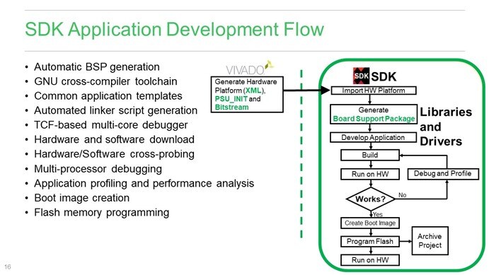

This diagram shows the handoff of the hardware design from Vivado to the SDK:
The full hardware design including the bitstream are exported from Vivado using an HDF (Hardware Design File *.hdf).  This is the only file required to handoff the design to software.  The HDF is an archive containing the complete Hardware Platform Definition (XML, PSU_INIT, and Bitstream).  This file is then imported into the SDK.

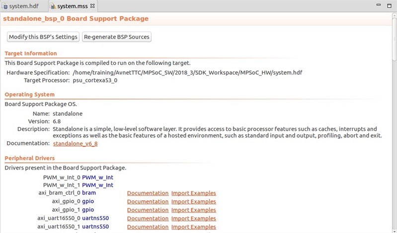

The device drivers that are included in a BSP are viewable in the system.mss file (MSS -> Microprocessor Software Specification) as shown below:
The feature of the MSS that I think is really helpful is that documentation and example links are included for each driver.

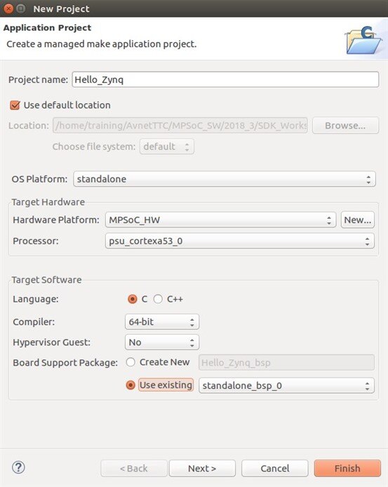

When creating an application you get to specify the hardware platform, the software language, and the BSP (HW configuration) used:

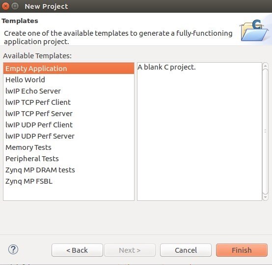

Another feature that is helpful is that code templates are available for new applications so that you can get started quickly with example code that can be customized.

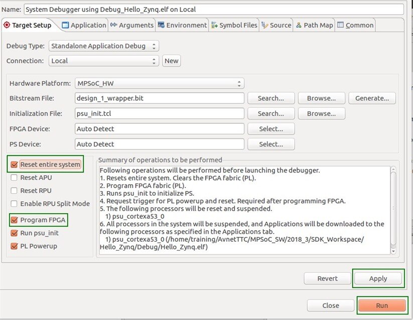

Lab 5 used the system debugger to load and run the applications using the JTAG/UART connection:
The debugger panel allows you reset the board and program it as shown below.

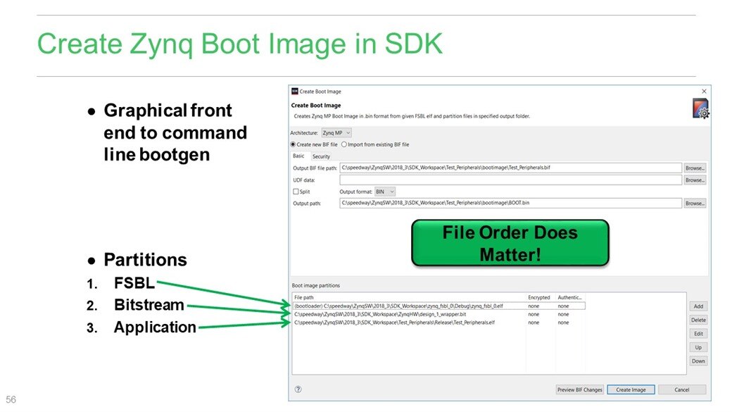

Labs 6 and 7 demonstrated building and running a Zynq Boot Image from the SD card.  In this case we are just running a standalone application so there are only 3 boot partitions required as shown: the first stage bootloader (FSBL) which is loaded into the on chip memory (OCM), the PL bitstream, and the application program.  If we were loading and running with an OS, a second stage boot program would be required (U-Boot).
