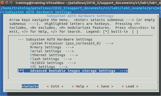

Experiment 1: Create, Configure and Build Minimal PetaLinux
  This experiment used the 3 commands petalinux-create, petalinux-config, and petalinux-build to develop a minimal Ultra96 PetaLinux image (missing devices like WiFI and Bluetooth).
  The petalinux-config gets the hardware description (in this case the HDF archive) and opens a configuration editor to allow modifying kernal settings such as device settings and boot media.
   We configure it to boot from the SD card and select the correct UART to interface through the JTAG/UART pod and the we exit and build the configuration from the command line.

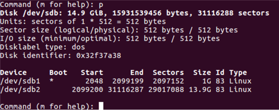

   The SD card needs to be set up in in a very specific configuration.  It needs 2 partitions, a BOOT partition for the boot files and a ROOT partition for the root file system.  This is accomplished using the fdisk command.
   One thing that I did not realize is that Xilinx requires that the boot partition be formatted as FAT32.  The root file system partition is required by Linux to formatted as EXT4.
   Once the partitions are formatted, we copy the files generated by the build process into the appropriate partitions.  And then run sync to flush the VM cache to write the files to the SD card.
