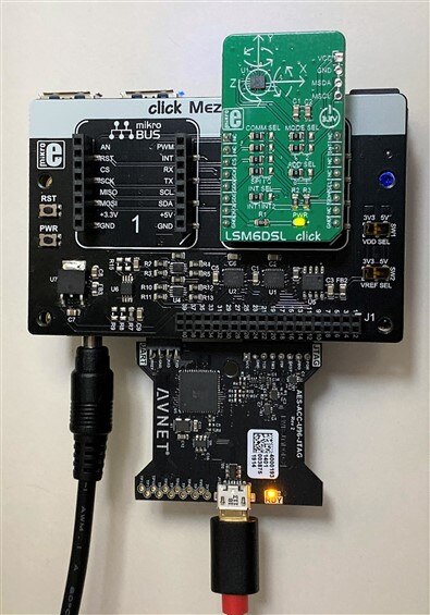

The labs use the temperature sensor on LSM6DSL Click which is interfaced using SPI.  Below is the LSM6DSL Click on the Mezzanine board mounted on the Ultra96.
