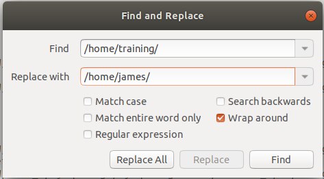

I did run into one (expected) problem since I was running out of the /home/james/ directory instead of the /home/training/ folder as per the instructions in lab 00.
I had some errors with the script then I remembered that I should have checked for this. I did a find/replace in the tcl script, but my project was already too buggered to recover. Thankfully, we are provided with the finished labs for each lesson so that we can easily start from a known good configuration. It is especially useful since there is so much that can go wrong with so many settings and sub-menus. If I missed some timing setting or PLL/clock domain and nothing worked, it would be much faster to start from a known good instead of troubleshooting (although I did try for a little while before throwing in the towel).
And the note below from the student lessons give me the go-ahead (in no uncertain terms) that the best course of action is remove & replace.
