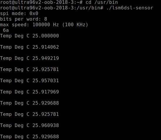

Lab 06 - Baking custom software into the kernel
This lab was very similar to Lab 05, but instead of running from Ram, we bake the program right into the kernel of the Ultra96. This will make it retain across power cycles.
There was a lot of manual editing in multiple file locations to get this set up. It seemed a lot more complicated to me than what we learned in the SDK lessons. Portions of the setup are spread across various textual config files and setup utilities.
Once the image is loaded, we can launch the application via command line with  "./lsm6dsl-sensor" and the values are read out onto the console.
