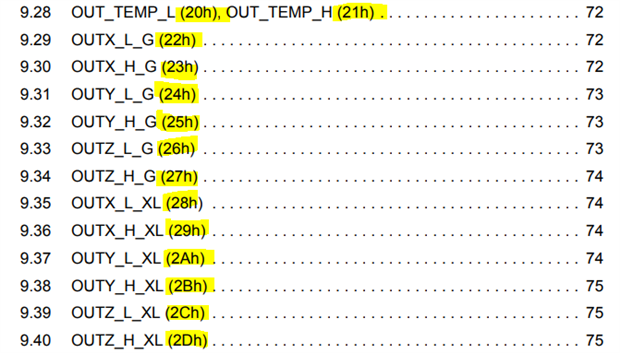

I started by expanding on the 'sensor interface' program that we worked with on various lessons to read more than just the temperature data. This alone ended up being a little more involved than I first figured it would be. This was all done in SDK without using the Petalinux setup; which was the ultimate goal; but the idea was to start simple then build it into a bigger project.
The simple thing was to expand the int array for the TX buffer and RX buffer sent to the accelerometer/gyro to be 15 bytes long instead of just 3 bytes so that we could read all the required values.

Then, I tried sending the longer request string of data over the SPI port, but kept getting zeros back. See code sample below.
        XSpiPs_SetSlaveSelect( & SpiInstance, 0x01);
        XSpiPs_PolledTransfer( & SpiInstance, cmd, rx, 15); // This didn't work (by itself)
        XSpiPs_SetSlaveSelect( & SpiInstance, 0x00);
Line 2 above from the sample code does a 'write --> read' on the SPI bus using the write buffer "cmd" and a read buffer 'rx', with a length of 15 bytes (1 as a 'command' byte and 14 'payload' bytes). I was thinking that this would work since the memory locations of the accelerometer and gyroscope readings are adjacent to the temperature location. (datasheet is located here)

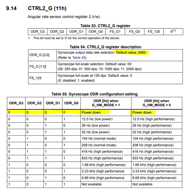

However, after some futzing around and getting zeros back instead of real data, I came to the realization that I was just getting zeros for the gyroscope in locations 22h and 23h which was the first one that I tried to use. I had to RTFM for a little while and I realized that only the accelerometer was configured as per the sample code, and not the gyroscope:

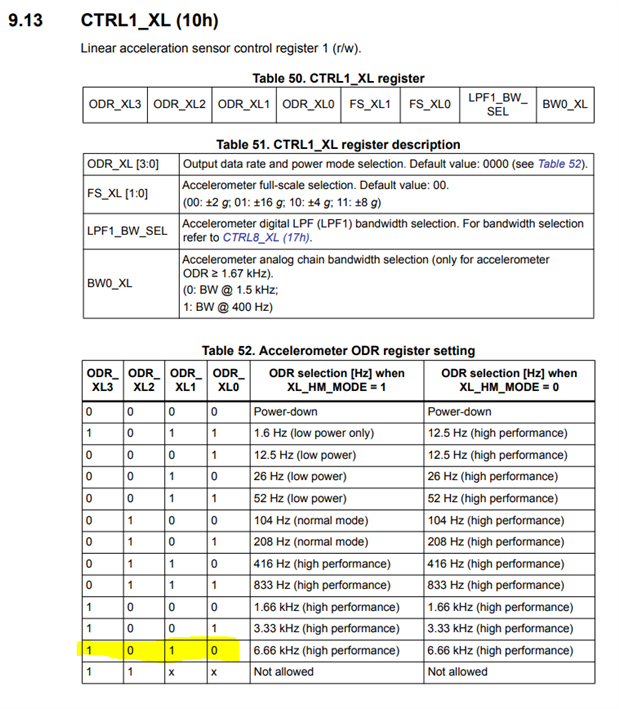

//started as:
    cmd[0] = (u8) 0x10;
    cmd[1] = (u8) 0xA0;
    XSpiPs_PolledTransfer( & SpiInstance, cmd, rx, 2);
// this became:
    cmd[0] = (u8) 0x10;
    cmd[1] = (u8) 0xA0; //JO This enables the Accel (Linear Acceleration)
    cmd[2] = (u8) 0xA0; //JO Added this to enable the Gyroscope
    XSpiPs_PolledTransfer( & SpiInstance, cmd, rx, 3);
This code snip writes the value A0 to memory location 0x10h; which configures the accelerometer to run at 6.66 kHz as per the manual.
That meant that the gyroscope was disabled. To enable it, I wrote out "A0" to memory location 0x11H so that it would run at 6.66 kHz as well.

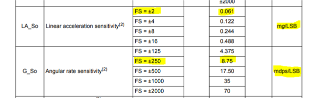

Once I had some actual values coming in, I had to convert them to real world numbers. The datasheet shows the conversions based on the settings (i.e. sensitivity range) for the data.
So then I take the output value from the conversion method and scale it according to the data sheet.
        Gyro_X = Convert_Value(rx[3], rx[4]);
        Gyro_Y = Convert_Value(rx[5], rx[6]);
        Gyro_Z = Convert_Value(rx[7], rx[8]);
        Accl_X = Convert_Value(rx[9], rx[10]);
        Accl_Y = Convert_Value(rx[11], rx[12]);
        Accl_Z = Convert_Value(rx[13], rx[14]);
        float LA = 0.061; //linear acceleration (Accelerometer) sensitivity in mG/LSB
        float AX = Accl_X * LA /1000;
        float AY = Accl_Y * LA /1000;
        float AZ = Accl_Z * LA /1000;
        float GSensitivity = 8.75; // G's offset calibration
        float gX = Gyro_X * GSensitivity /1000;
        float gY = Gyro_Y * GSensitivity /1000;
        float gZ = Gyro_Z * GSensitivity /1000;

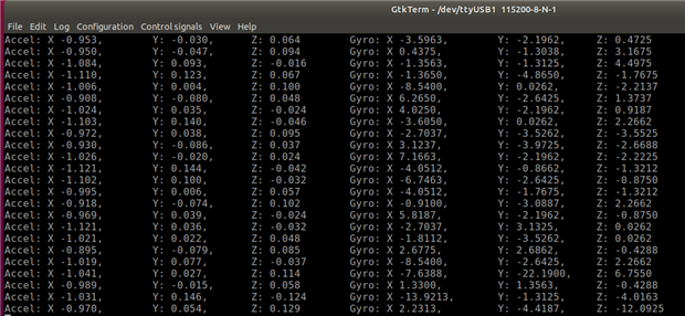

Here is a snip showing the reading coming in, converted, then printed to the serial port. The Ultra96 was sitting still on the desk, but up on its side; which is why the Z is about at zero and X is around 1G.
