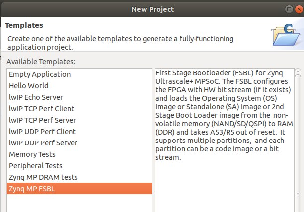

Lab 06 - First Stage Bootloader
In this lab, we create the First Stage Bootloader (FSBL). This is needed as a first step to running our application as stand-alone on the Ultra96 as stand-alone, instead of launching over JTAG. We learned a lot about the boot sequence inside of the MPSoC, which suppots many nice features such as secure booting, and booting from a selection of devices such as JTAG, QSPI, NAND, SD, and eMMC.
For the lab, all we really had to do was create a new 'project template' and choose First Stage Bootloader from within SDK. Then SDK takes care of the rest for us and builds it.

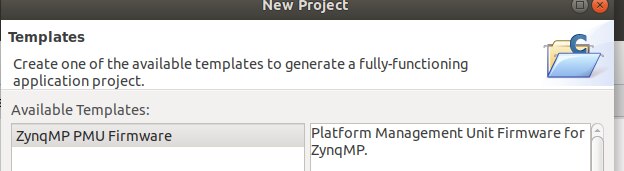

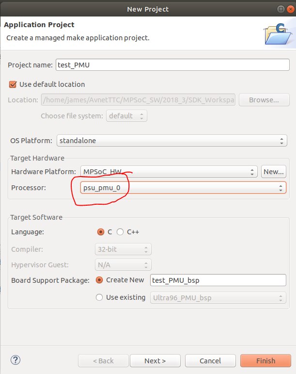

We also had to create a PMU file - Platform Management Unit - to run after the FSBL and before our application. This was done in a similar manner as above where we add a new 'application project' and change the processor dropdown to "psu_pmu_0".
From the lab, we learn what the PMU is responsible for:
The PMU performs the following set of tasks.
• Initialization of the system prior to boot.
• Power management.
• Software test library execution (optional).
• System error handling.

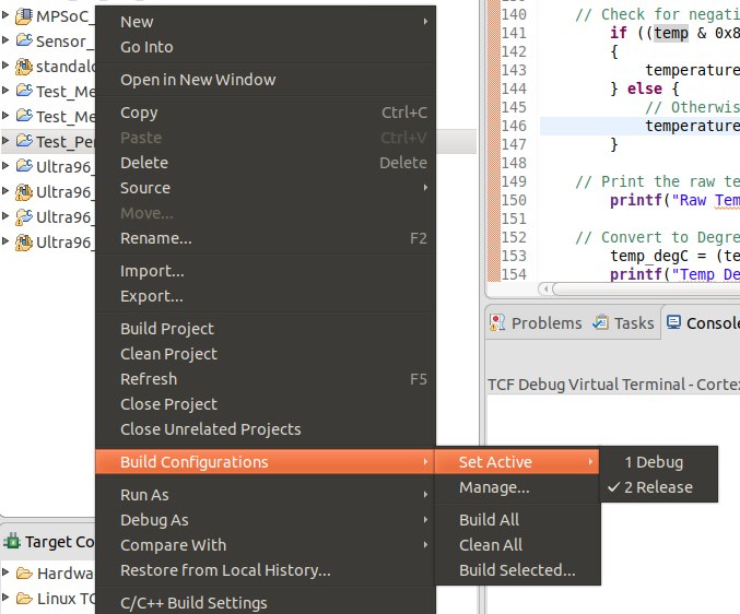

In this lab, we take the FSBL and PMU along with our bitstream and our application and create a .bin file. This gets loaded on the SD Card, and we are finally able to put that in the Ultra96, power it up, and it will start on its own and run the program. This means that it can now run 'untethered' from the computer. The .bin file is the boot image. We tell the Ultra96 to boot from SD via the DIP switch on the board and it finds the .bin file and executes it.
We also change the build version from "debug" to "release". This does cause an issue with one of the interrupt tests as myself and others noticed. Charles Mao outlined in this blog post, there is an issue with how the test was coded, and how the SDK interprets the debug levels differently from Debug to Release.
The Ultra96 has an integrated cooling fan, and it is software controlled. This means that it can sometimes turn off, and that definitely happens during this test. The sad thing is that the coding issue causes the application to hang, and fan has turned off. The result is that the board heats up considerably while I am troubleshooting.

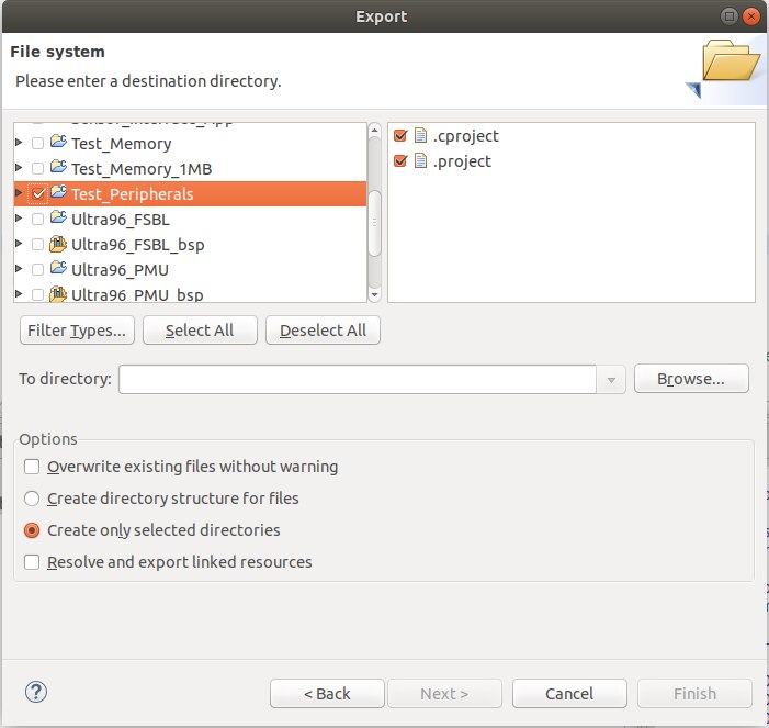

Lab 08 - Importing and exporting
In this lab, we discuss how to import and export hardware and settings. Most is done via File-->Export and File --> Import.
We learn that we can't simply copy and paste the directories because things won't build properly.
We are able to export our system debugger settings, breakpoints, and software repositories including drivers and libraries and custom BSPs.

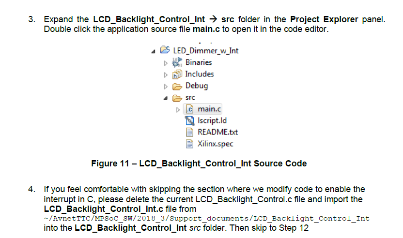

In the lab, we use the LCD Dimmer application that we started with in the Software labs. We actually create it from scratch in this lab, but the program ends up being the same. We start with a program that doesn't have the interrupt, then we manually add it to the code.
I noticed that there was an incorrect screenshot in this lesson, which I think was a hold-over from the MiniZed training course that this training seems based on.
The screenshot shows the "LED Dimmer" application instead of "LCD Dimmer". That was definitely the app we created for the MiniZed since we didn't have any expansion cards for it.

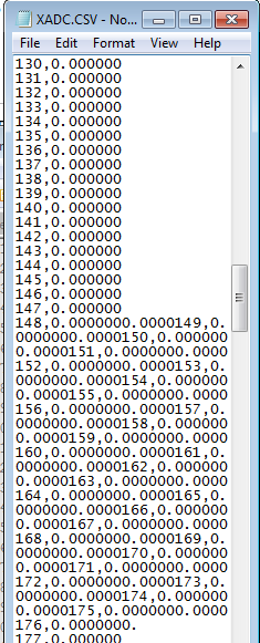

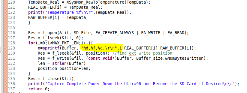

Lab 10 - File System
In this lab, we learn about the Xilinx included libraries; and specifically about the xilffs - Xilinx FAT file system library. We read in temeprature values and write them out to a CSV file on the SD Card.
The CSV file ended up very messy. It looks like the \r\n (carriage return / new line) don't work properly in the code, and somehow I got a lot of zeros instead of actual readings.
