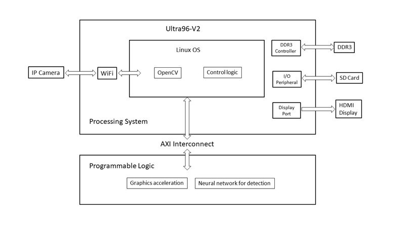

Having completed the 3 Avnet Ultra96 courses in the Path II Programmable training, it's now time to move on to creating a project with what we have learned.  I know what I would like to do conceptually but I doubt that I can successfully implement it in the 5 week time frame we have for  the project.  Even though there are a wealth of examples in the Xilinx ecosystem, one thing I definitely learned from the courses are that there are huge issues with hardware and software version incompatibilities.  That is to say that for a novice like myself that it will take a lot of time to figure out how to make things actually work.
At a high level of abstraction, I'd like to implement an embedded vision system.  The input would be a H264/5 video stream from an IP camera or an NVR.  The input would be an RTSP stream over the network (either wifi or ethernet).  If I can get the base configuration working I'd like to extend it to multiple inputs and possibly an output to the NVR.  I'd like to have some level of detection/identification capability.  My thought is to use one of the quantized neural network implementations that I've tried on the PYNQ-Z2 (new overlays are available for the Ultra96).  I thought that I could do the video decoding and encoding in the FPGA but the Ultra96 does not have a VCU (only the EV chips have one).  I'm planning to use OpenCV for the video processing and there is an xfOpenCV library that accelerates many of the functions using the PL.  The SDSoC tool is supposed to provide the capability for software/hardware function optimization but we did not cover that tool in the course.   So, I'm struggling to figure out how to approach this.  There are many examples available but many were developed with earlier tool versions and many are for the Ultra96-V1.
How to partition and connect the design is the first challenge and then to make it work.  Obviously the XIlinx and Avnet folk have done much more complex designs image.
I decided that I would try to break the problem into smaller pieces and try to verify that individual functions/components work before I try to integrate them.  There are a lot of capabilities of the Ultra96 that I haven't tried (that's quite an understatement).

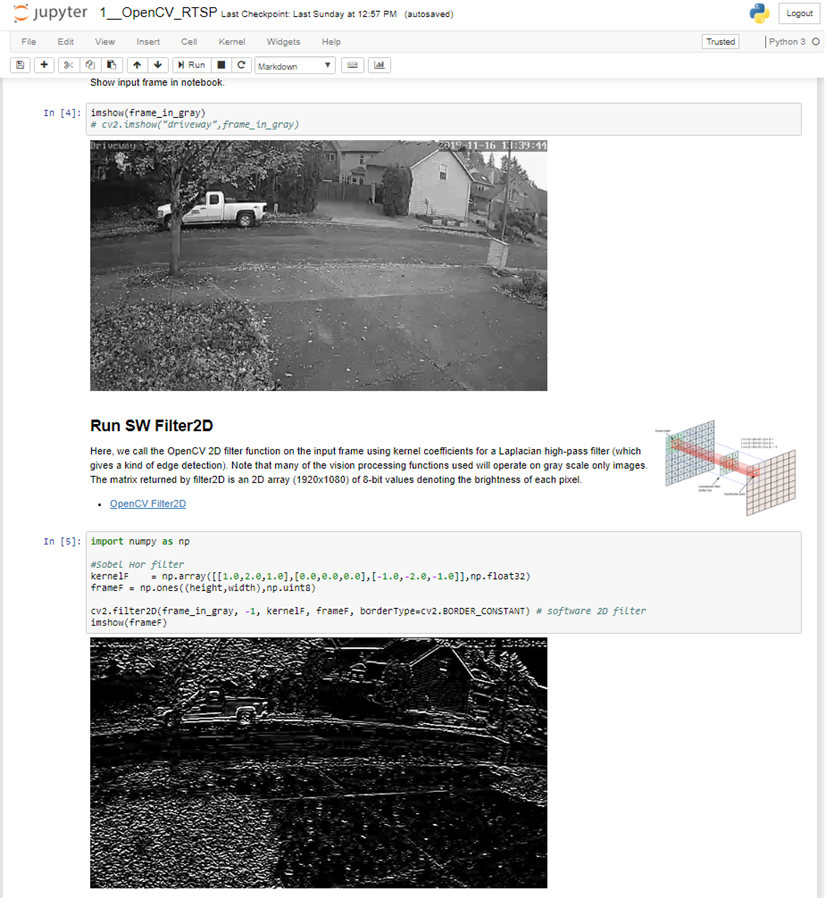

The Jupyter notebooks that are provided in the ComputerVision repository use a webcam as the image source but it was reasonably straightforward to replace it with the RTSP stream.  One thing that is somewhat tricky is that even though there are only a few hardware OEMs for the IP cameras, the vendors seem to try to differentiate their products with firmware so there is no standard syntax for the camera servers.  Luckily most vendors provide API documentation but I have to use multiple formats to capture streams from the various cameras that I have.  ONVIF is supposed to solve that problem but I don't think many cameras are fully compliant.  The camera that I tried is an FDT 7903 which streams on port 554 and requires user and password authentication.
Here's the code changes required to go from webcam to ipcam:  Image width and height are required for later processing
Setup and configure USB camera
import cv2
camera = cv2.VideoCapture(0)
width = 1920
height = 1080
camera.set(cv2.CAP_PROP_FRAME_WIDTH,width)
camera.set(cv2.CAP_PROP_FRAME_HEIGHT,height)
Setup and configure RTSP capture
import cv2
camera = cv2.VideoCapture('rtsp://user:pw@ipaddr:554/12')
if camera.isOpened():
    width =  int(camera.get(cv2.CAP_PROP_FRAME_WIDTH))   # float cast to int
    height = int(camera.get(cv2.CAP_PROP_FRAME_HEIGHT))  # float cast to int
    print('width, height:', width, height)
Here is a capture from my driveway camera with subsequent Filter2D processing:
