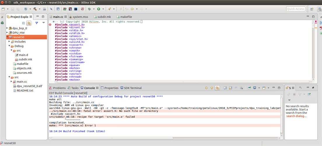

The real problem that I had was trying to regenerate the application software using the SDK.  The process is again straightforward but I was having problems with the compiler not finding either include files or library files.  As shown below, it can't find the assert.h file even though it was definitely in the proper location (compile stops on the first fatal error).
This problem had me stymied for a while thinking that I had the incorrect path specified for the files.  It finally occurred to me that I might be having a problem because the path was very deep (long path name).  This was a long shot but I tried relocating the directories and it fixed the problem I was having for the resnet50 program.
When this example installs it is using the following file tree (dpu_integration_lab is my project directory).  I had this tree installed under /home/training/petalinux/2018_3/PIIPprojects.  I ended up moving the project directory into my home directory.

It doesn't seem like the length of the path should be an issue.  I don't know if this is a side effect of running in a VM on Windows?  Anyway I was able to build a new resnet50.elf.
Building the face_detection program was a much larger problem in that there were many files missing from the SDK, all of them associated with 32 bit structures.  E.G. there was a endian-64.h but no endian-32.h in /usr/include/bits.  Have not figured this out yet.  Maybe there is a version mismatch between the SDK files and the source files.  Fortunately there was a face_detection.elf that was provided and I was able to run that using the new hardware files that I had generated.
