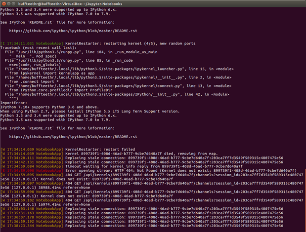

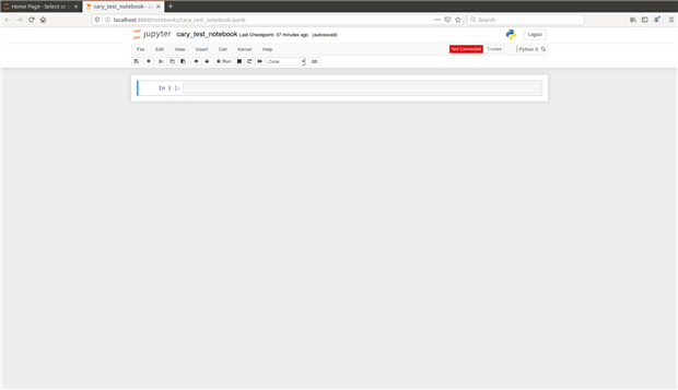

I have PYNQ running on my board. I am going through the process of learning the Jupyter Notebook and brushing up on my Python. Since I want the flexibility of working on my notebook code anywhere without my board I decided to install Jupyter on my Ubuntu 16 VM install.
It works but I am have a problem with the Kernel stability on Ubuntu.
It keeps restarting. I had some issue with the pip and ipython versions when I was installing everything so I am looking into that as to maybe the source of my issues.

    I fixed my kernel restart issue in Jupyter on Ubuntu. It turns out I was using python 2.7. I has to update to Python 3.6 and the latest version of pip. It took some doing becuase the newer versions are "not" supported in the Ubuntu version Iam using which is 16.04 LTS. I had to use repository ppa:deadsnakes/ppa.
