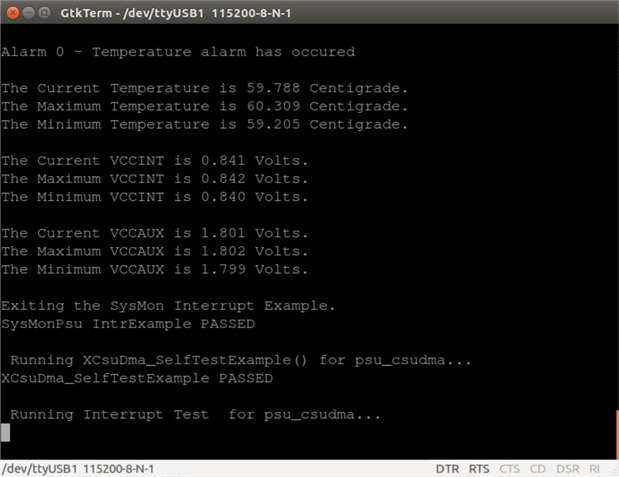

System hanging in Lab 7
I found that the system hung when I ran the Test_Peripherals application when booting from the SD Card. I ran the application multiple times and the hang always occurred during the psu_csudma test, the serial output is shown below.
This is especially interesting because I successfully ran this application in Lab 5, so the issue is likely to do with the change in boot method changing how something is configured. I haven’t looked into this issue to try and identify and resolve it since I was keen to get on to the PetaLinux modules.
