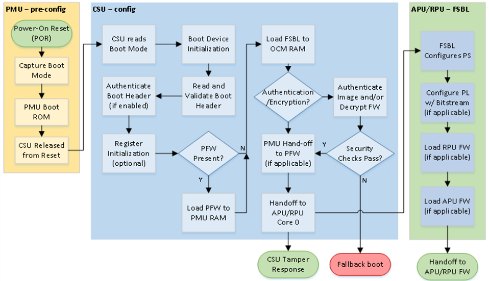

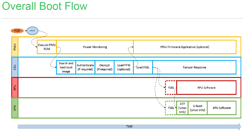

SW Lab 6 - Zynq UltraScale+ MPSoC Boot Process
SW lab 6 & 7 are about the boot process for Zynq UltraScale+ MPSoC devices. It is the most complicated boot process I have encountered so far. The following two screenshots show the complete boot flow including both secure and non-secure boot. Both labs only involves non-secure boot. Maybe later when I get some time, I'll try secure boot option (usually we need to separately request device's security reference manual from its vendor).
One thing worth to mention when create SD boot image is the list sequence of included input files:
1. FSBL
2. PMU Firmware
3. Hardware Bitstream
4. Application Software
