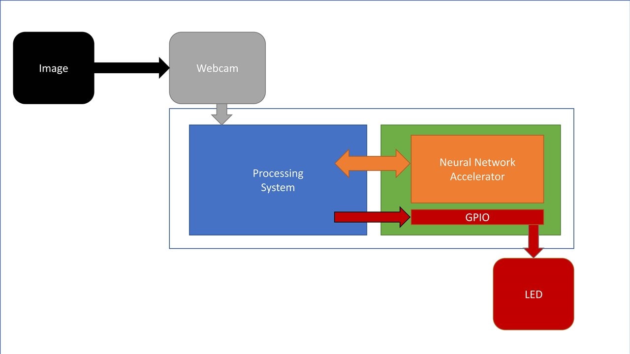

1. Introduction
This final project deals with the pipeline from classifying a number fed to a neural network through webcam and then generating Morse code using LEDs connected to the Ultra96v2 board. Figure 1 shows the block diagram of how the system is connected.
The neural network accelerator is implemented using Tensil AI, which is an IP generator just like AMD DPU but open source and supports all the state-of-the-art (SOTA) convolutional neural networks from ResNets to YOLOs.
This uses an extremely simple network and the thought process behind this is to show how to create a real-world pipeline for a neural network in an Ultra96v2 board rather than show the execution of a SOTA model, which can be done by following the same steps as outlined in this project.
All the codes and resources belonging to this project are available here: rajivbishwokarma/tensil_mnist_morse: Files for the Element 14 final blog. (github.com)
