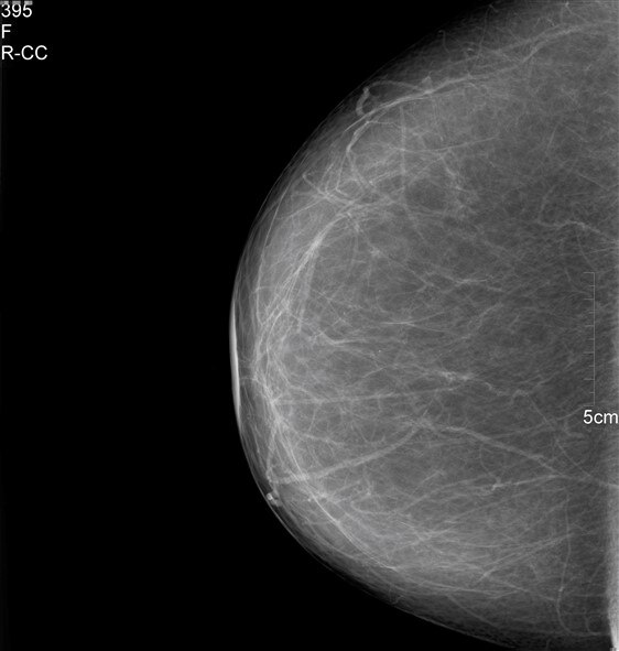

First test
The first test consists of the following steps:
  1. Connect to the internet using wifi
  2. Access the repository
  3. Download one image at a time from the folder containing the original images ( folder “test_files”), and see if it is a left or a right view
  4. Crop correspondingly the image to remove the text not needed in the image processing or the text that can include confidential data.
  5. Upload the resulting image to the repository in the folder for the cropped images (“test_cropped_files”)
The implementation of these steps implies using a library for accessing the repository using the samba server running on the RPi. For this purpose, I found the python SMBHandler Class which provides support for “smb://” URLs in the urllib2 python package.
For the cropping function, I have used OpenCV which is already installed in the Pynq environment.
One issue that must be solved is that the SMB Handler can be used to transfer files from the host to the Samba server while OpenCV functions work with images loaded from files. Therefore,  some additional steps are added.
- a connection to the repository is opened using "connect" function.
- a list of files is retrieved from the repository folder using "listPath"
- file names are extracted from the list one by one in a loop
- file name is searched for "_L" or "_R" substring indicating the left/right view
- a temporary file is created locally to receive the image file with the selected name downloaded from the server.
- the image is read from the temporary file using "imread" read function.
- downloaded image is displayed using "imshow" function.
- image is cropped
- the image is saved in a file locally using "imwrite" function
- file is uploaded into the repository using storeFile function
- the temporary files are closed and deleted to free space.
In Fig.5 below we can see the two images displayed side by side.
Fig. 5

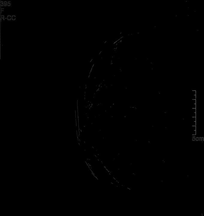

Second test
The second test was intended to get familiar with OpenCV libraries in Jupyter notebooks and also explore OpenCV acceleration on FPGAs through the use of overlays. The test started from the example “OpenCV Overlay: Filter2D and Dilate” in the PYNQ Computer Vision library.
For installing the Pynq Computer Vision library I have followed the instructions on Pynq Computer Vision page (https://github.com/Xilinx/PYNQ-ComputerVision/tree/master).
After installing Pynq Computer Vision library I started to modify the example mentioned above for running the following steps:
  4. Apply a filter implemented in software (such as Sobel x - other also tested such as Sobel y, Soble xy or Canny edge detection) and display the resulting image.
  5. Upload the resulting image to the repository in the folder for the filtered images (“test_sobelx_files”)
In Fig. 6 we can see the results of applying a Sobel xy and a Canny Edge detection filter.
image  image
Sobel xy                                                                                           Canny
Fig. 6
