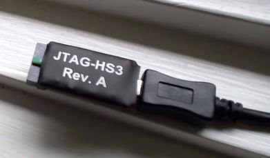

When debugging and updating AMD FPGA designs, usually you would need to have a JTAG cable attached. This can either be a Xilinx platform cable
or a compatible 3rd party tool such as the Digilent HSIII cable

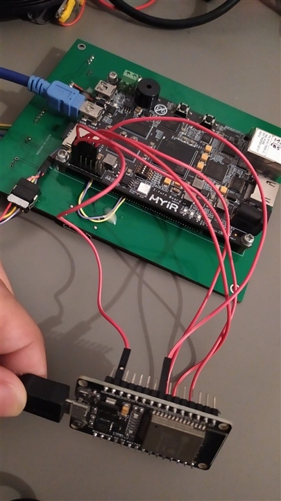

Since both the boards will get their own power, all I needed to do was connect GND, TMS, TCK, TDO, TDI (5 wires in total).
However, I got a bit confused with the TDI/TDO connections. Normally TDO is the "data out" while TDI is the "data In" for JTAG and I was wondering whether I need to do a cross-over connection, or if the signals in the XVC-ESP32 refer to the what pins they should be connected to on the FPGA side. I felt it was important to sort this out before making connections because the JTAG TDO signals are push-pull signals (actively driven) and not open drain, so connecting one side's output to the other side's output pin would not do well with our hardware.
Anyway, I looked at the code and saw that the TDI pin was set to output, while the TDO pin was set to input in the ESP32 code.
This confirmed that the TDI and TDO pins in XVC-ESP32 actually refer to the pins on FPGA JTAG that they will connect to. Once this was clear, I made the connections using 5 commonly available DuPont jumper wires.
image  image
Once this was done, I uploaded the XVC-ESP32 code to my ESP32 board, and then powered on both boards.
