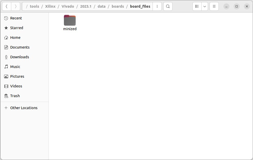

The next step is to add the downloaded board file to the board_files directory of the location: /tools/Xilinx/Vivado/2023.1/data/boards of my Ubuntu PC. I did not find any directory named board_files in that location. So, I created the same directory in that specific location using the following command:
mkdir /tools/Xilinx/Vivado/2023.1/data/board/board_files
Then I gave all the permission to that directory so that I can copy other contents in that directory.
sudo chmod -R 777 /tools/Xilinx/Vivado/2023.1/data/board/board_files
Finally, I copied the minized directory that I downloaded previously from Avnet GitHub and paste it to the newly created board_files directory.
After following all the steps I was able to see the MiniZed board in the board list (see the screenshot below).

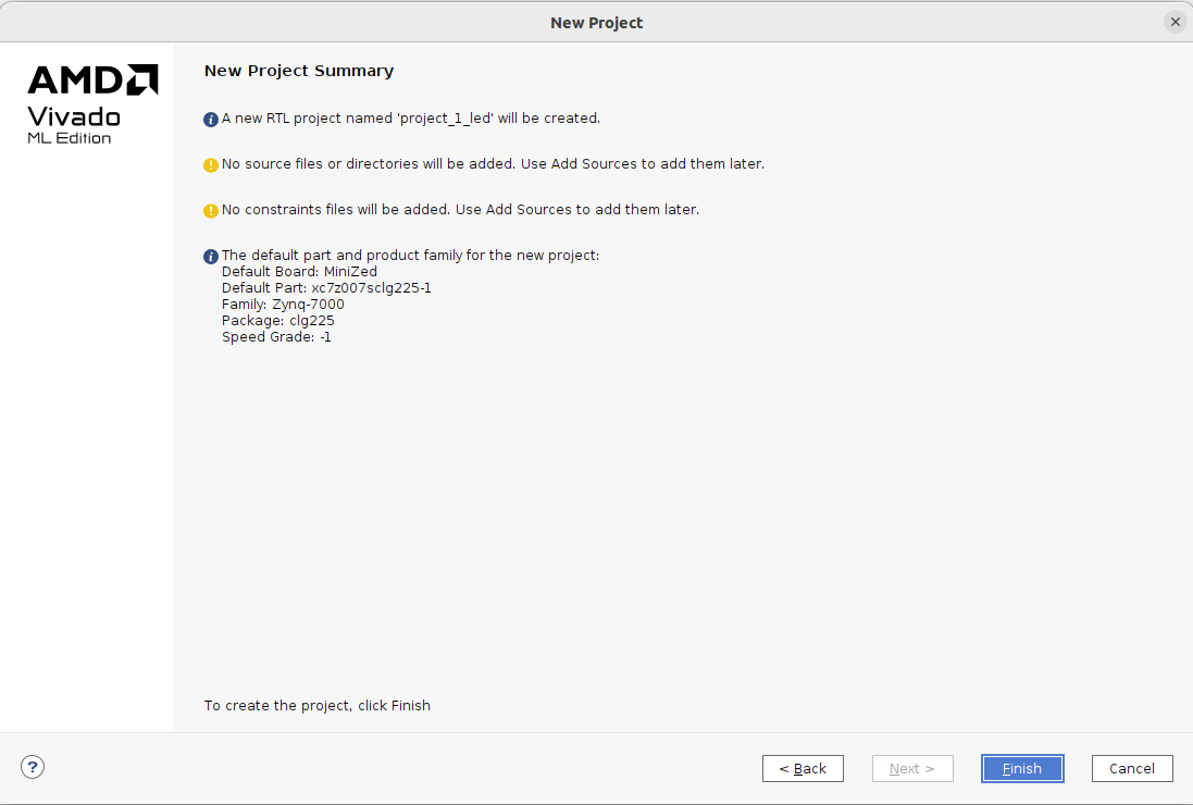

Finally, I created the project for the MiniZed board and the project summary is as follows. At this moment I did not add or create any source file. I will do so after opening the project.

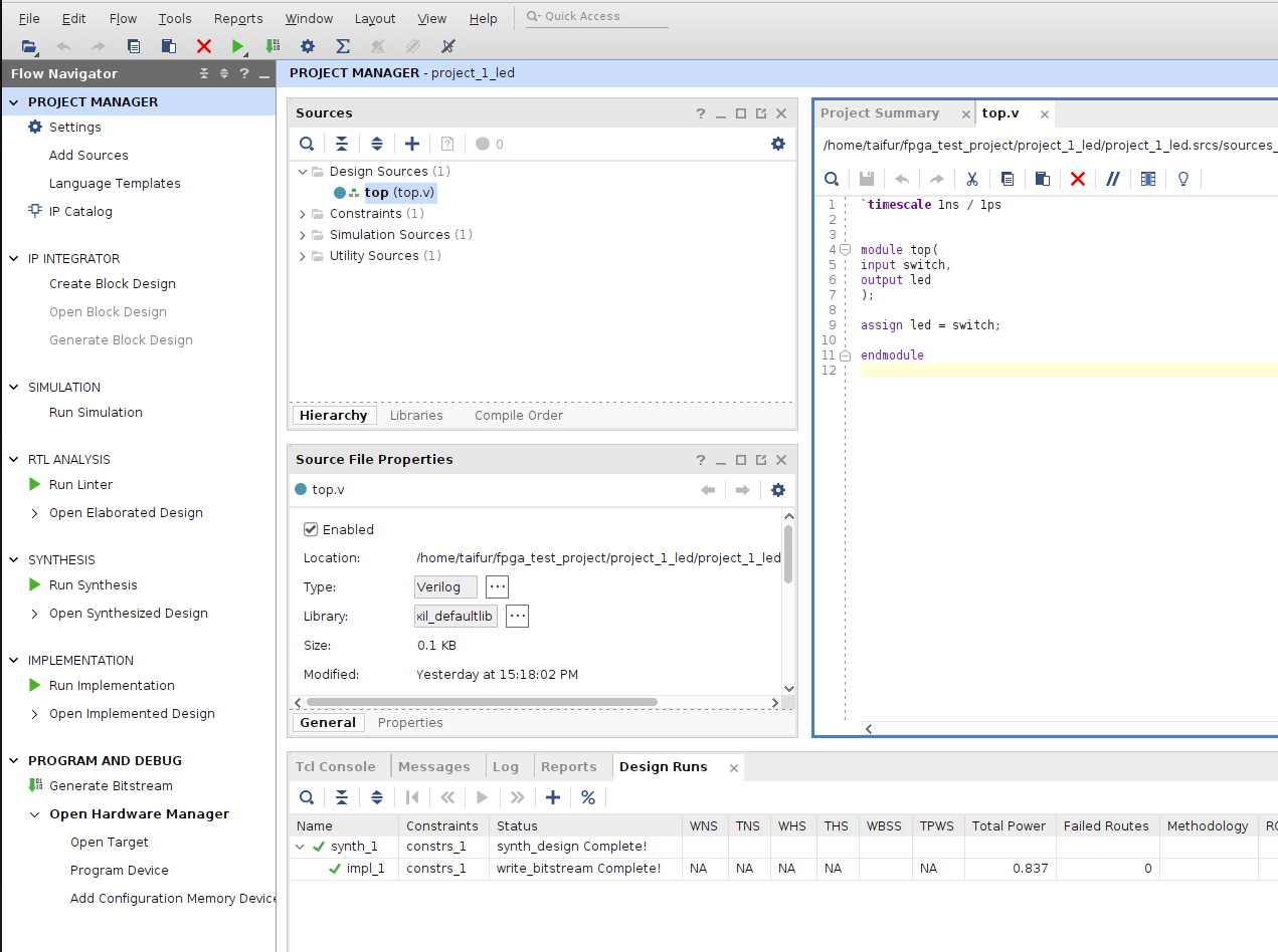

The project is automatically open and I created a Verilog source file from the project manager. The code for my project is very simple and as follows:
'timescale lns / lps
module top(
input switch,
output led
assign led = switch;
endmodule
Then I created a constraint file and add the following lines to the file:

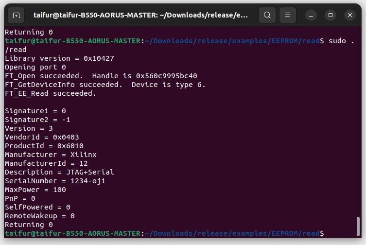

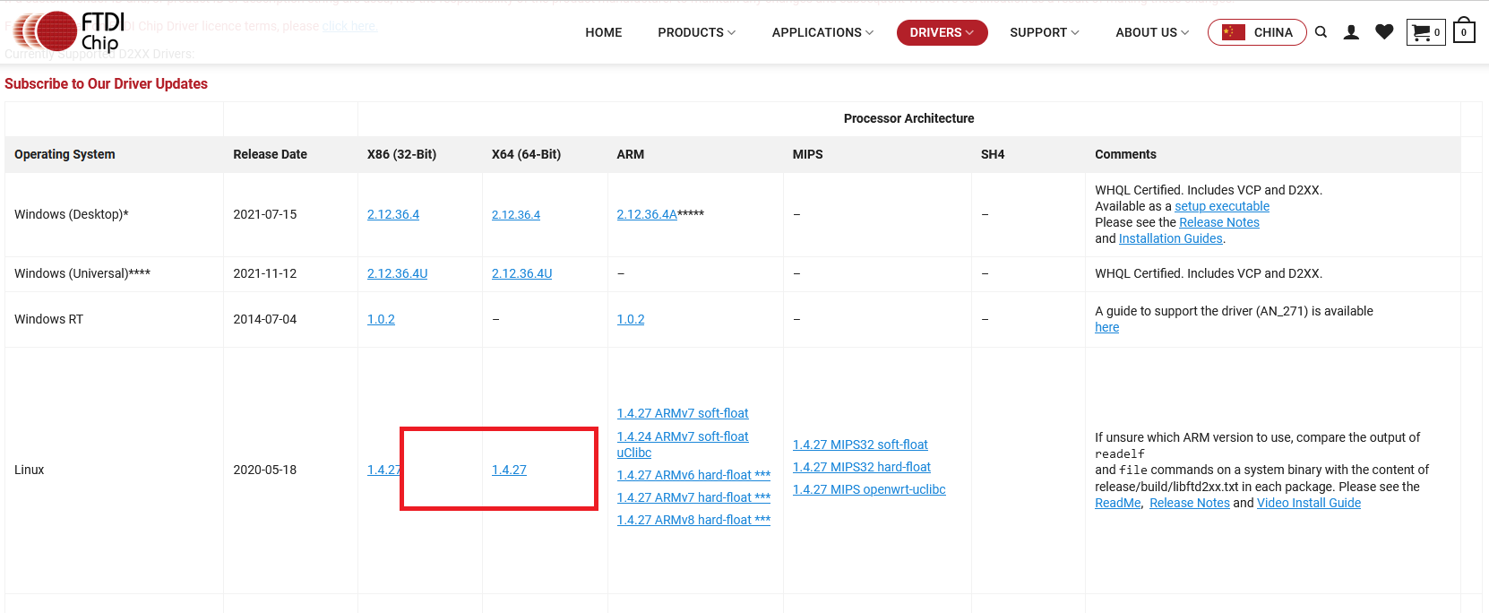

I connected the MiniZed board to my Ubunty PC but the target board was not detected by the Vivado Hardware Manager. I suspected that can happen for the missing or wrong driver. From the MiniZed getting started guide I confirmed that the FTDI FT2232H device driver must be installed successfully.
So, for downloading the driver I opened the link https://ftdichip.com/drivers/d2xx-drivers/ and downloaded the driver for Linux 64-Bit distribution.
I was able to successfully install the driver with the help of the following video.

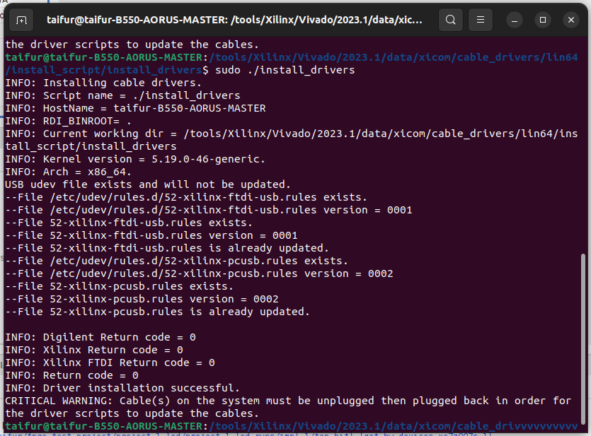

Though after installing the driver the Xilinx board was visible in the terminal, still I the Hardware Manager of the Vivado did not recognize the connected board.
Again I started googling the solution and I found a hint about installing the cable driver from a Xilinx-specific folder. I went to that location and installed all drivers provided by Xilinx using the following command:
sudo ./install_drivers
The following image shows the installation of the drivers.
I was in luck and the Hardware Manager found the board immediately after running the above command for driver installation.
