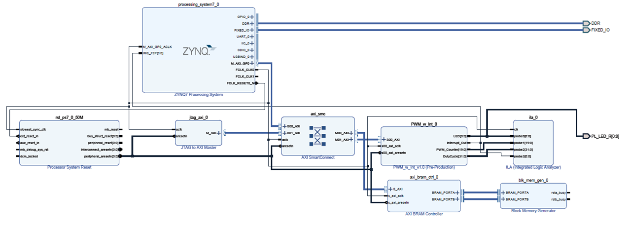

Lab7_Viv_Block_Design
Fig 3. Lab 7 Vivado Project Block Design View
