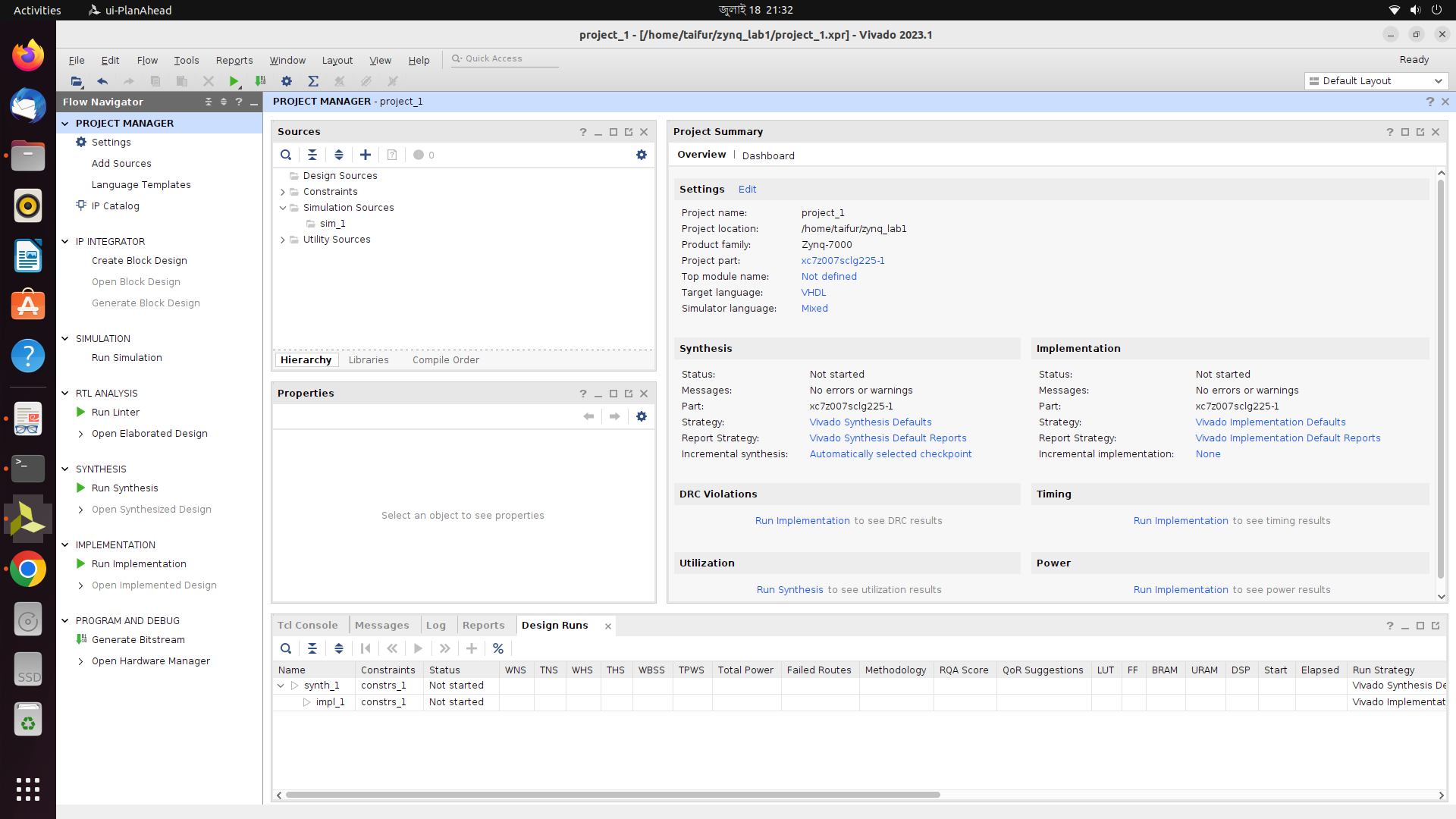

Hardware design in Vivado
This is my hello world project using Zynq. I completed this by following hardware lab 1 and 2. The first part of the project is the hardware design in Vivado. I have created a new Vivado project for Zynq-7000 SoC.
Then I added the Zynq processing system IP block. Vivado will detect that the Zynq PS block has been added and a green banner will appear across the top of the block design window with the option to run Block Automation. Block Automation will apply the MiniZed specific board presets to the Zynq IP block such as enabling the utilized peripherals such as UART, SPI, etc.
A block design needs an HDL wrapper to instantiate it in the logic of the FPGA. It can be created manually or can be auto-generated. I used the auto-managed HDL wrapper for my project as per the recommendation of the lab manual.
After making all the configurations as per the instruction in the lab manual I run the synthesis, followed by run implementation, and then generate a bitstream. The implemented design looks like below.

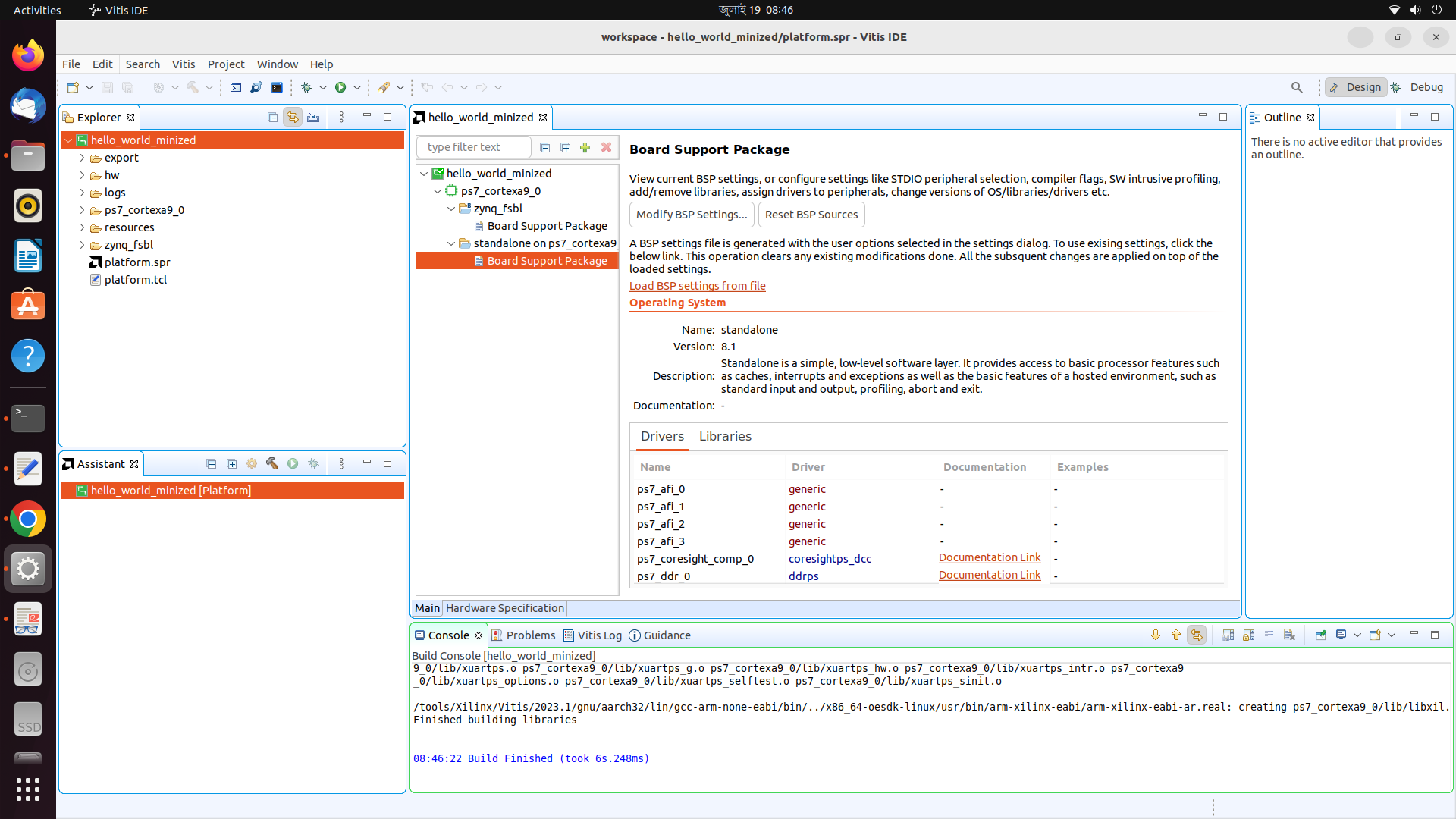

Software design in Vitis
After completing the hardware design the next step is the software design in Vitis. Vitis can be launched directly from Vivado, the option is located in the Tools menu under 'Launch Vitis'. But when I opened it directly from Vivado both were closed automatically in my case. So, I run the Vitis independently from the terminal and it works.
In a new Vitis project, the first thing that needs to be created is the base platform project. The platform project is what pulls in the hardware design and creates the corresponding board support project (BSP) for the software to run on.
After opening the platform project in Vitis:
For this project, I selected the Hello World application:

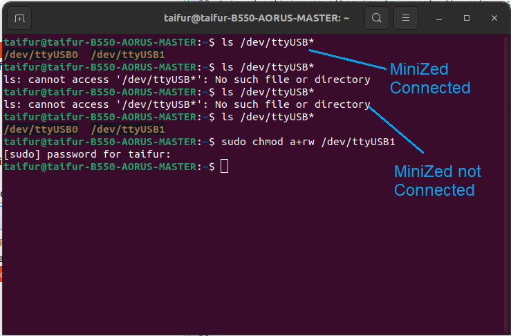

For observing the output in my Ubuntu machine I installed GTKterm. After attaching the MiniZed board with the PC I checked the attached device using the  ls /dev/ttyUSB* command. I got the following response. I add the read/write permission to the port using the chmod command.
After launching the debug run I got the following output on the GTKterm terminal. That indicates I did perform all the steps perfectly and the program run successfully.
