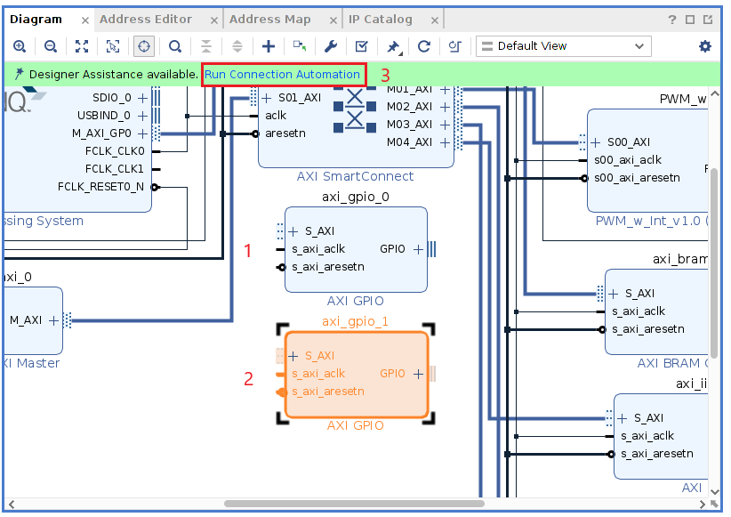

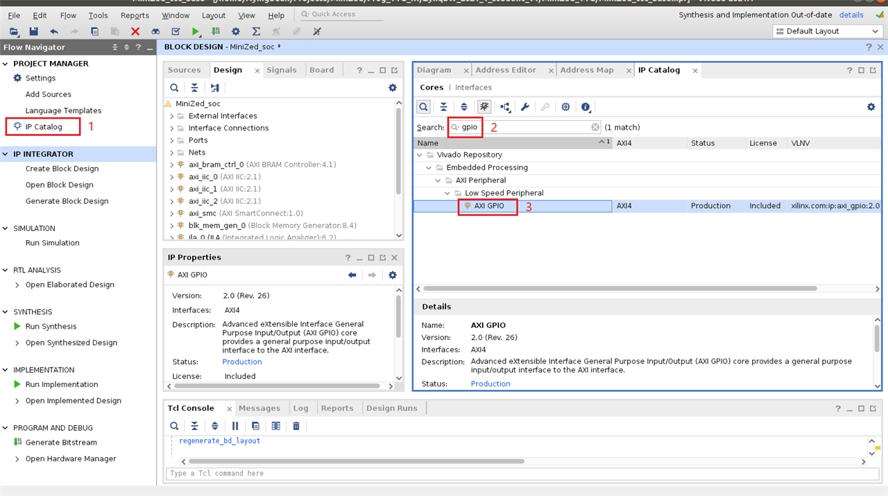

 1.1 Adding AXI IIC IPs
1.2 Add GPIO IPs
{gallery}Add AXI GPIO IPs
Select GPIO IP
Add AXI GPIO IPs into BD Canvas
Auto Connection of AXI GPIO IPs

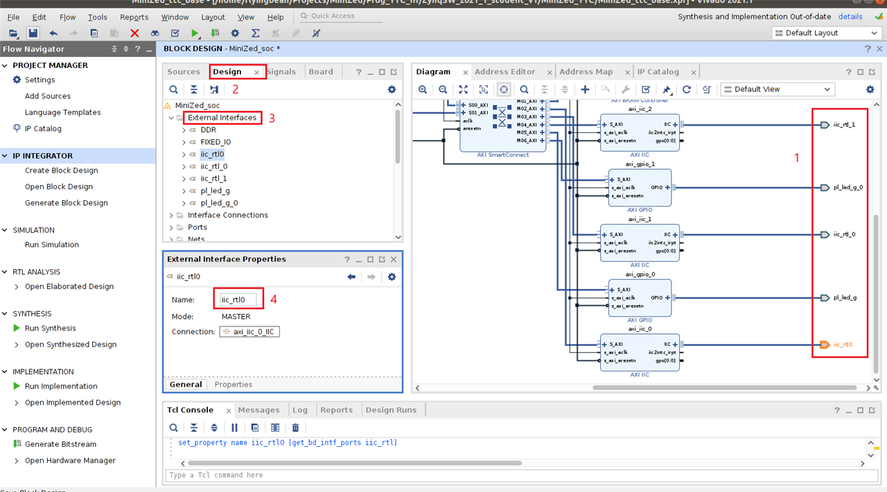

Tips:
Updating external pin names from BD->Design->External Interface Properties as below. It is easy and reliable way to update pin naming under Vivado project flow.

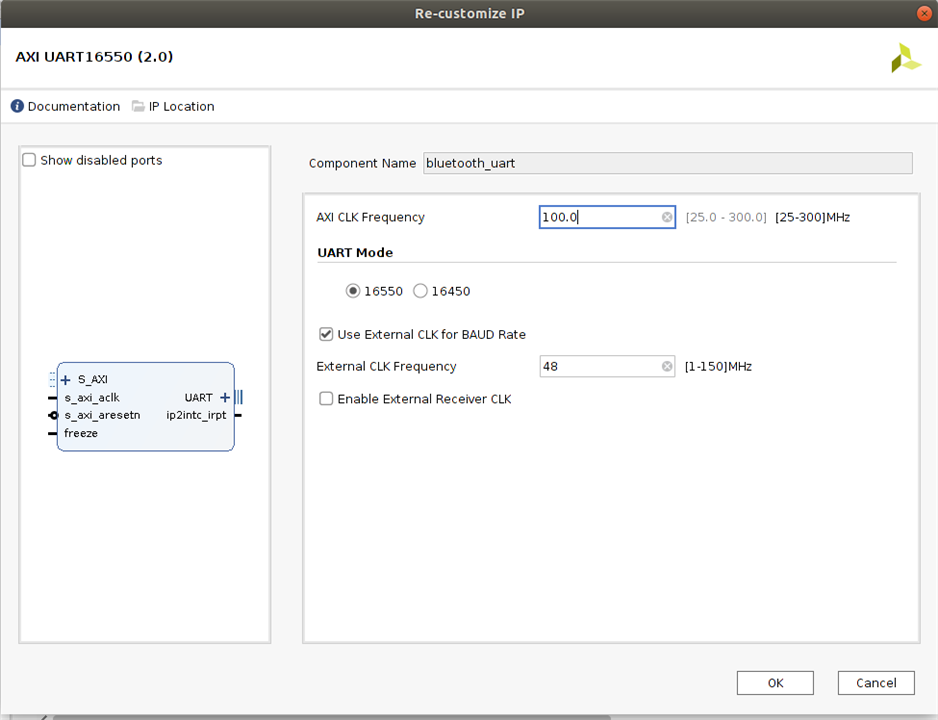

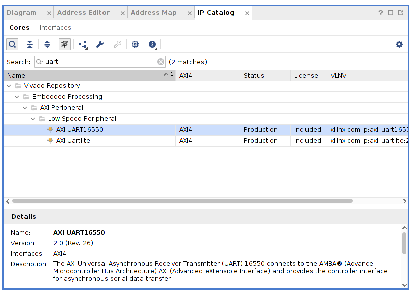

1.3 Add Bluetooth UART IPs
{gallery}Add Bluetooth UART IP
Search AXI UART16550 IP
Configure Bluetooth UART IP

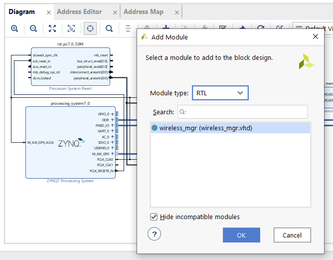

2.Add User VHDL File into Block Design
 We need to add wireless_mgr_0.vhd file into BD canvas as this styel. How can we do it at Vivado GUI tool chain?

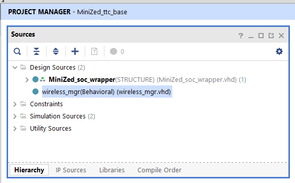

Step 1: Add wireless_mgr.vhd into Vivado project from Project Manager -> Add Sources -> AddFiles
Step 2: Select the VHDL source code. Please don't copy the source into Vivado project.
Project Manager add wireless_mgr.vhd into Vivado project, which is able to be loaded by Vivado Add Module pop-up window at Step 3.
Step 3: Back to Diagram (BD canvas), click the right mouse button under Diagram area. A pop-up window will let us Add Module

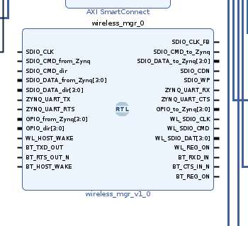

Step 4: After finish click OK at step 3, Vivado will automatically add wireless_mgr_v1_0 block into Diagram.
3. Add Vivado glue logic and reconfig Zynq block as needed. Last, assign Address at Address Editor. Here is the final Lab 9 build from scratch.
