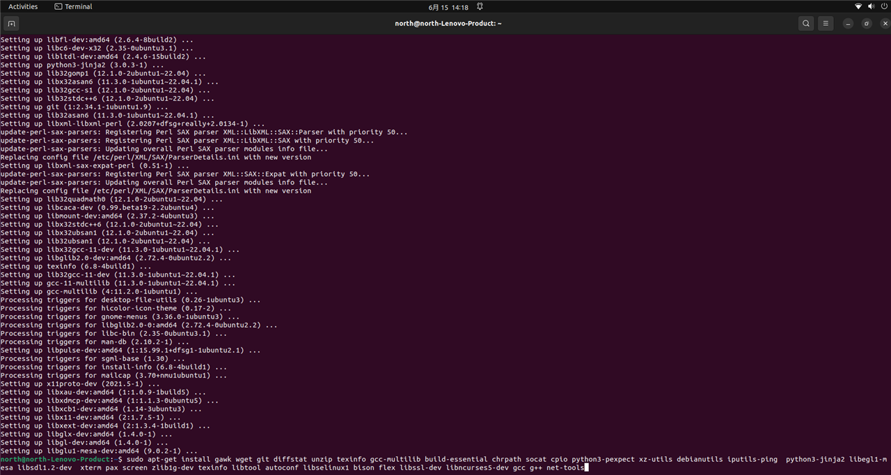

3.2.1 Prepare prerequisite packages,
First, run
apt update
apt upgrade

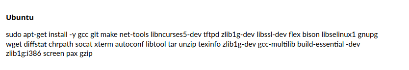

Install the following packages first, before petalinx check it
Some package need x32 lib, so include i386 architecture

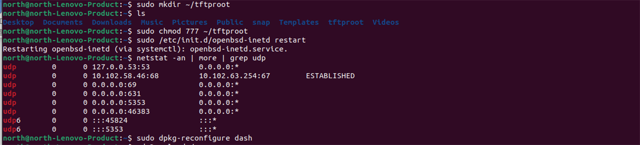

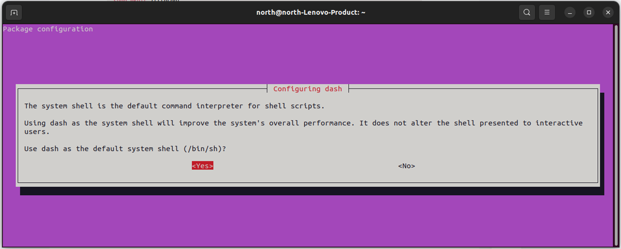

configure dash instead of bash
install tftp and configure the tftp server

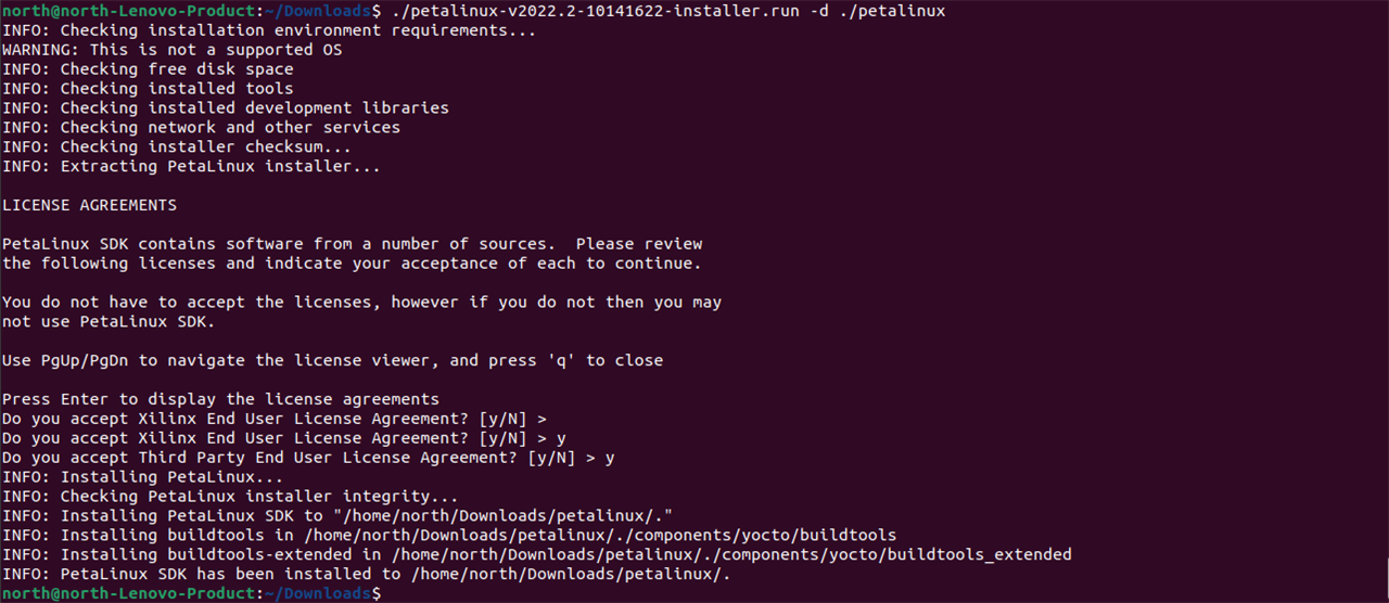

3.2.2 Now, start install with script,

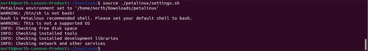

3.2.3 Now, test the petalinux with setting.sh
and try create new petalinux project,
Now, it is OK.
