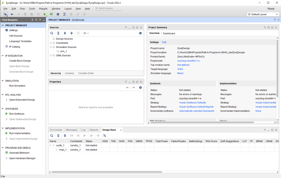

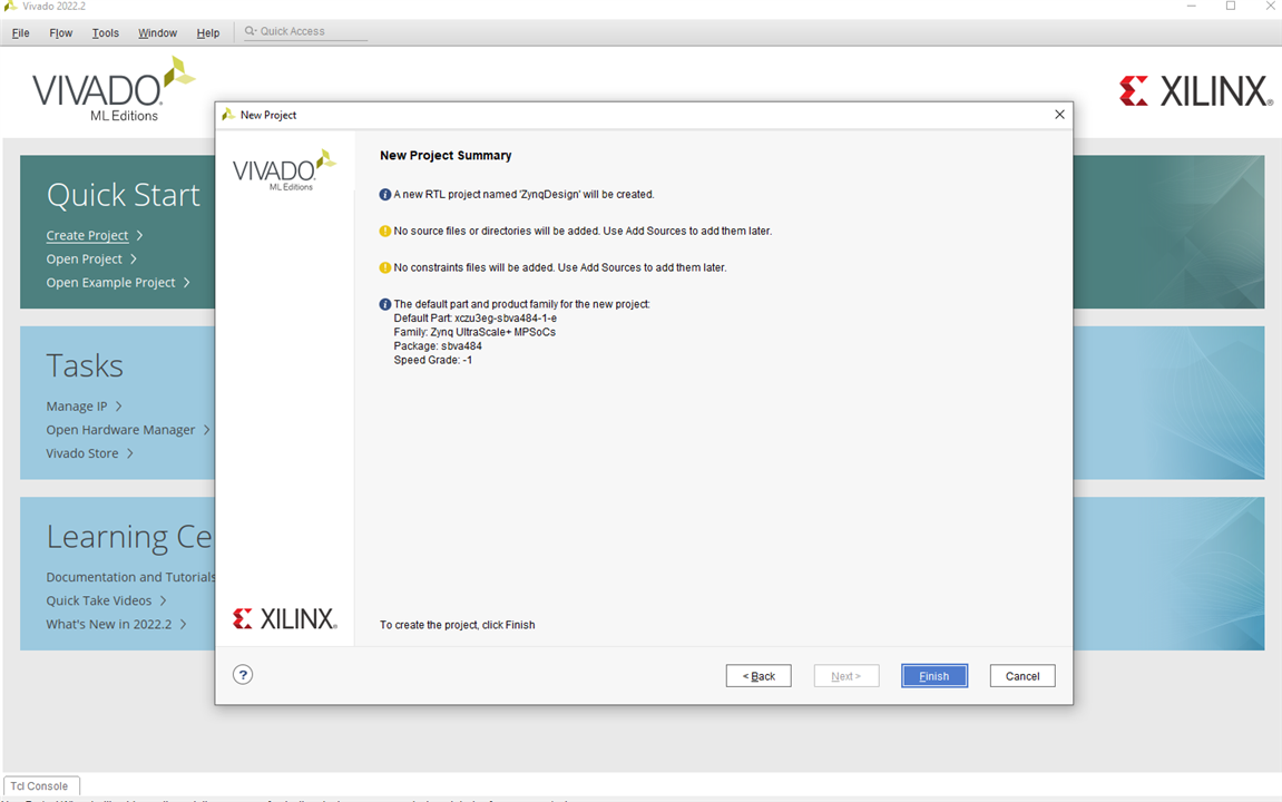

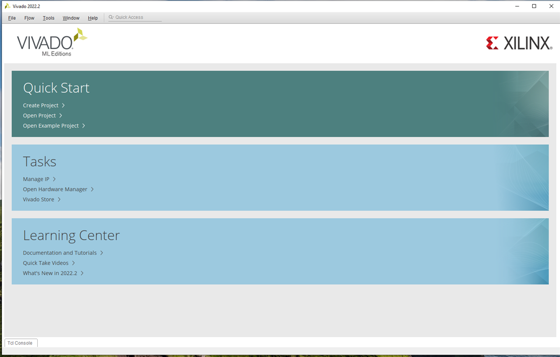

Start Vivado,

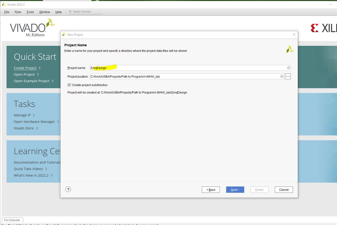

Create new project, ZynqDesign

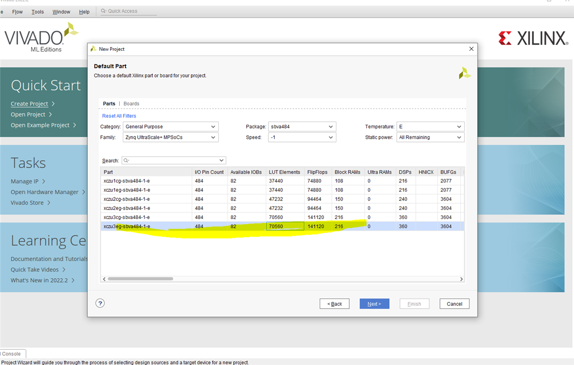

Select part number of chip
Make selections step by step, resources and constrain part can be added later, so leave them blank for now,

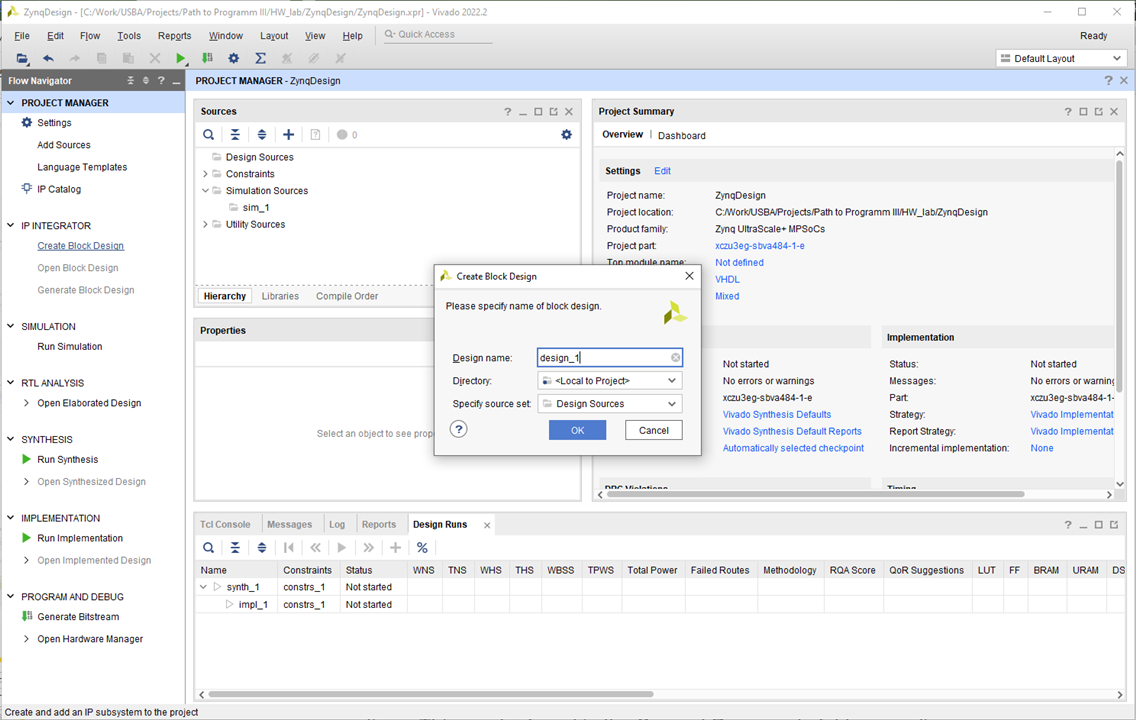

3 Create block design

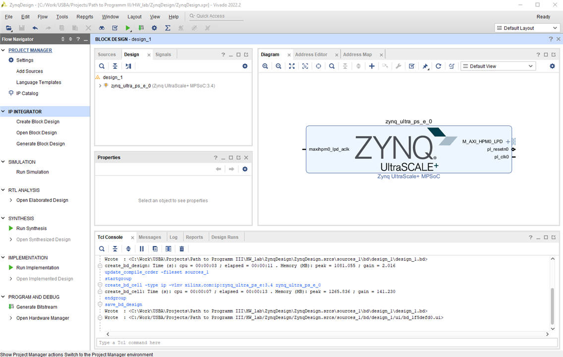

Create the block design in GUI mode with Zyng MPSoC IP

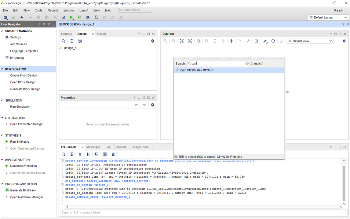

add Zyng MPSoC IP

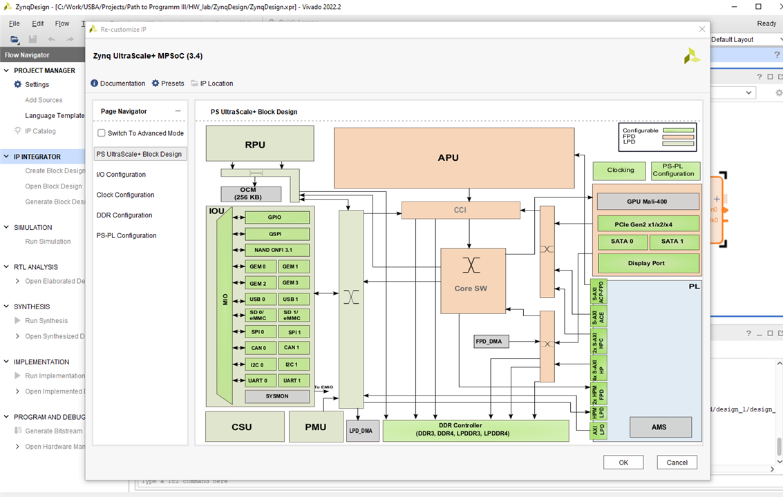

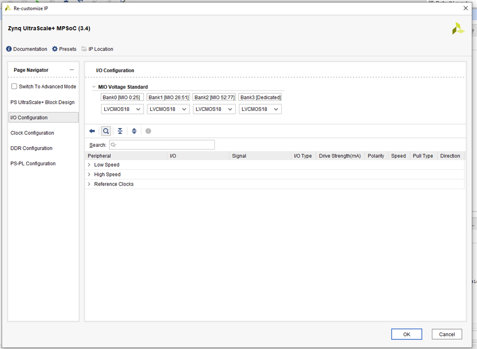

Here it is, double click the IP to edit parameters
The block diagram clearly shows  Each part within the IP core,
select block to edit

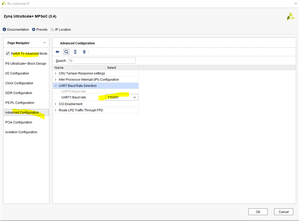

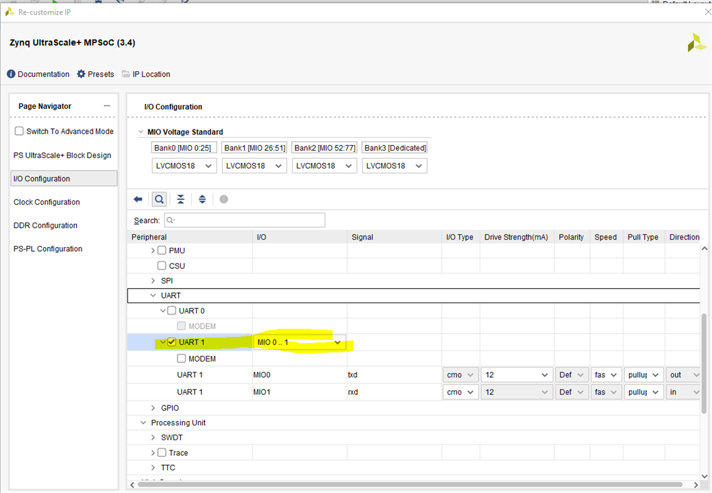

tick the UART0, and choice parameters
set the baud rate 115200,

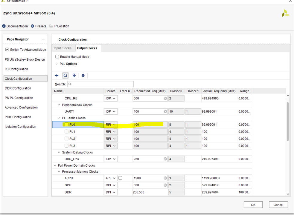

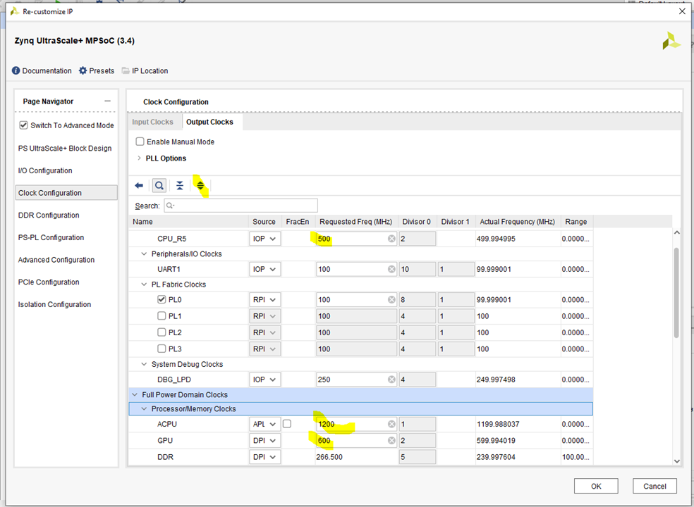

fix the core frequencies

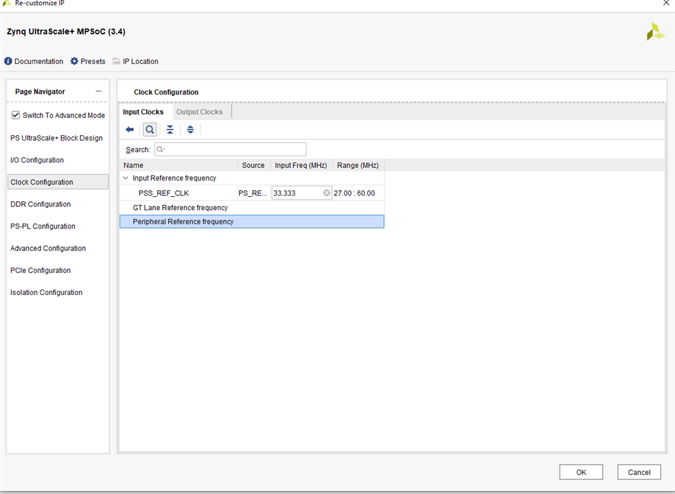

then the peripheral clock
configurate PL clock,

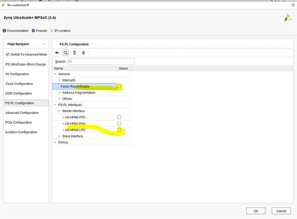

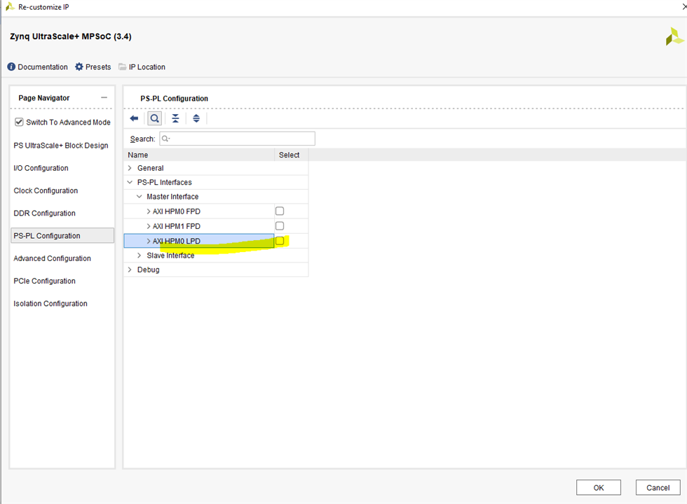

then go to internal bus IP configuration, that is about AXI,

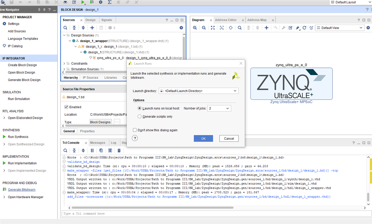

4 Build the Design

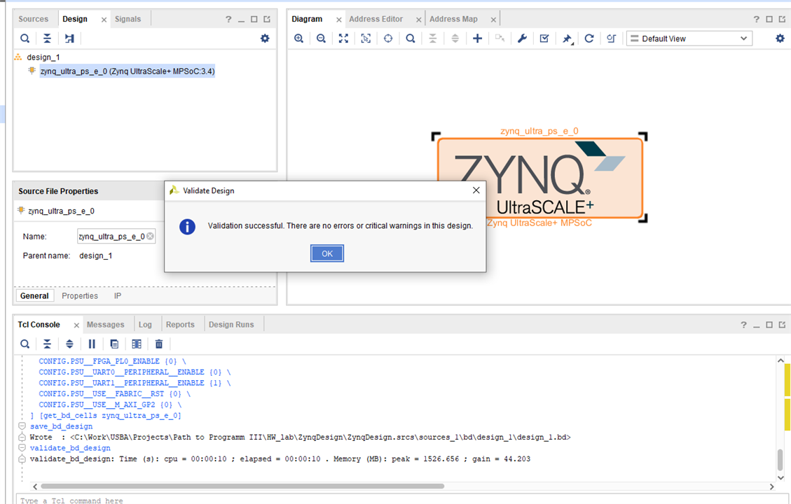

Validate the design first,
if there is any problem, error is reported.

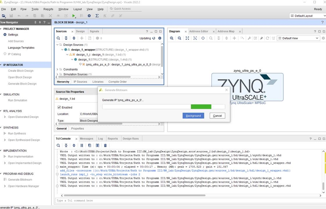

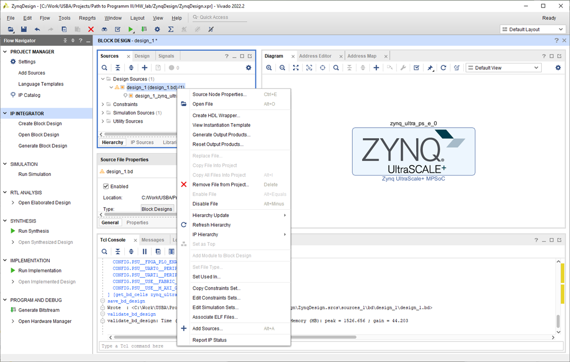

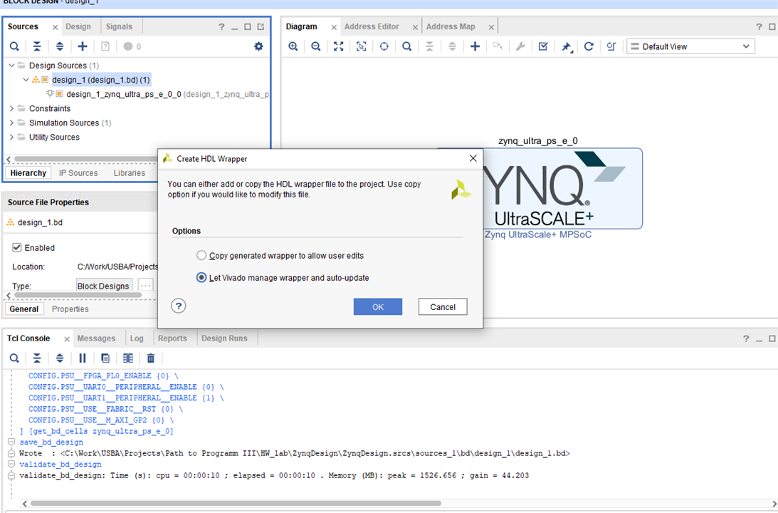

Then generate bitstream. In fact, it is bundle command, create HDL wrapper first,
Create HDL wrapper,
Then the wrapper is attached with the design files,

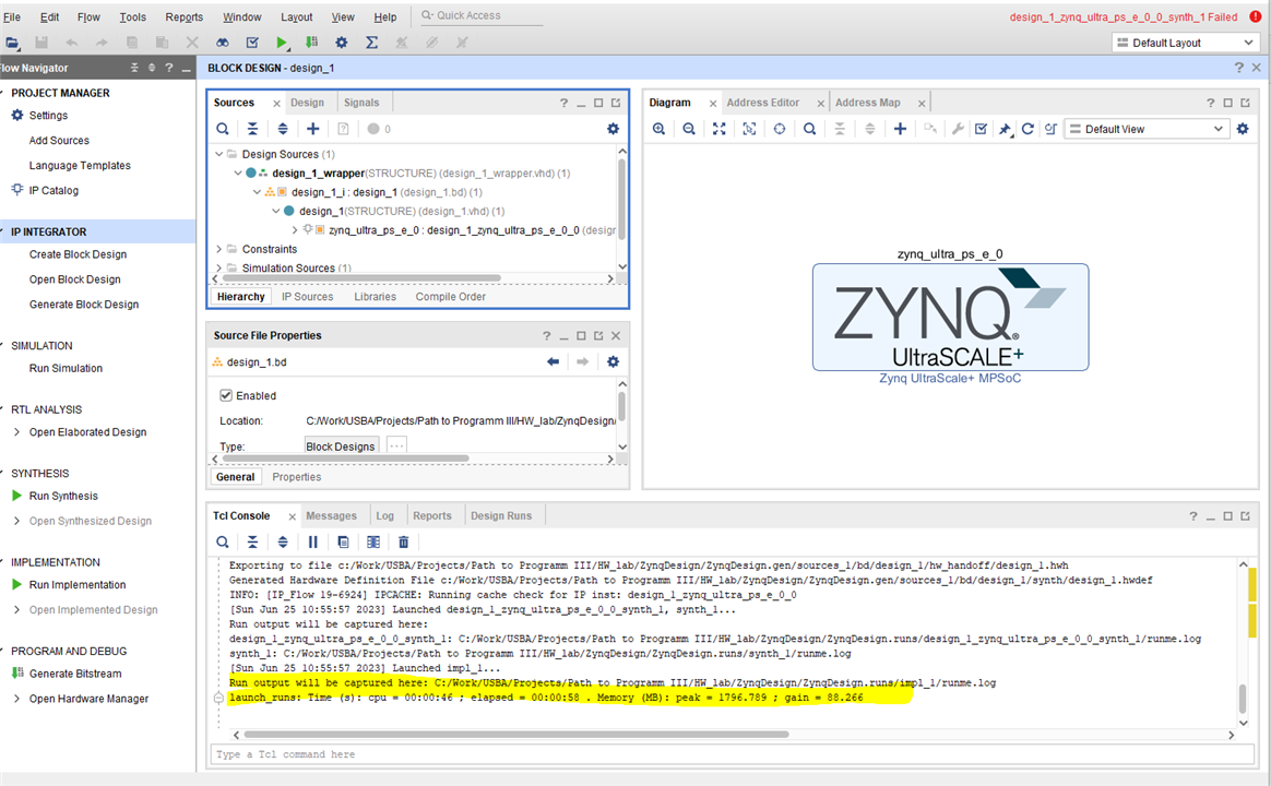

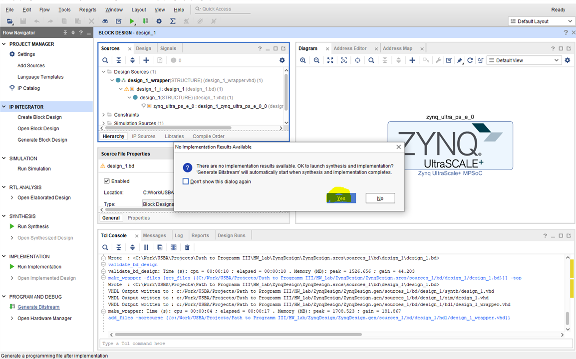

Start implementation,
launch synthesis
Generate bitstream,
It takes fairly some time until there is output with all process logged in .log files.
