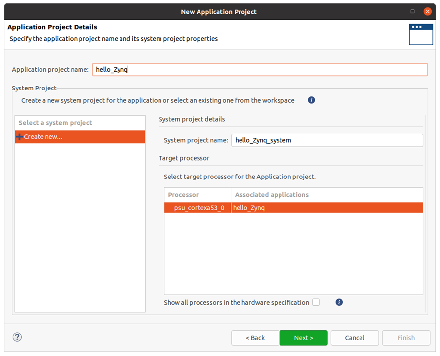

4 Create application
Now, create new projects
type project name
select bsp and wait for template to be loaded,
import empty template for now, there are FSBL template as well for fast booting bin file generation for SD card,
Press finish and the new application is created.

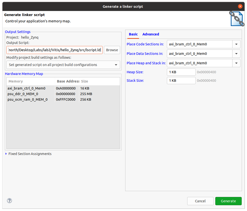

the link script can be modified in GUI
or source format,
the link script can be re-generated after revise.

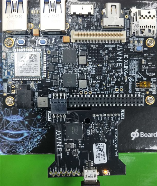

5 Program the hardware
connect the debug port and usb cable
the usb device can be found as FTDI devices,
then program the device with the project
This is how the software can be designed and programmed. The lab session provide full instruction and source code in each lab.
