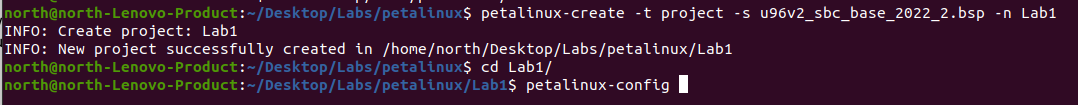

2 Create Petalinux Project
Create petalinux project for petalinux-create command,
petalinux-create -t project -s u96v2_sbc_base_2021_2.bsp -n Lab1

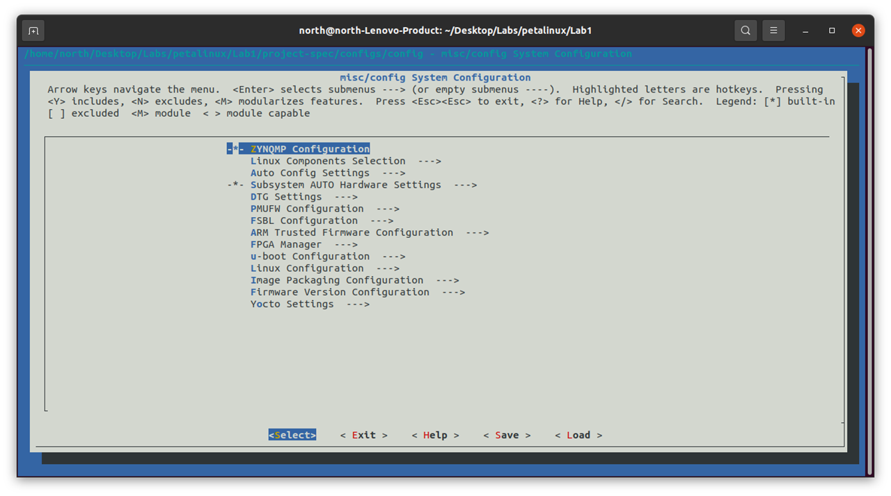

change directory and the config the project with petalinux-config,
after a while the text format  GUI  appears, first line is ZYNQMP core configuration,
press enter and go into submenu,
go further the SD card settings

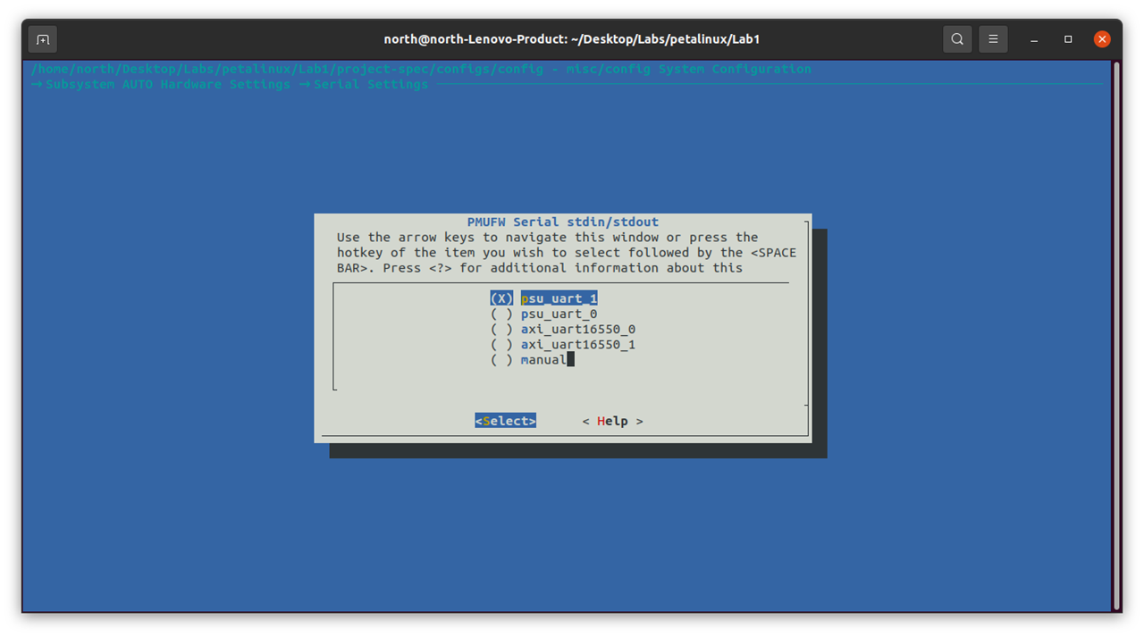

choose psu_sd_0, this part links with hardware design,
go back to config UART setting,
use psu_uart_1

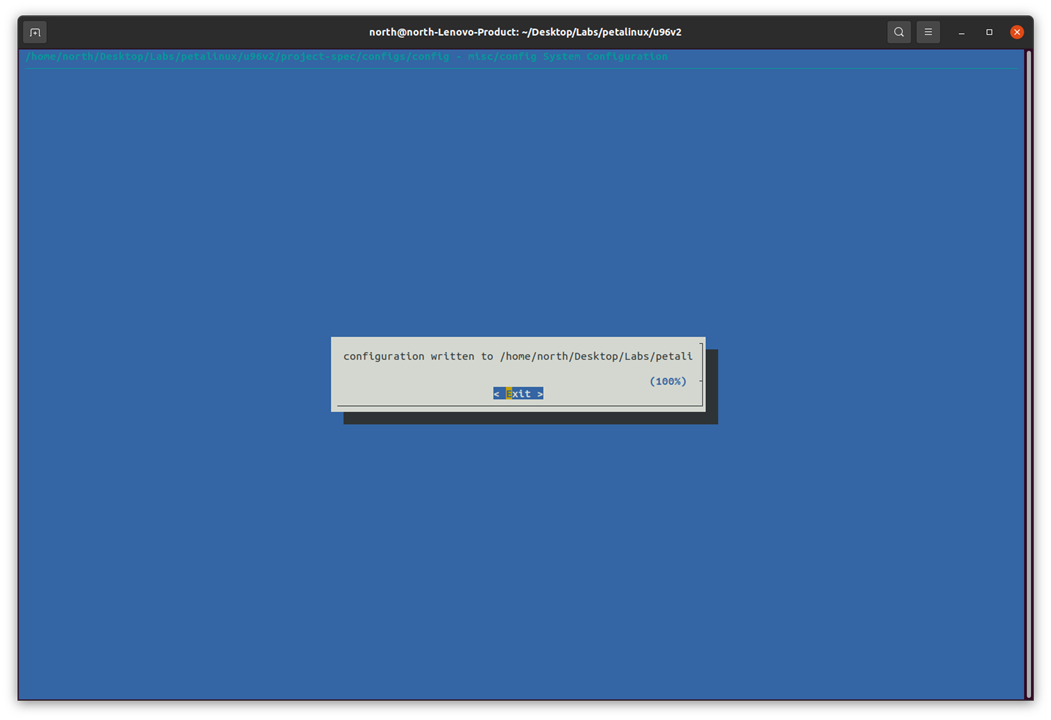

press escape and exit the configuration,save the configuration file,
the configuration is OK. This is standard yocto configuration with customized Zynqmp core.

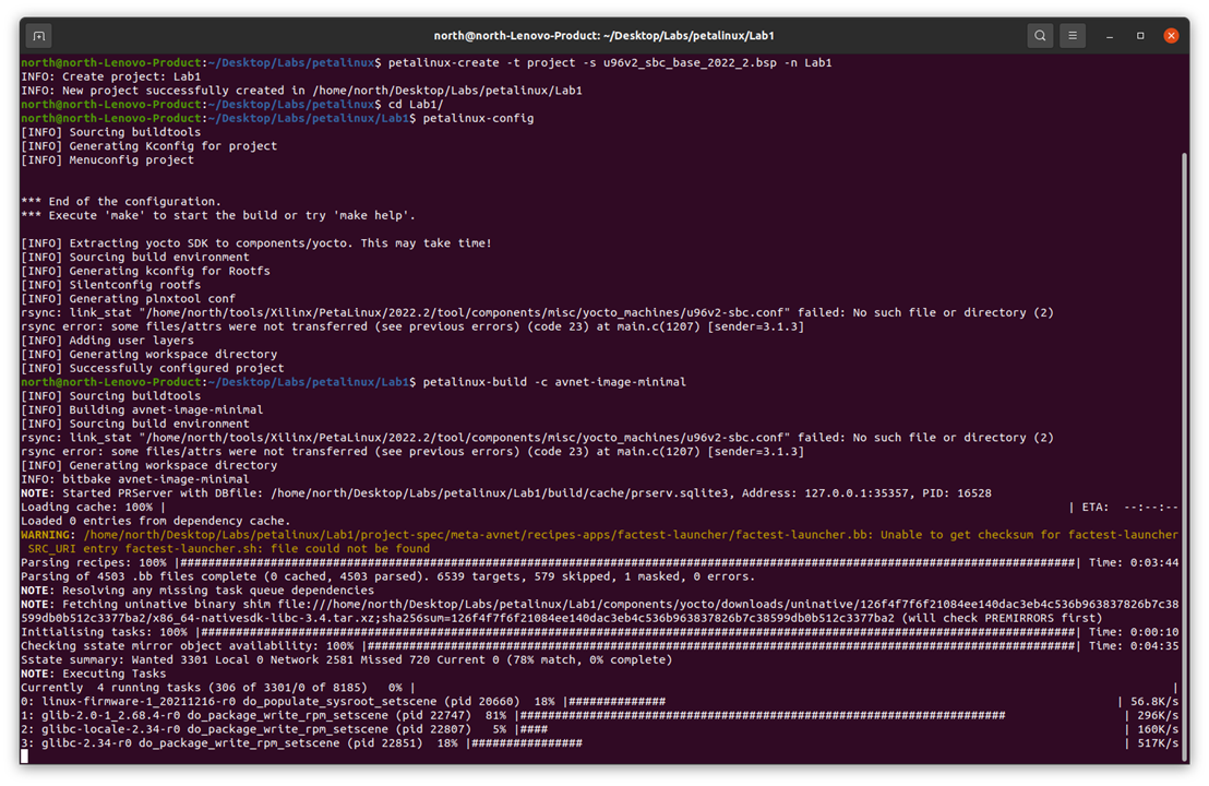

3 Build Petalinux Project
Build the project with petalinux-build,
petalinux-build -c avnet-image-minimal
most of the sdk file shall be download from github or third part web, it the link lost, build ceased with error,
if successful, the file needed for boot image is ready to included in images/linux.
cd images/linux
There are always web link lost in build process, so far is the lab training process.
There are solutions, download cache files from AMD xilinx website and redirect the mirror link, but that is 60G, take a while.
